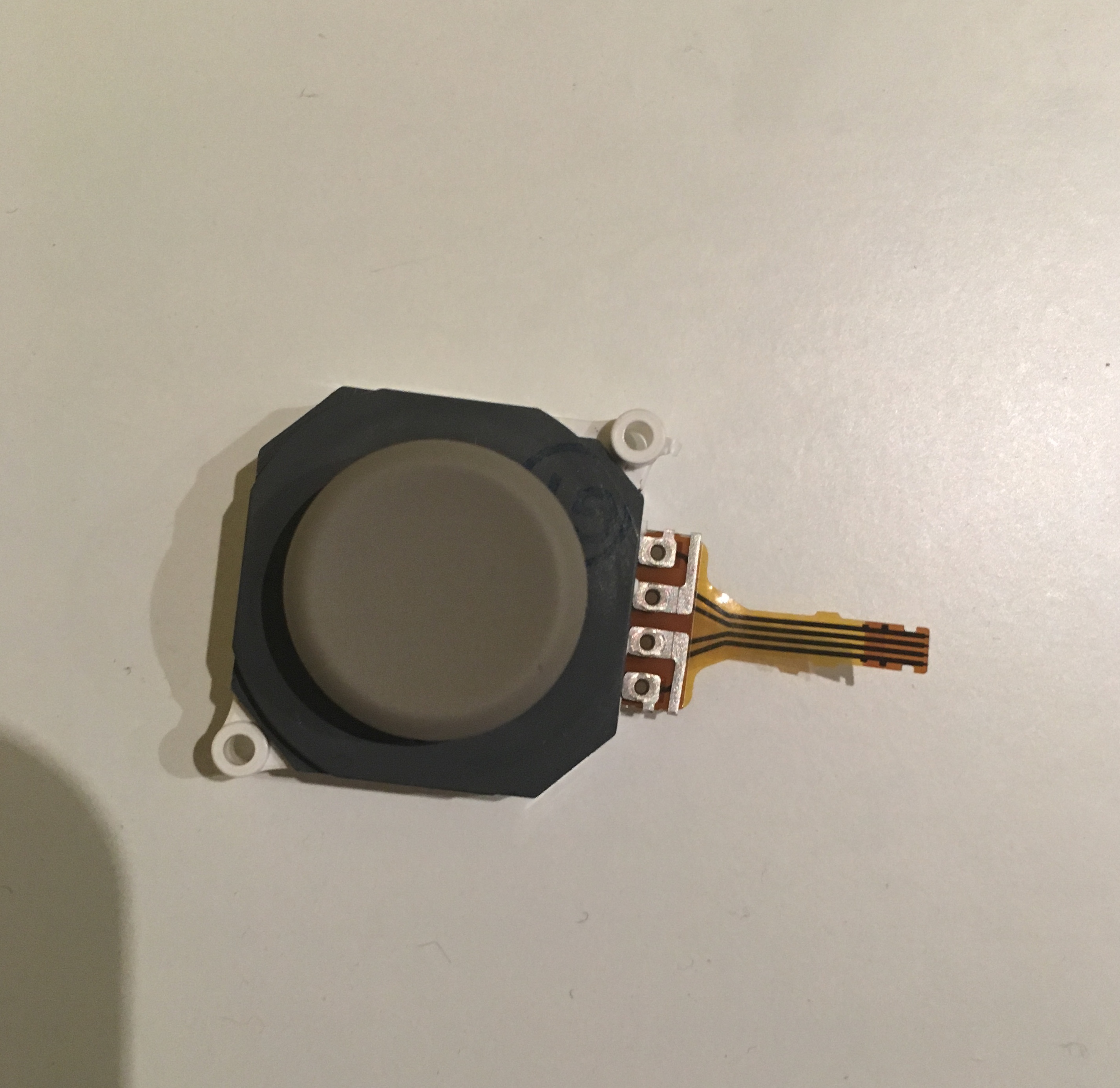

Unfortunately it seems that I got a slightly different version of the Joystick... I have snapped of the white plastic that was covering the ribbon, but instead of a black square I got what I think are the solder points? (You can see it on the Image below that I attached)
Am I right and are those the solder points?, will it be possible to cut the ribbon since I am not going to connect anything with them or should I leave it?

No, the black plastic is on the white tab you snapped off.
You should be able to desolder the ribbon cable, then you can solder your wires to the bare PCB. Just heat your iron up, place it across the pads (you may need to work the iron back and forth to heat them all) and gently pull up on the ribbon; when the solder gets hot enough to melt, you'll be able to (again, gently) peel away the ribbon.
