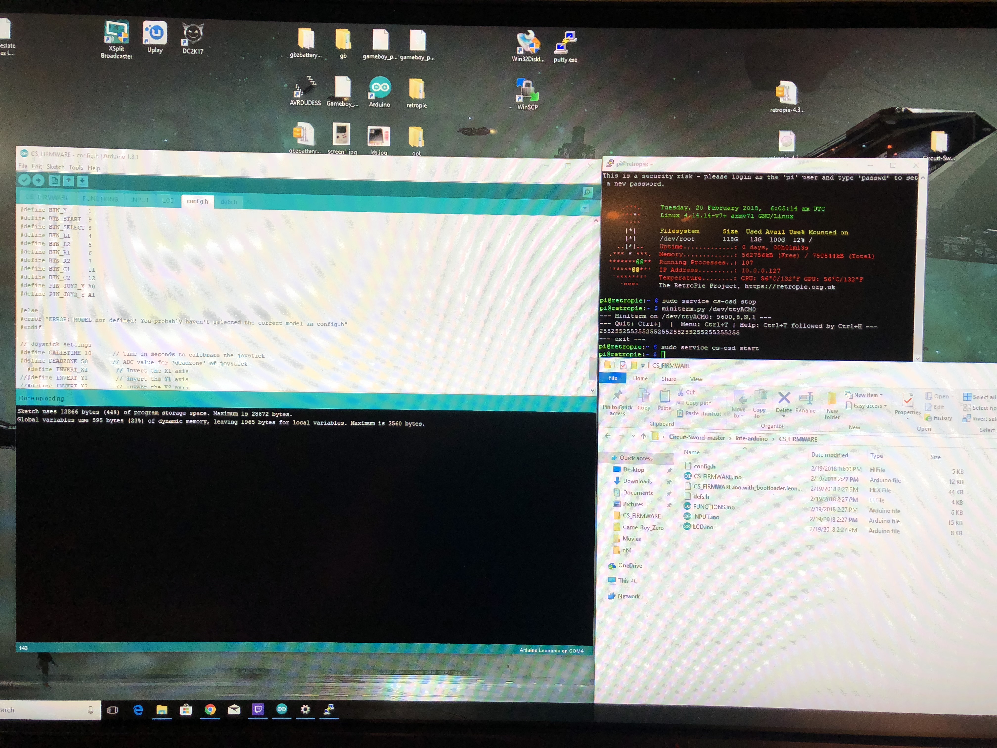

Re: CSO - Mode button for volume not working
Kite,
I have done the update.sh via ssh and rebooted multiple times. I have also updated the Audrino code from what's currently in your repository. I know the update worked, because I fixed my inverted joystick while I was in there and that worked just fine.
Outcome for volume is still the same. The problem persists. Still getting 255 also when it takes the Audrino reading.
Great job, thanks for this it's really helping understand what the issue is! I have added a new comment to the issue https://github.com/kiteretro/Circuit-Sw ... -366892950 can you please try those steps in my latest comment at the bottom? Basically refresh your code and upload again, then calibrate joystick (even if you have no joystick, this step is important)
EDIT: Issue is now fixed. Follow the link to the issue in github and follow the steps at the end of the posts
