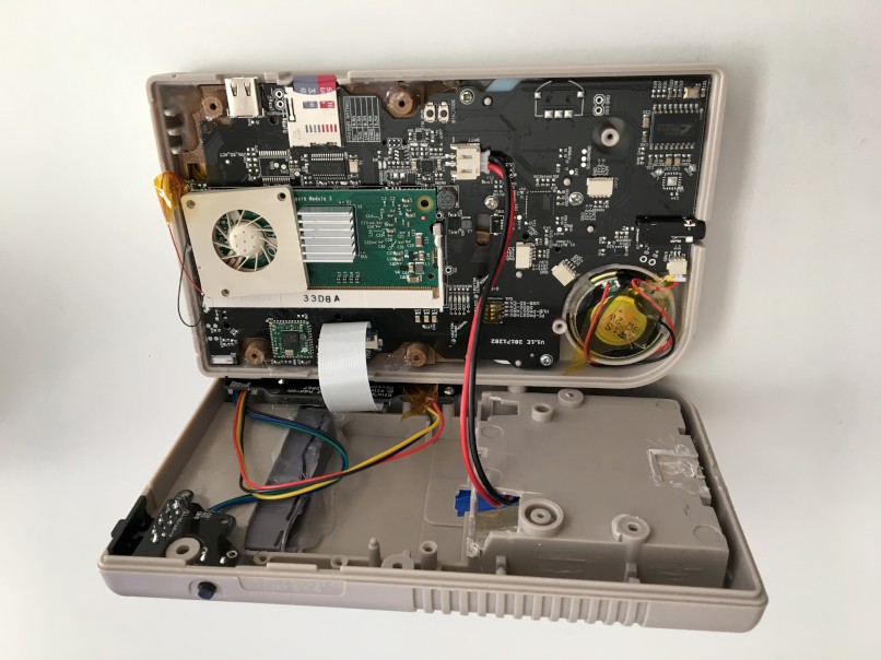

Ok, I finished my build (too busy playing to post in the build show-off corner) and I've solved my power switch mounting issue.
tl;dr: Just order HoolyHoo's part...
Below is how I mounted the switch securely for the more stubborn people like me who take too long to build things.
I modified a game link port cover that came in my case kit:
The notched part slides under the power switch. (sorry for my poor phone macro photos)
After epoxy was used which holds the switch very firmly in place:
I also trimmed the power/mode PCB a bit as the tab with "PWRSW" silkscreened on it was a bit too long preventing my mode switch from sitting flush inside the case. I suspect that had the proper mode switch part been installed that Kite specified for this board, it would not have been an issue. I only trimmed <1mm from the end and I suspect it's unnecessary for almost everyone. I'm just trying too hard to make it perfect... :roll:
The mode button switch didn't get centered, but at least it works great and the epoxy on the switch sides isn't too noticeable...
Overall, the back side came out pretty clean when everything was epoxied and secured down.
Thank you everyone for the advice and help! :D
