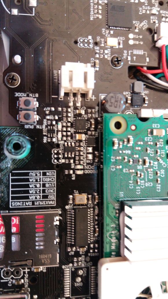

Hope this picture works for you, I cannot see anything fried.
ShowShow
EDIT: the small blue led next to the red led (near the charging curcuit, that lights up once power is connected) blinks quickly when adding the battery

Yep all normal, I'm afraid I'm going to need to see it and most likely replace the charging IC! :( could you send me an email and we'll go from there
