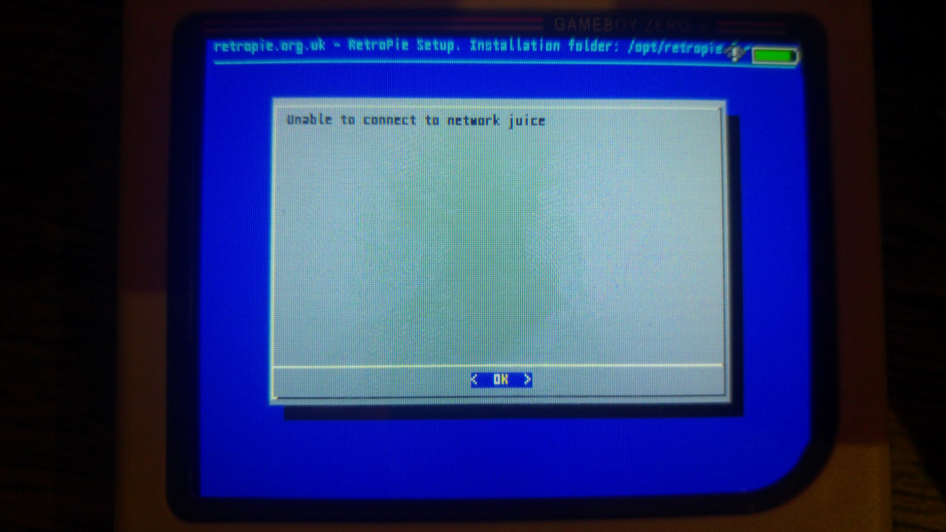

jwoof
Joined: Sun Nov 05, 2017 8:33 pm
Re: Circuit Sword - wifi only connecting to unsecured
Post by jwoof » Fri Feb 23, 2018 4:09 pm
I have you tried turning it off and on again ?
:D :D
I turned everything back on to try it out and it was connected to the phone network, when I was testing I set the password to 12345678.
It seems a bit random, it will show that error, but than on reboot it seems to auto connect.
The caps-lock key functions, but the light doesn't come on with the keyboard I am using.
2018-02-23 22.21.31 (Large).jpg (423.35 KiB) Viewed 5313 times

Re: [Solved] Circuit Sword - wifi only connecting to unsecured
Post by sygyzy » Fri Feb 23, 2018 5:26 pm
The easiest way to resolve this, because I can pretty much guarantee the password you are entering in the UI is incorrect, is to use the wpa_supplicant.conf file in /boot.
Eject your microSD card, plug it into a reader and to your computer and create the file with the right credentials. Out of the box, some (all?) builds of RetroPie have a weird keyboard mapping issue that affects certain characters. Since the password is obfuscated when you enter it, you have NO idea this is happening.
jwoof
Post by jwoof » Sat Feb 24, 2018 3:52 pm
Thats what I initially thought, It's why I created a 2nd access point using my phone with a simple password 12345678, and it still said it "unable to connect", but it did connect on reboot so clearly I typed the correct password so I think it's a minor raspbian bug, I should have tried the turn it off and on again before I bothered everyone here.
