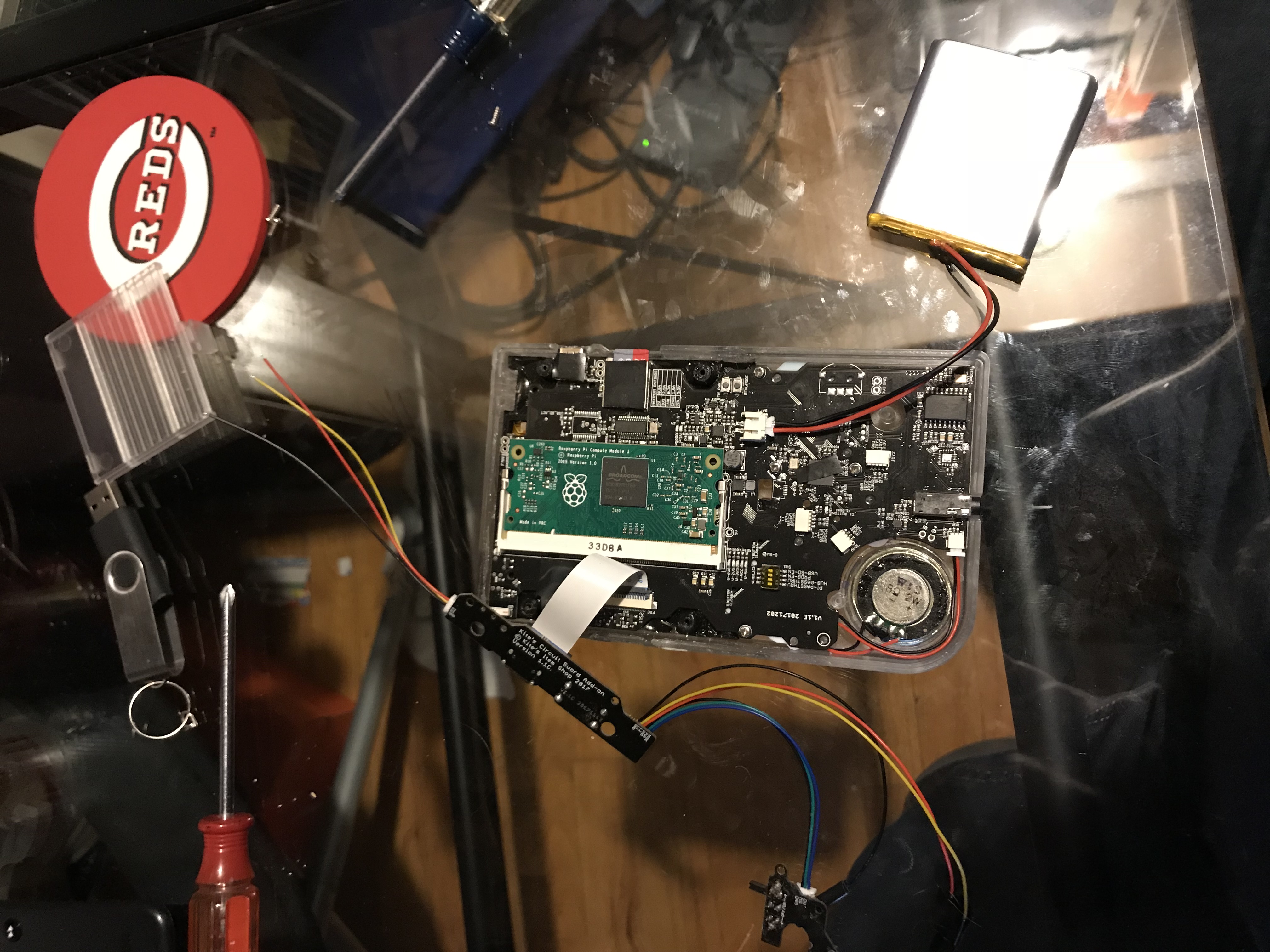

I have them attached like the following:

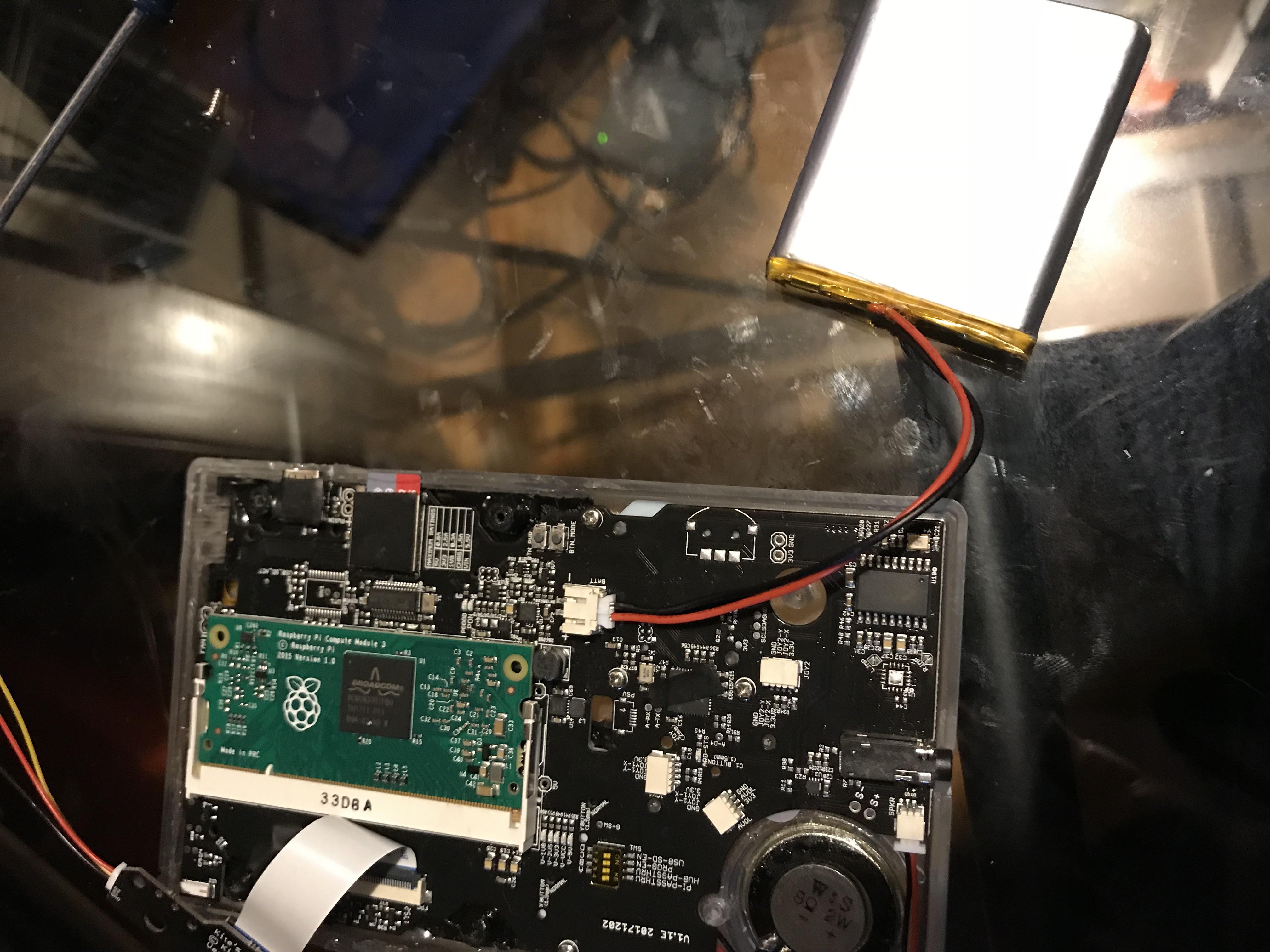

Here is a closer look:

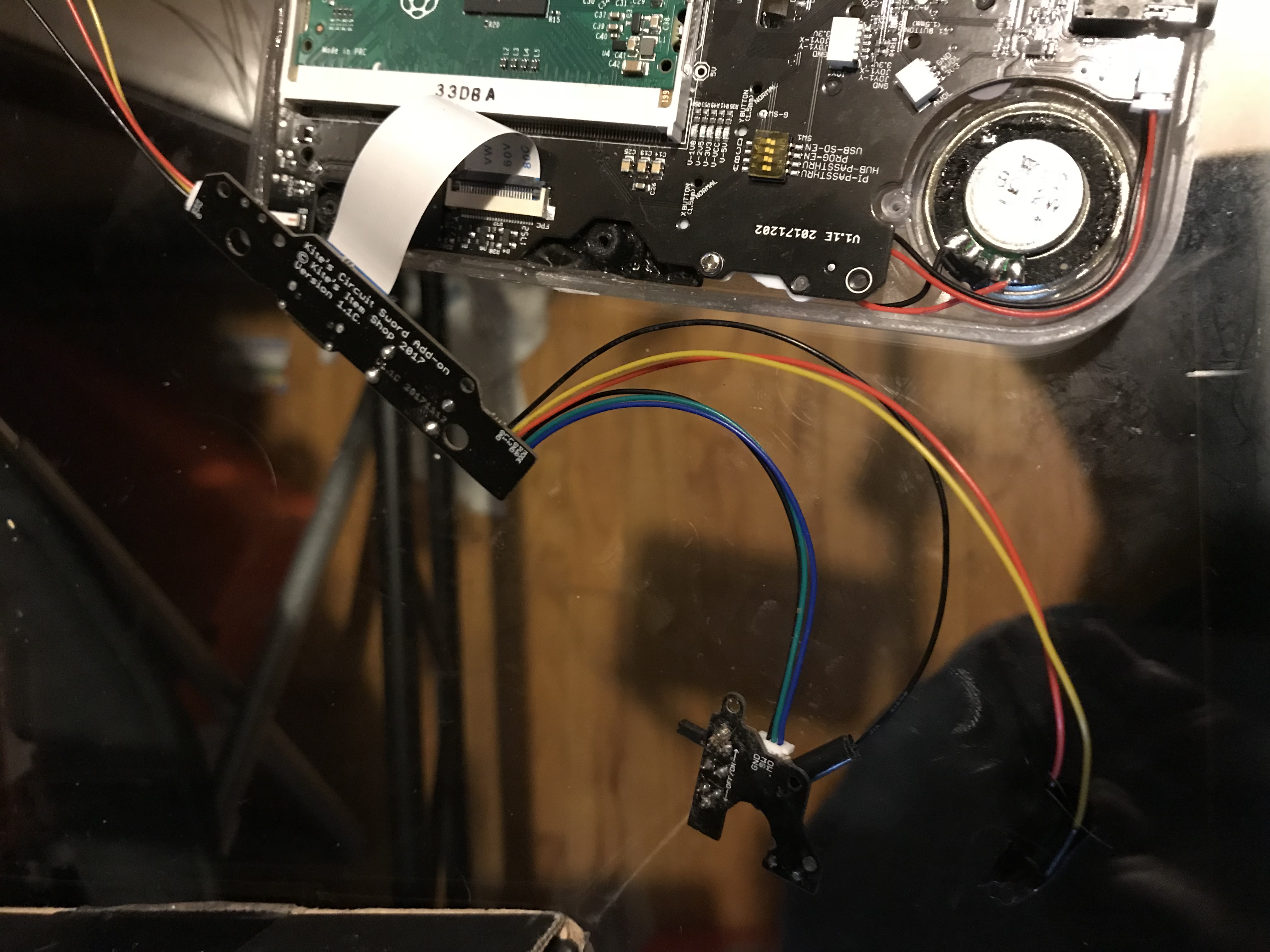

And here is me pushing the power button on the Sword board
Thanks for the help and please let me know what you think Kite!
Also when I press the power button on the board should the Gameboy stay on or should it turn off a little after I let go?

If you 'hold' it, it should stay on.. as soon as you release the button it will start a safe shutdown.
The switch board, you can see has some labelled pins (MODE, PWR, GND). Can you use a multimeter between PWR and GND, when the switch is 'off' it'll have no continuity, and when 'on' it should be shorted together.
I'd imagine you would need a new power switch board, send me an email and I'll send you one for the cost of postage
