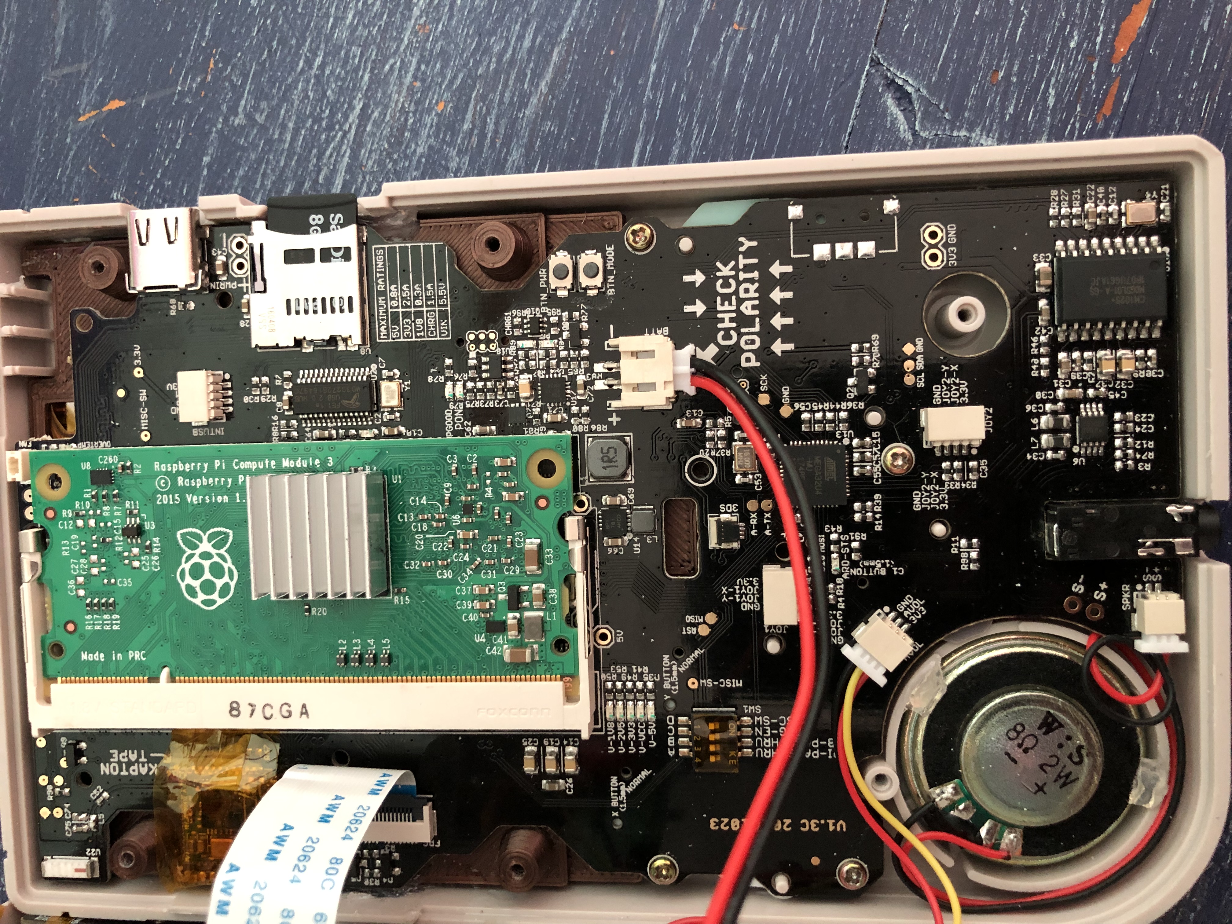

Could you get a picture of how the battery is connected to the board?
constipatedchicken
Posts: 32
Joined: Tue Mar 14, 2017 4:20 pm
Re: power issue
Post by constipatedchicken » Fri Mar 22, 2019 2:26 pm
here it is. it also does the speaker chirp even with the battery unplugged now. i played it last night and then this happened this morning.

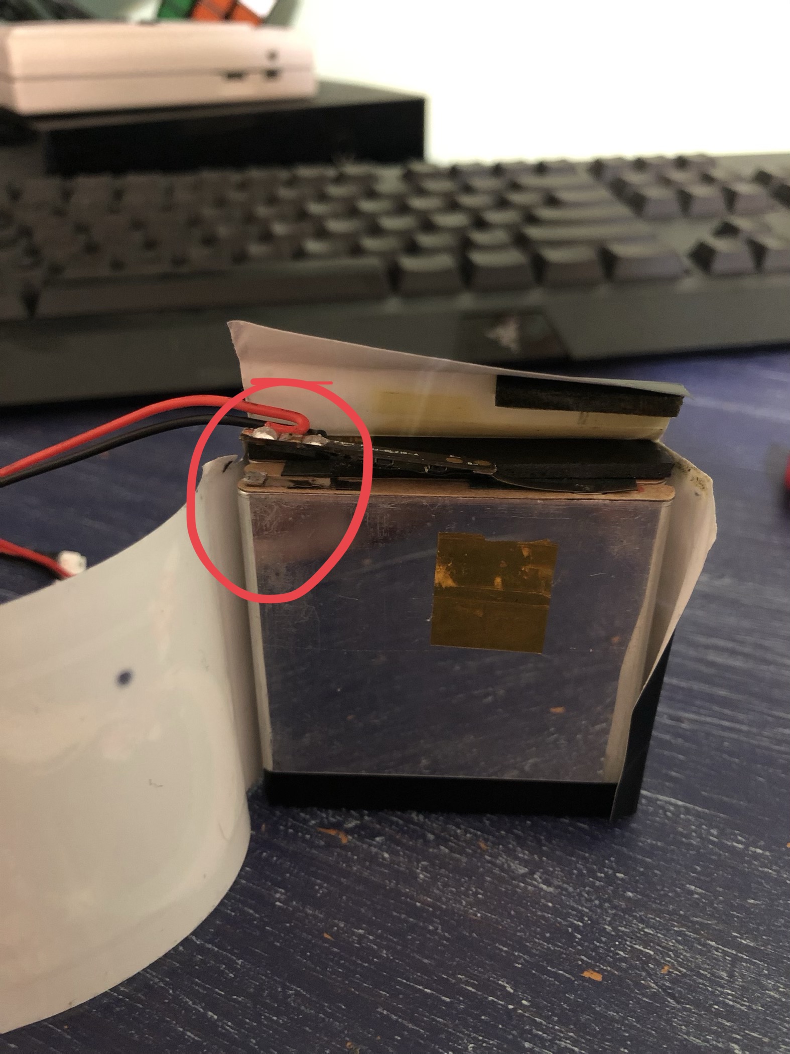

constipatedchicken
Posts: 32
Re: power issue
Post by constipatedchicken » Tue Mar 26, 2019 8:33 am
may have found the problem. correct me if i am wrong but the part i have circled should be attached? if so should i try to solder it back myself or would it be safer to see if helder can help?
edit. when i plug the battery in and put pressure on that i have power so that is definitely the problem.
