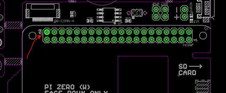

Re-work to solder on this pin, note that the picture shows the side of the board that has the Pi on! :
Make sure to rework the solder on both sides of the board on that pin in the top corner

Post by eggbowl » Sun Dec 08, 2019 12:13 pm
Now the screen is all white.
