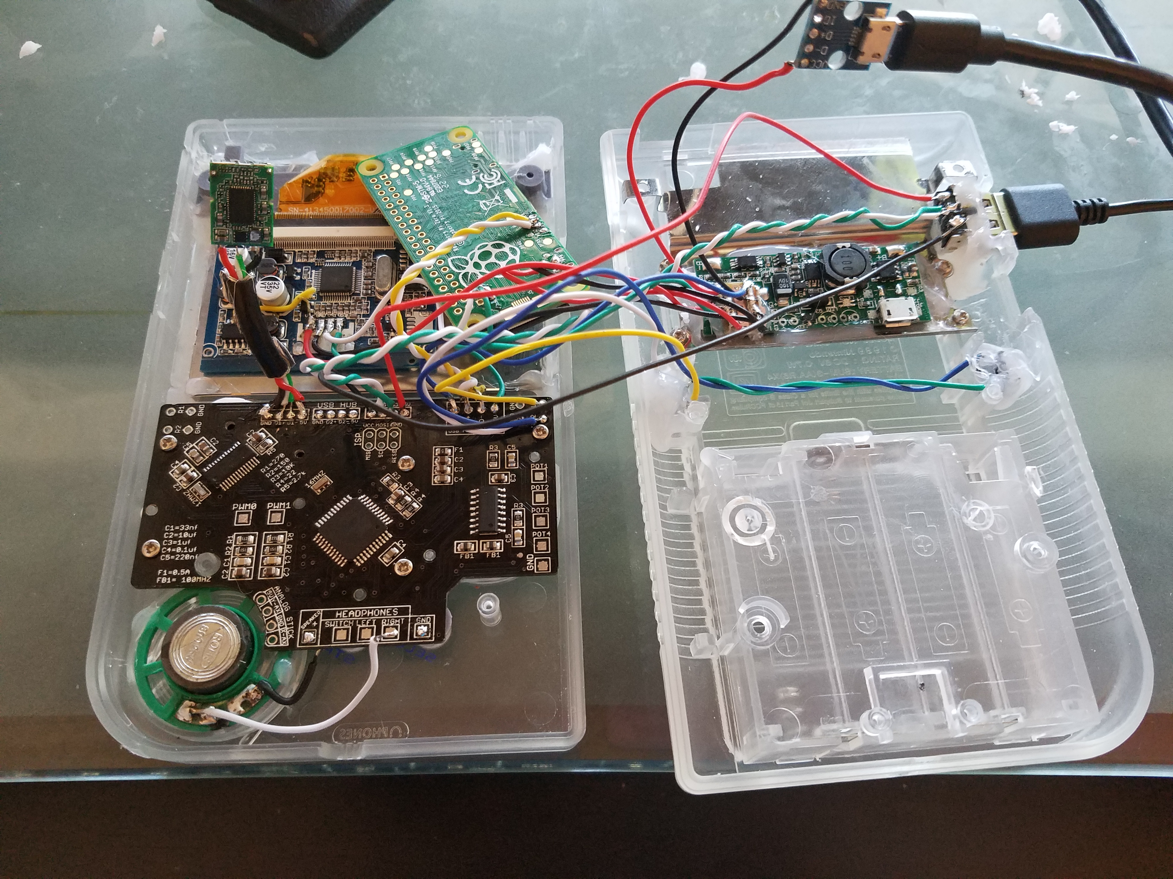

Helder wrote:
ocmoho wrote:Seems i am also having some issues, i just got my board yesterday, so its the new batch i believe.
hooked up to the Pi, it recognizes the AIO, I can also set the buttons so the arduino is working. I have 2 separate USB wireless cards i am trying, both work in a separate PI(wiuth different hub) but will not work with the AIO hub. I tried editing the cmdline.txt as well as using shielded USB cables, mind you it is only about 1" in length. they both blink once like they are recognized but then never seem to blink again after that and the Pi doesnt see any wifi cards.
any other help?
Try this:
edit /boot/config.txt, add a line "max_usb_current = 1", and reboot.
just did that, no fix.
pic of wiring
ocmoho
Posts: 10
Joined: Fri Aug 26, 2016 5:14 pm
Post by ocmoho » Sat Sep 17, 2016 6:27 pm
OK so my wireless card is recognized in rpi, it is in the lsusb devices. I'll have to follow some more testing.still does not see any networks

ocmoho wrote:OK so my wireless card is recognized in rpi, it is in the lsusb devices. I'll have to follow some more testing.still does not see any networks
definitely something with the hub in the AIO, same wifi works in another zero with a different hub with no problem.

Post by Helder » Mon Sep 19, 2016 11:19 am
KaiKona808 wrote:No luck this weekend with all the different testing. No matter how I wired it the Pi0 would not recognize the AIO.
So I have a new Pi0 coming in and a USBasp. I'm and hoping it is either I shorted the current Pi0 usb when I soldered the AIO to it (why did they make those pads so d@mn close) or maybe the AIO just needs reprogramming.
Hook it up to a pc and see if it's working there and if is then you might need to reinstall th OS. I just had someone with the same problem and he reinstalled the OS and it worked.
WiFi has been an issue yes but if you add the line of code a few posts up I made and the other line in the first post it should work.
The usb hub issue should be fixed on the new AIO 2.0 and as it is now a quick fix can't be done on the 1.4 boards.
I'm working on a work around and will have something maybe 2 weeks from now.
You can power the usb devices from the power strip as long as 5V and GND are all connected through the power strip.
