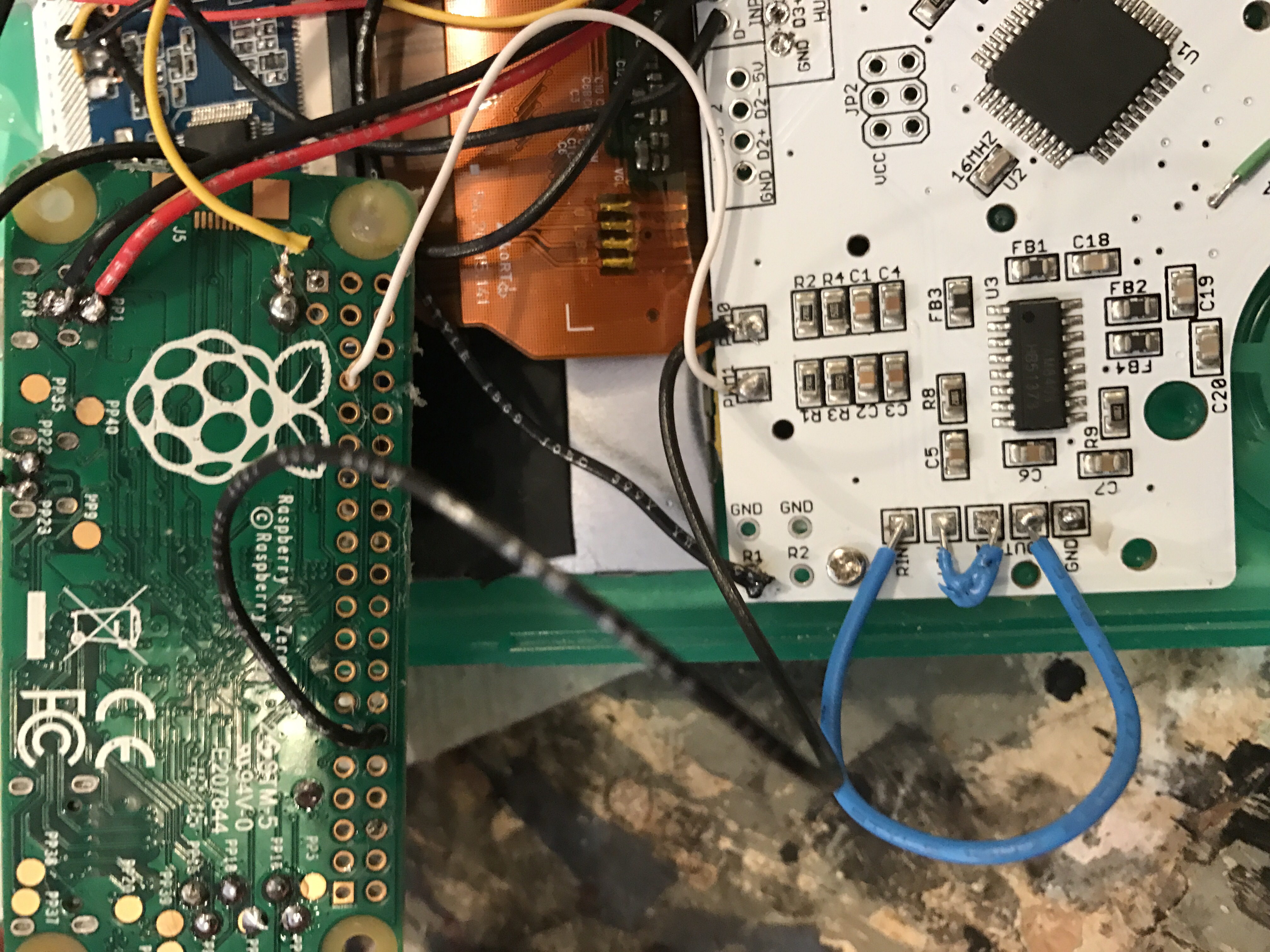

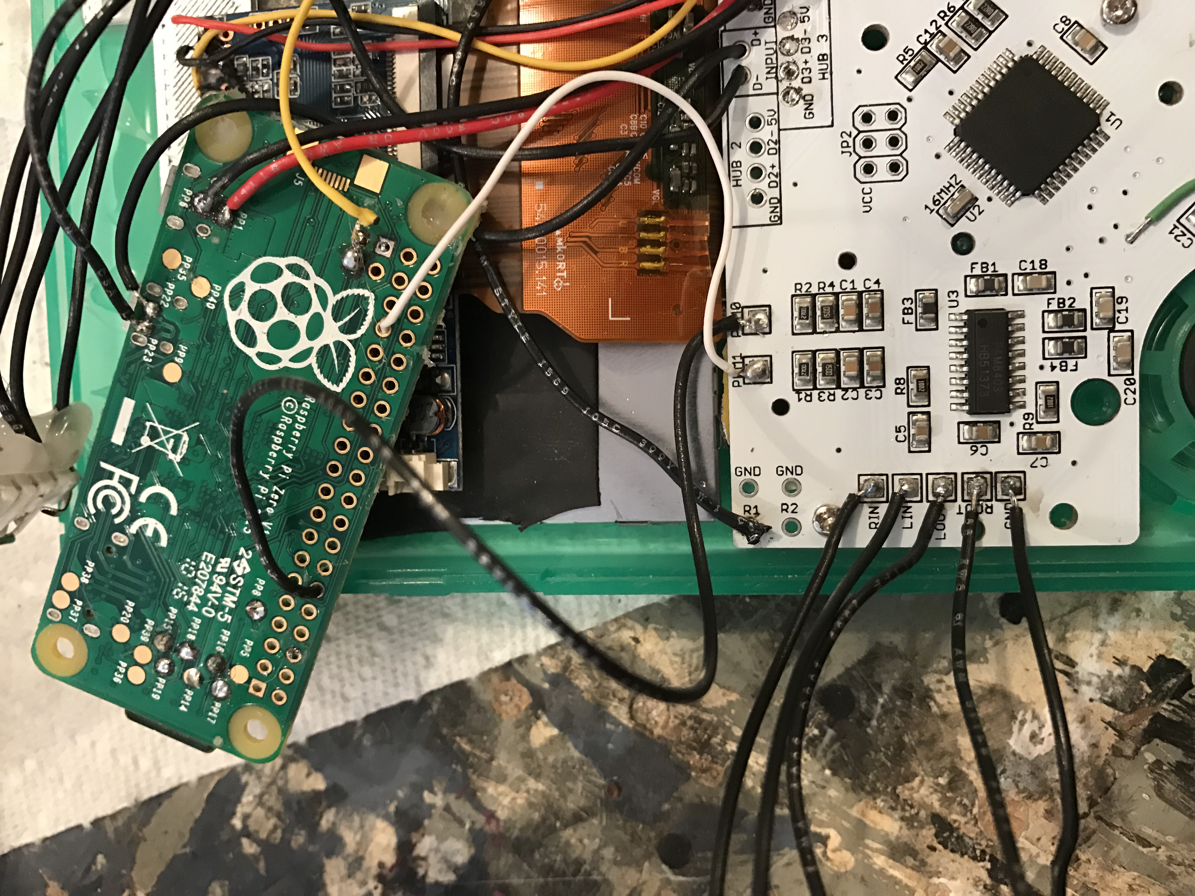

Post by Metallicis » Wed Jan 04, 2017 10:59 am
Still nothing, I jumped the wires like you said and no sound except a low buzzing. A curious thing however is when I attempt to select the volume mixer from the menu it simply crashes back to the menu. I've been googling around trying to find a fix but nothing yet. Here are pictures both with and without jumped potentiometer points
Post by Helder » Wed Jan 04, 2017 2:51 pm
Hmm it looks right in the wiring, and how are you powering the whole setup? can you take a wider view so I can see everything else and how it's wired.
