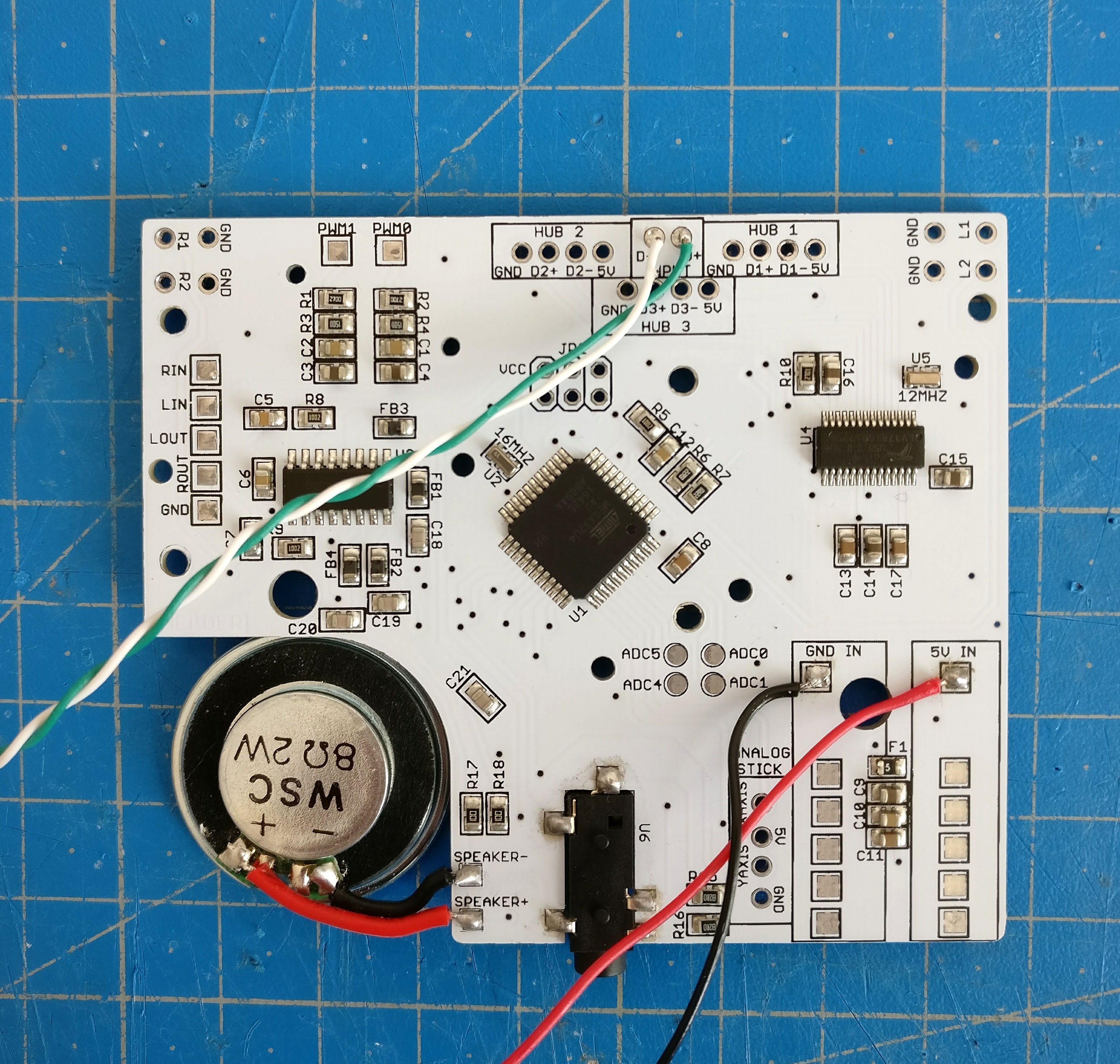

Post by RobbsyB » Mon May 22, 2017 12:39 pm
The only things I attached to the board are the speaker and 4 wires for USB connection. Speaker +/- are wired correctly and USB + /- are soldered to the bottom right pads 5V IN & GND IN. Green wire goes to INPUT D+ and white wire to INPUT D-. Thats it. Nothing else attached at the moment.

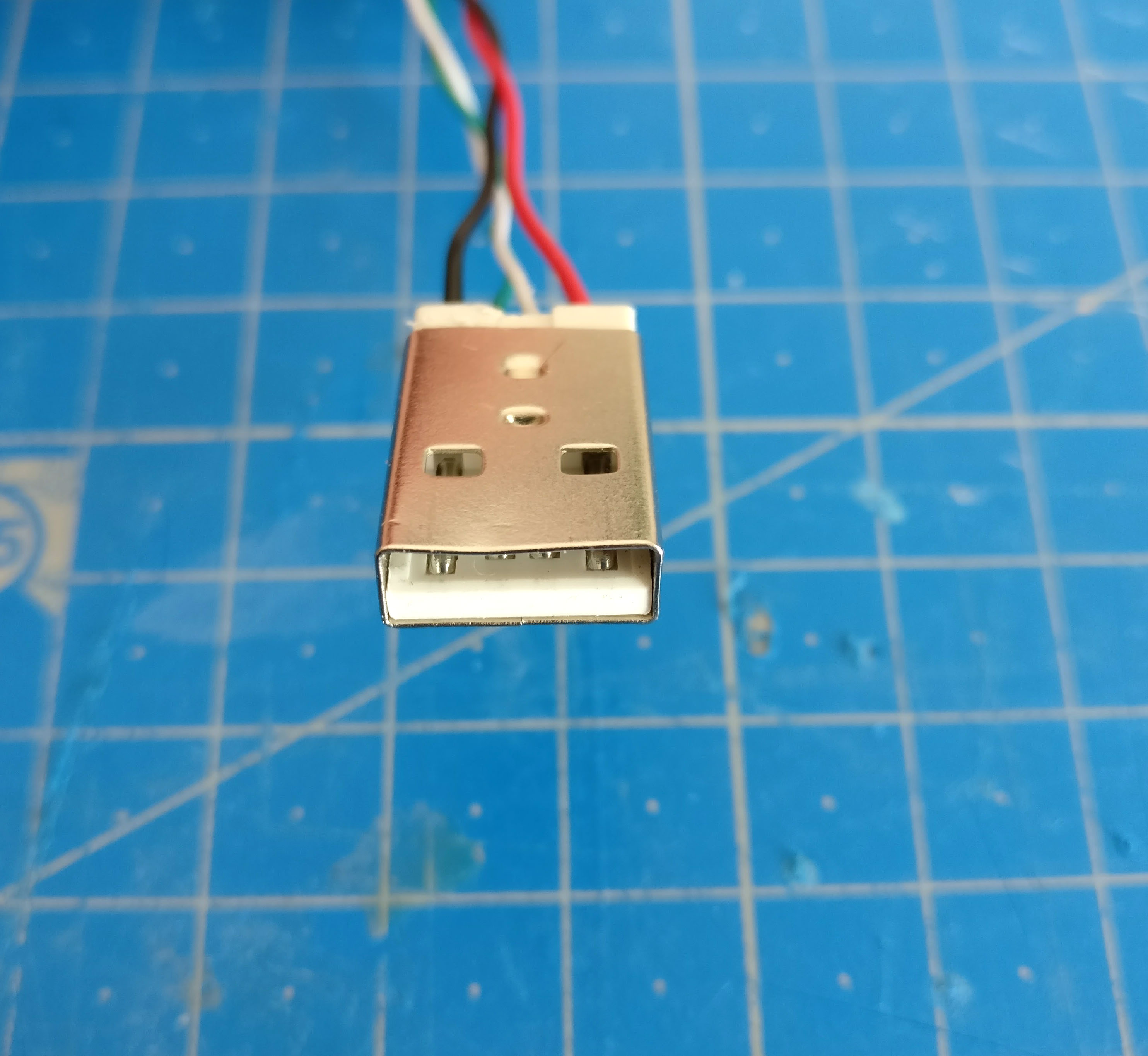

Post by Helder » Mon May 22, 2017 6:34 pm
RobbsyB wrote:
Mon May 22, 2017 12:17 pm
Hey
I received my AIO 2.2 board 3 weeks ago and had to wait for all other components to arrive. Now I have everything and I started to test if the board is recognized by my computer as a SparkFun Pro Micro. However, if I connect the board to my PC, nothing happens (no entry in Device Manager) and the board gets warm.
What should I do?
Board gets warm means there is a short and it's likely your wiring which we don't have photos to see what it looks like so we can't help much also I take no one's word that the soldering is fine unless I see it since that is almost always the problem. Get us some photos (decent ones of the USB wires and what is powering the board) so we can asses the problem.
RobbsyB
Posts: 29
Joined: Wed Jan 18, 2017 4:32 am
Post by RobbsyB » Tue May 23, 2017 12:18 am
It's just 6 wires, but I totally understand your point!
I'm at work now, but I will take some photos in the evening!
RobbsyB
Posts: 29
Post by RobbsyB » Tue May 23, 2017 7:54 am
This is my PCB with USB wiring:

Post by cobramike » Tue May 23, 2017 8:04 am
Maybe a stupid question. What voltage is the board getting. Do you have a multimeter. I had a problem to with a banggood charger and was outputting 7v.
RobbsyB
Posts: 29
Post by RobbsyB » Tue May 23, 2017 8:16 am
I am connecting it to a computer. So I should definitely get 5V.
My goal was to test whether the board is detected as a gamepad and then check all buttons with "Set up USB game controller" (Windows 10).
