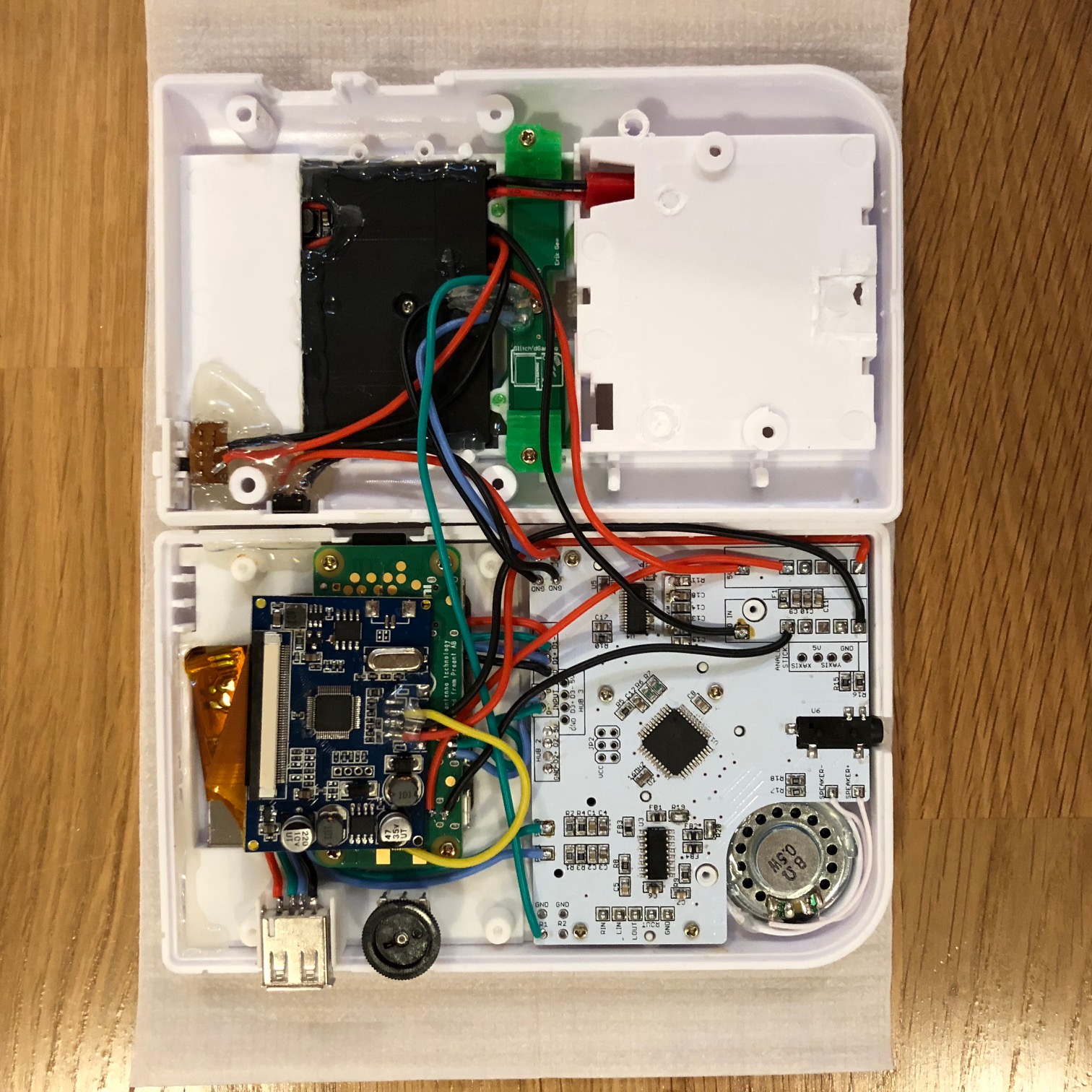

i bought one of the retro gaming now boards and the controls (and USB port) aren’t recognized by emu station. wiring is good, reinstalled retropie image, still nothing. do i need to program the board with my usbasp?

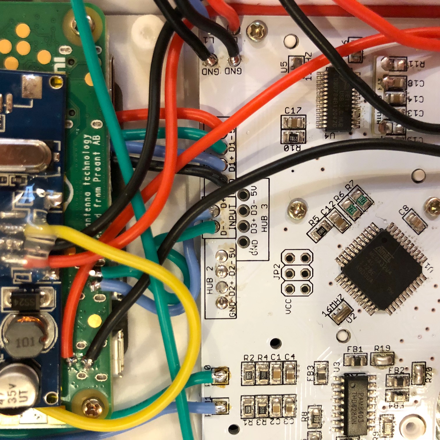

Post by endergx » Thu Feb 08, 2018 10:14 am
hey veteran, here's a couple photos. everything is wired exactly like the diagram shows. let me know if i'm missing something obvious.

Post by VeteranGamer » Thu Feb 08, 2018 1:36 pm
you wiring doesnt look that bad (actually looks pretty decent)....
also the board doesnt need programming, it should work as is.....
i would recommend to have the wiring of the data leads twisted like this (it might help)....
also i personally dont think/feel that heavy gauge wires are really needed for the data connections, especially if you intend to twist them....
you can strip a decent USB cable and used the wires from that (and they should normally be easier to twist, and stay twisted)....
did you actually test everything (especially the AIO) before you started to glue everything in....
also this is something that Helder can anwser.....
the Hub chip looks like its been modified/replaced (not 100% certain on this).....
maybe a reflow of the hub chip might be needed (again, id get confirmation from Helder on this)
but try the twisted data wires first, that might help......

Re: Cant upload to Aio v2.2
Post by Helder » Fri Feb 09, 2018 3:56 am
I know it's my board but since I'm not selling any at this time but RetroGamingNow sells them he is the one to contact with any issues.
Have you tried hooking this up to a PC to see if it's recognized? The usb is supposed to have that little board and bridged pins in order to work properly so don't mess with that.
