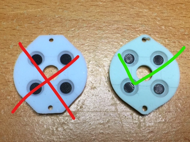

htrd wrote:so i tried a couple of games that kinda need a 8way movement like mk/street fighter etc. cant jump forward consistently or tbh almost never , this makes this games unplayable :/ anyone got any ideas to fix this ?.
I'm having the same issue with my AIO v2.0. I've be tried looking all over sudomod forums for an answer- anyone have any insight on this?
Try reprogramming the controller with a USBasp or the Arduino IDE (look in the Other Hardware subforum), also check to be sure there isn't something causing pressure on the dpad area of the board or that the silicone pads are large enough to make contact with the traces on the board.
I have the same problem with my AOI v2.2 ... did the reprogramming helped anyone?

I think the code is ok ... the question is if pressing UP+LEFT or DOWN+LEFT is supported on the AIO-Board? I'm not sure ... I have build one GBZ for a friend and he said it's imposible to play games like Street Fighter where diagonal controlls are needed. I'm not able to test right now. I have a GBZ with Kite's Board and the controlls are working without any problems ...
The kite board is also using the Arduino SA Leonardo ... so I'm not sure if I have to reprogramm the AIO 2.2 board and if this helps ...

Post by Paddy » Wed Apr 12, 2017 4:05 pm
ok, I found the problem ... it's just a mechanical problem. I used two different pads (one new from Ebay and one old from an old gameboy) ... it's unbelievable but the old one is working without problems ...
So if anyone have similar problems ... try different pads first:
