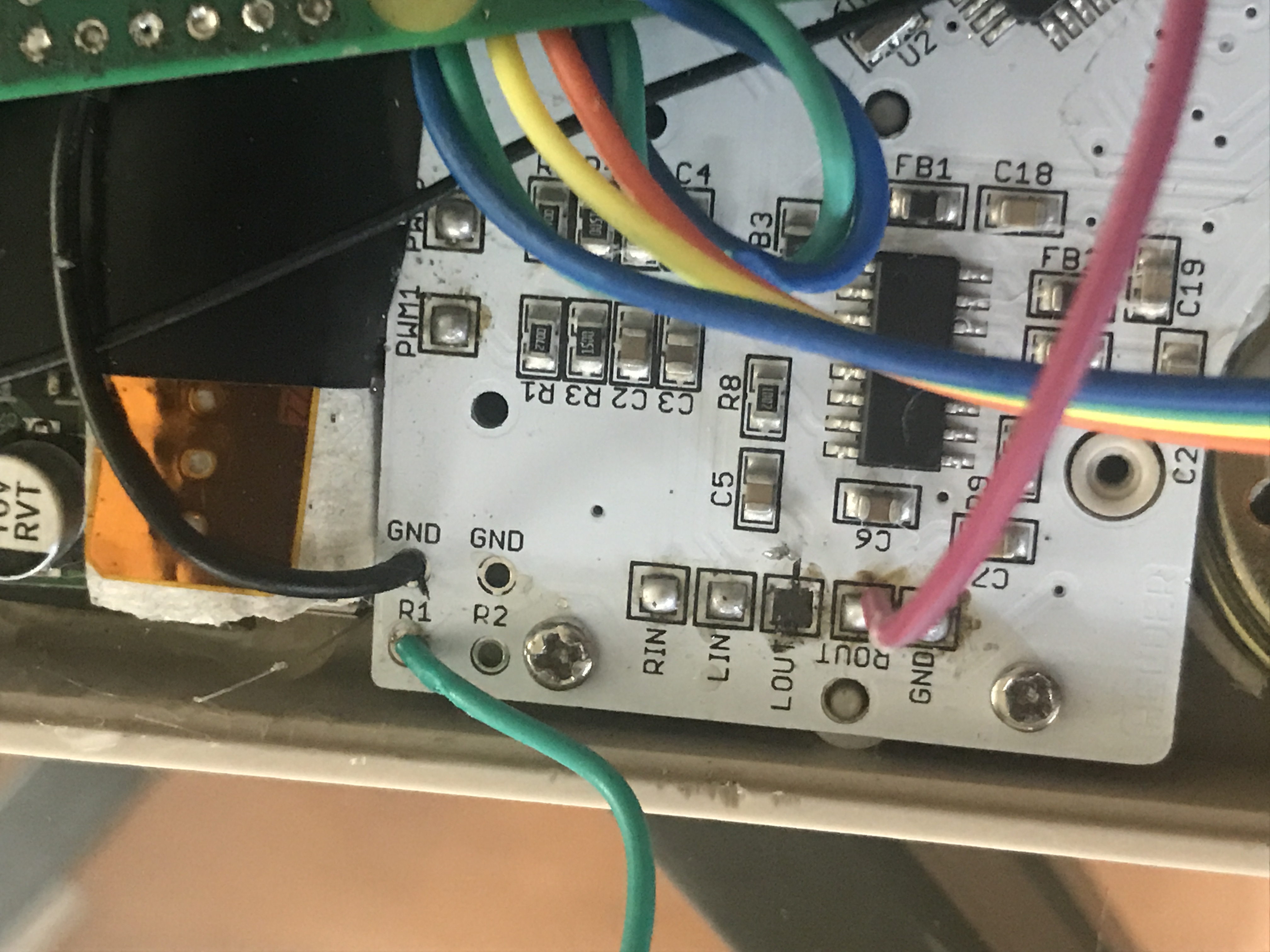

Help, my solder pad actually fell off of the board how can I fix or use alternative rout
First post I have an image with alternate points, use better equipment since you burned the pad off from a high temp iron.
Helder so I have to do solder it to the resister and it should work ? Dude thanks so much!! For responding
