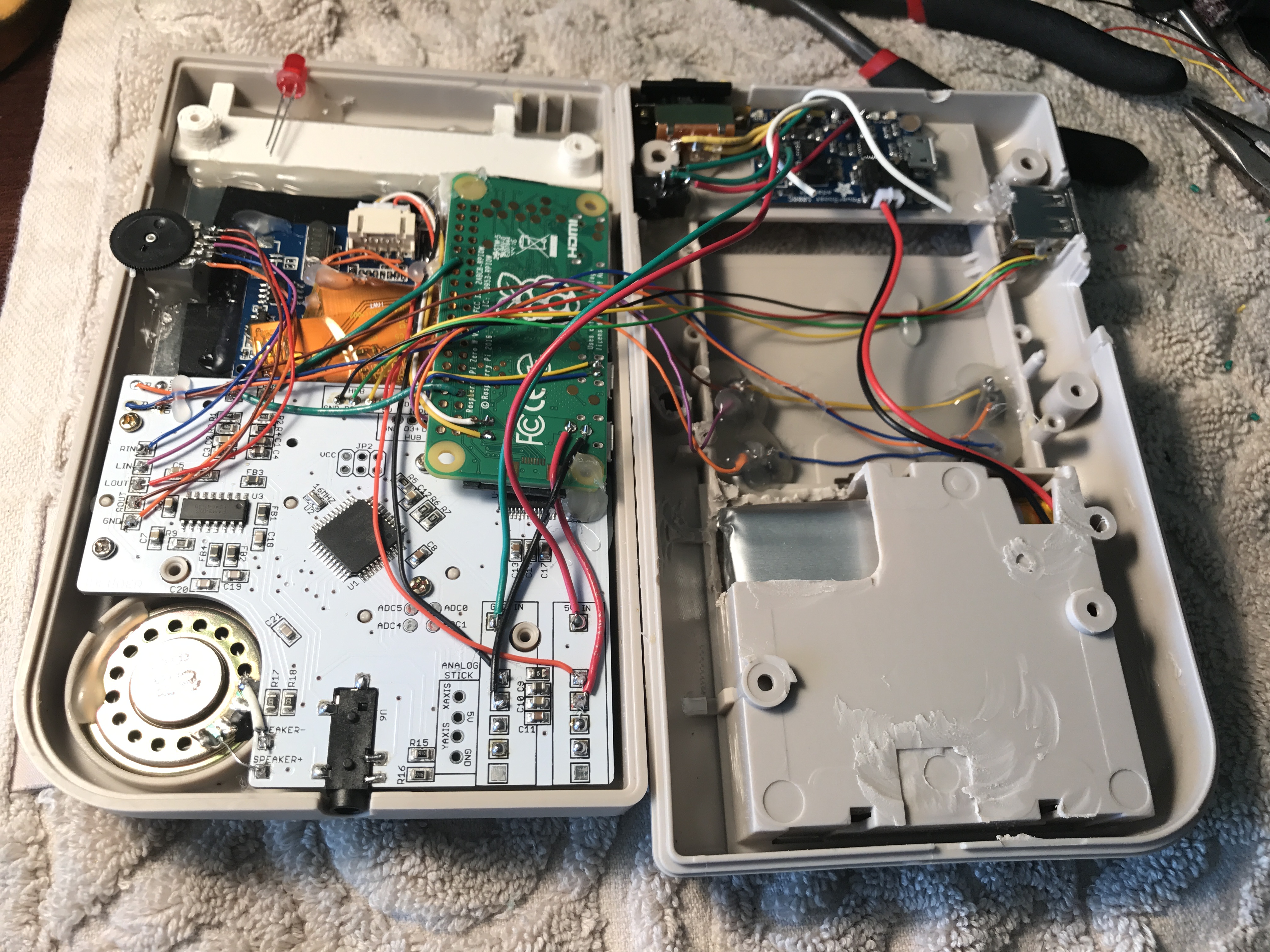

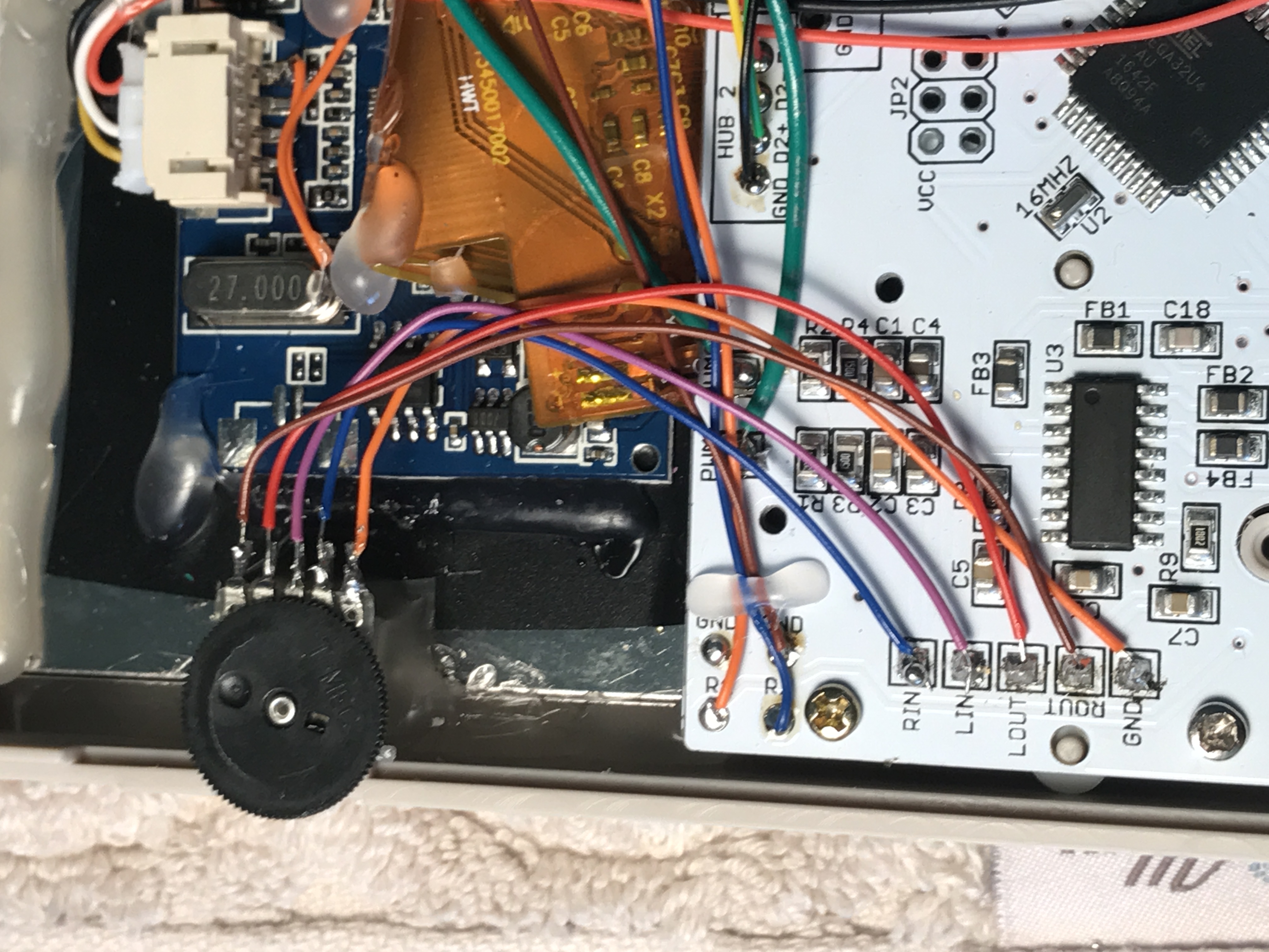

Post by jermzz » Sun May 07, 2017 1:56 pm
Having a strange audio issue. Everything works for the sound, but it's constantly skpping, going in and out. I've tried everything short of replacing the pi itself, which is next. I wanted to post up here my wiring just to see if someone sees something I missed, or has a suggestion on something to try. The sound is not only broken in emulators, but also broken in the ES menu when clicking through roms, which leads me to believe its hardware related. Especially since I've tried multiple SD cards. help?
Ive tried 3 different speakers (stock and adafruit)
two potentiometers (b10k, b103)
Wired, rewired sound multiple times
2 different SD cards with multiple fresh retropie installs.
wiring pictures:
and alink to a short video of what it actually sounds like:
thank you.
EDIT: Also replaced the pi. Problem persists. Seems the only thing I haven't changed now is my AIO. Not sure what would cause this problem. The amp?
EDIT 2: Problem is not present when using HDMI out to an external screen and much less apparent when using headphones, but still slightly there. Sometimes experiencing small lag spikes. When the sound lag / skip gets really bad it does cause lag in game as well briefly.
Edit 3: If I disconnect one pot (L or R) from the AIO problem goes away. But then sound is obviously coming from only one side, and it's less audible. Also if I turn the volume way down, like low enough I have to put my ear really close to the speaker to hear, the problem also goes away.

Post by Helder » Mon May 08, 2017 2:03 pm
wiring pictures:
thank you.
The 2 resistors labeled 910 to the right of the headphone socket should be changed to a lower value like 75 ohms and see if that fixes the choppyness. The manufacturers messed up and put 10ohms there so I have been manually replacing them with 75ohms but ran out and used the next closest value I had on hand. So changing those to 75ohms might fix the issue as I've not had any other complaints from the 75ohm installs your are the 2nd person who had this issue in this batch so those must be the culprit.
I can replace the resistors if you send the board back to me or you can try to swap them yourself and see if that fixes the issue.
