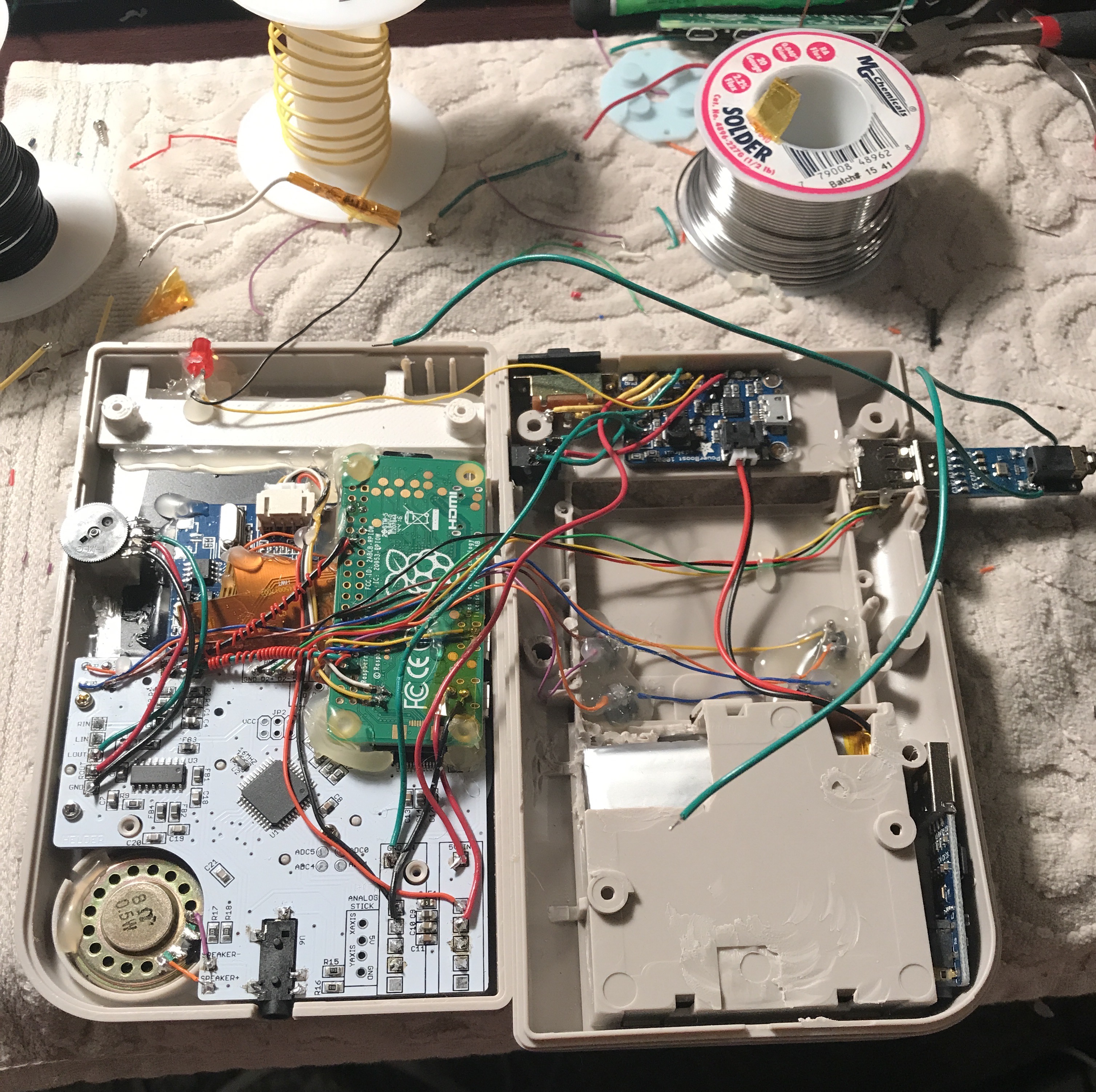

the onboard audio is fine it justs needs the right envioroment (providing the wiring is correct), my aio board originally came with 10ohm resistors, i changed them for 75ohm (still an issue) joined the the two pwm wires together and put a jumper from the resistors to the speaker.... that actually worked or so i though as i had only really been testing without the case closed, once closed the problem arose again, so i shielded the pwm wires, that seemed to have resolved the issue....
but i was wrong.... while my son was playing with it, i actually noticed that tetris sounded off (he actually was none the wiser and was most probably thinking thats how things were back in the old day).... so i going to reshield the wire and the reason for this may be obvious in this video
watch the video til the end (its unlisted so i'm not trying to generate views)
theres obviously something causing noise or interference and most probably nothing to do with the resistors (unless your getting low volume)....

First post has images of alternate points (do people even look at that post?). A USB sound card can be used with the board instead of PWM and it works rather well. Hollyhoo has done this recently and didn't need to change anything on board if it had 10 ohms since it got a little low with higher value resistors.
Basically you take the usb output L,R and connect those to the top 2 pins on the Volume wheel (L and R) and then everything connects like it does in the image on the first post .
If I had the usb sound card and volume wheel fritzing parts I'd make a diagram so it's "easy" to follow.
So, since I can't run out for resistors til tomorrow, I tried hooking up USB audio. Plugged the dac into the USB port of the gameboy and put wires from L and R out to L and R in on the potentiometer. Same choppy shit sound. So then I just went straight to the speaker and it sounded perfect, just low obviously because there's not much amplification.
So I guess all that's left is to change those resistors. It's obviously something between the pots and the headphone jack, and based on the quiet sound, the amp is working as expected. Sigh, this is way more work than it should be.
