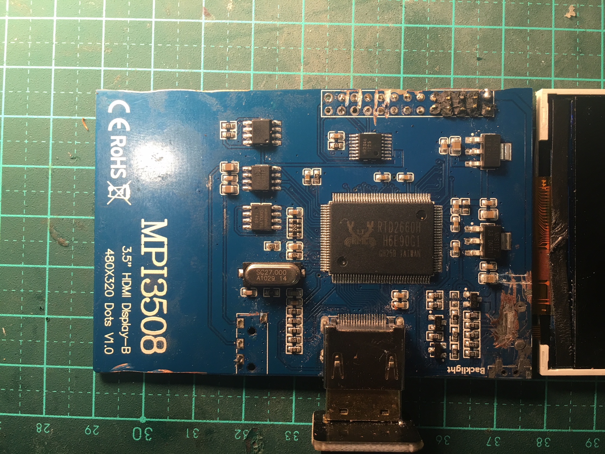

The bottom right one appears to be rubbed off or not even marked. I dont see anything whatsoever on it
The topright one is barely legible. That one took me about 5mins to even make out a single digit lol, not even sure if i read it right.
Knowing our luck, that bottom right one is the backlight controller and we have no idea what its called lol. Like i said, its not marked in the slightest, i dont even see the remnant of a letter/digit somewhere.
edit: Poked at it with an ohmmeter: sure enough, the (looking at the image) left pin of the backlight switch is connected to the topright pin of that mystery chip. Awesome....

Thanks a lot for the picture of your board and the infos. Our current findings are:
Why is the mystery chip connected to the touch controller? :?

Made some progress last night:
Atm I think the mysterious chip has to be a companion of the touch controller and is useless for us.
But the upper left corner looks suspiciuos. I think these are MOSFET's driven by the Main chip (PWM?), supplied by 5V0.
And I noticed, that I can hear the backlight in the audio signal on my loudspeaker. I think the manufacturer hasn't applied proper filtering between the backlight driver and the 5V0 rail.
My first reverse engineering project and I like it! :D

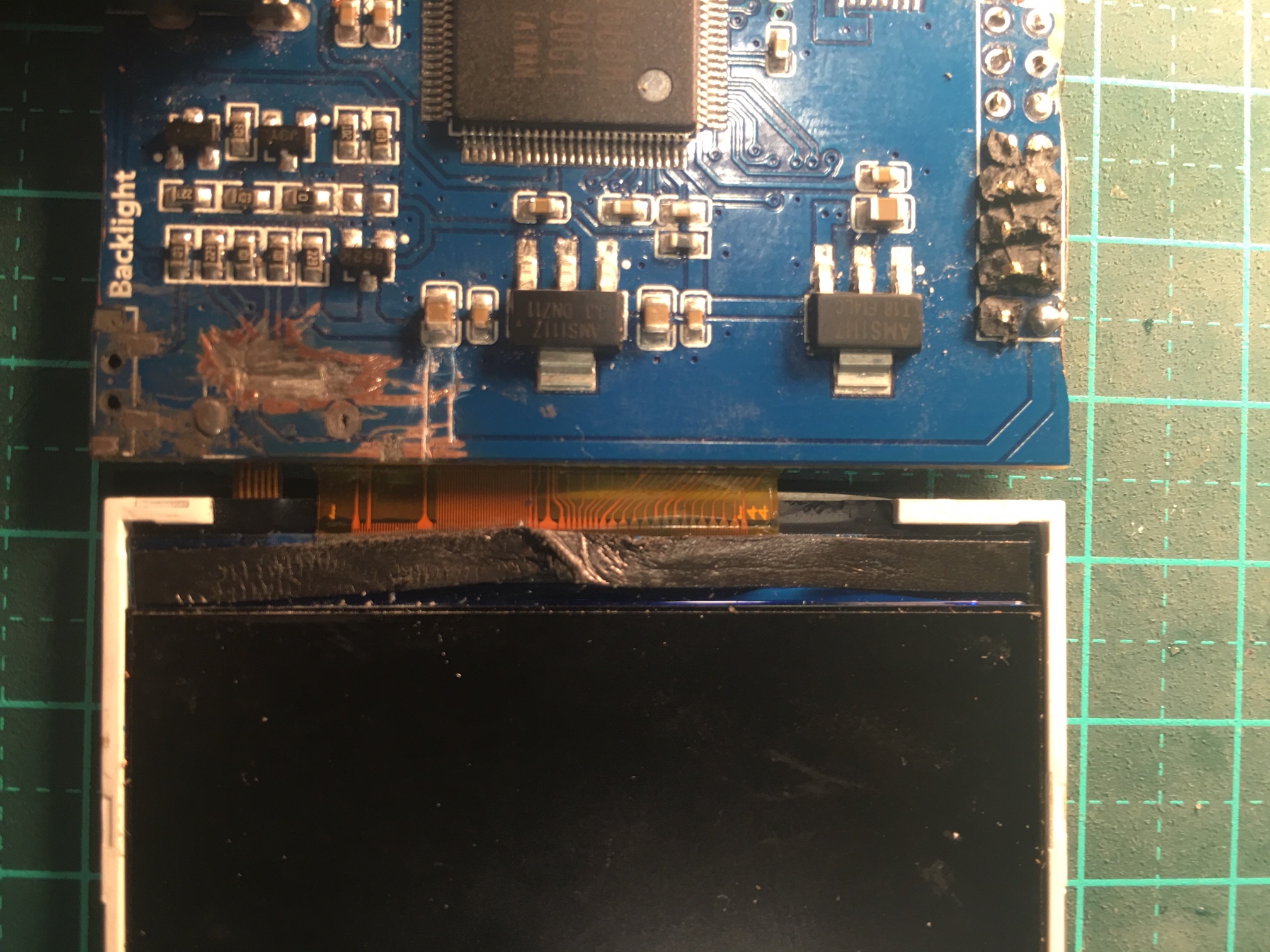

I've now removed the usb port and backlight control switch and it seems that the 5v0 rail is being sent to ground. The butchering that I've done - I tried to scrape away some stuff around the port to see if that would fix it - it didn't. When working on the board are people removing the screen from the main board or just leaving it in place - im not a massive fan of these soldered on ribion cables but I think on the next one I'll give that a go. Also the butchering was mainly due to me not having a decent chisel tip soldering iron - I had to use a small tip which makes desoldering hard - in the end I got inpatient and cut away the header - after this the board and screen did work - then when I attempted to desolder the usb port and switch shit got a bit fucked - hence the butchering.
Im hoping maybe someone has found another spot to provide 5v to the screen - I've already ordered an new screen but it would be nice if I could get this one working. What Im thinking is to remove the screen from the board (I've done something like this with a composite screen build i did) - I've now got a nice large chisel bit which should make things easier. Then cut away that corner and see if i can reconstruct the 5v coming in from the usb port.
Could someone please take a super hi res photo of that section (I know this is asking alot) but it would make things a little easier - I'm hoping that this may also lead to figuring out if we can bypass all 5v all together.
Attached are the pictures

So I've been able to get the screen up and running - but during the last week I wasn't super careful with the screen and cracked it - at least I thought I had, and I did. I was able to solder off the screen which made desoldering the header alot easier. I've got another screen on order but I''d like to see if I can get a replacement screen minus the controller and solder it on - I would assume that they'd be fairly cheap. Would anyone know of a replacement, and where to buy it ?
Hi,
just saw your post, I got no email about answers, so I was late.
I will check if there is a alternate connection to the 5V rail, if the header and micro USB port is desoldered.
But you have to make sure you don't have any shorts between 5V and GND or you will burn the traces on the board.
