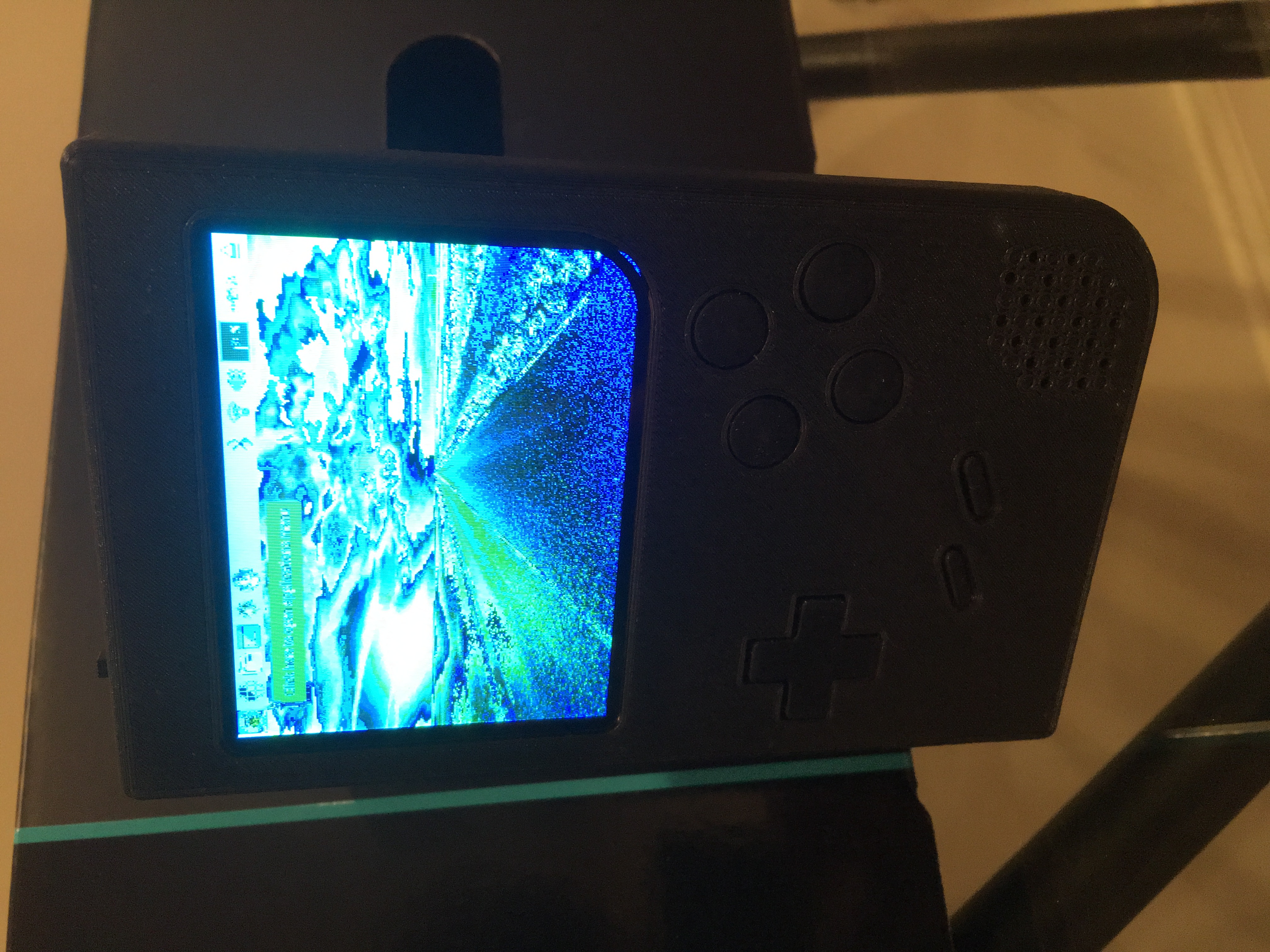

I've got an image now! Thanks! There's just one issue: I get no red channel and the colors look crazy :(
Take a look at what I mean:
ImagesShow
It's possible that it's wiring, though I went over it at least 5 times to make sure it wasn't that. It looks as though greens are blue, reds are green and there are no blues to be replaced with reds.
I used this reference for the Pi's pins and this datasheet for the displays.

There are different colour modes for the DPI screens
You need to adjust the dpi_output_format so that it is the different modes. I found this post, http://blog.reasonablycorrect.com/raw-dpi-raspberry-pi/ (nod to electriccrowbar on discord) and in this post he has a link to a spreadsheet that helps you to calculate the value you need
https://docs.google.com/spreadsheets/d/ ... sp=sharing
This is how I managed to fix mine 😀

I fixed it :D
The problem was that I'd wired for 888, but was outputting 666. Thanks!
