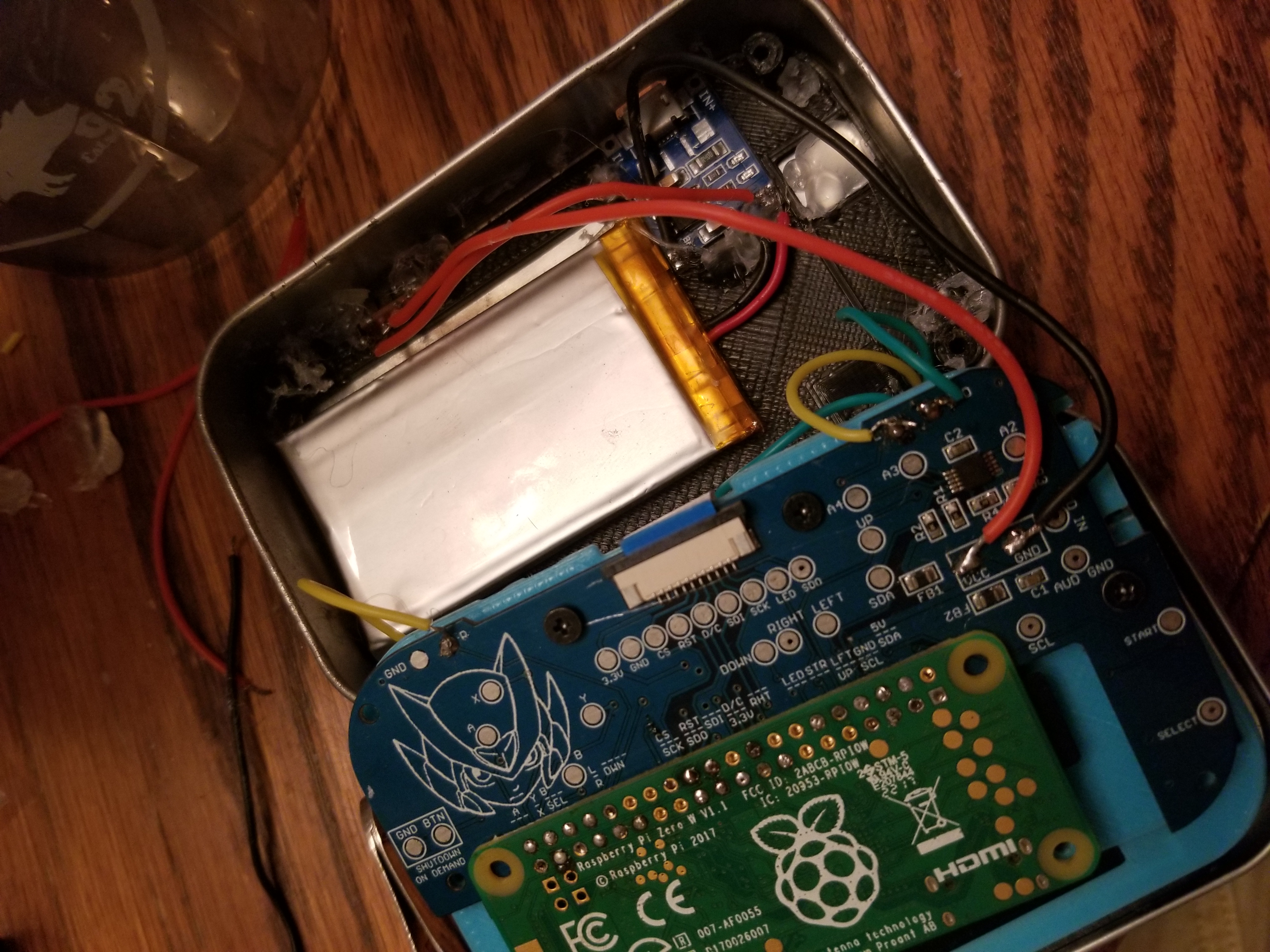

Sorry I didn't get back earlier, my stuff was all glitching out and I didn't even see there were replies to this until just now. I got my Pi working, but just this morning it quit working again. When I plug my power source directly into the power port on the Raspbery Pi itself, it boots up perfectly fine. It seems like power isn't making it to the board, but I could be wrong. Here's a picture of my wiring. My multimeter says my GND connection is good.
- My wiring
- 20180719_211619.jpg (3.61 MiB) Viewed 18914 times

Re: MintyPi Won't Power On
Check:
-Your power switch function
-Your battery positve soldering to the charging board
-Just in general check your ground connection between PI and mintypi board

With the power switch, I get continuity from the charger to the PCB when it's switched on and not when it's off. I noticed the battery positive wire is a bit frayed, but the multimeter says it all should still work. As for the ground connection, I have three pins connected (including the labelled one) and they all tested good. I don't have the proper solder with me to try to better the positive connection, but it seems like it should work.
When powered from the battery make sure there is voltage at the Pi 5v GPIO which is labeled on the mintyPi pcb. If there isn't that might not be soldered well to the pcb.
Thanks for your help. I took it to a buddy who is better at soldering than me to check my connections and I told him what you said. He re-soldered one of the pins and it works now. Thank you.
