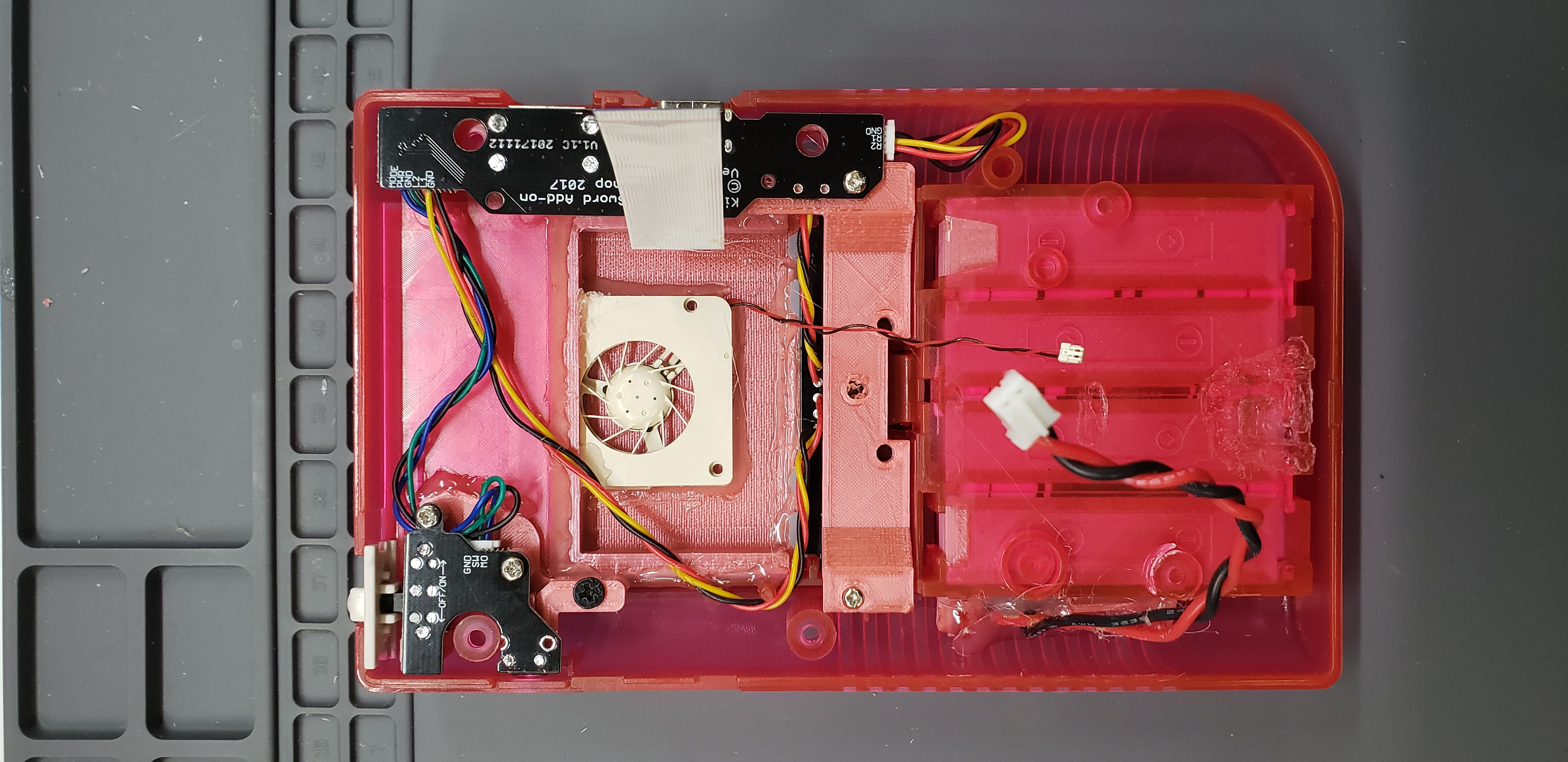

Had to bite off the outer part of the 3d-printed part and then it fit fine.
Board has to go on top, otherwise USB and analog volume control will be at an angle instead of parallel with the casing.

I haven't ever seen the volume board version so I'm not sure why it didn't fit. glad you got it worked out.
For thread continuity the board normally goes over.

Thanks for these files! I'm building a CS right now, and using your psp joystick holder. Did you use any glue or epoxy for it, or does the board hold it in place?

I would use a dab of hot glue to hold the bracket down and then use a toothpick to add epoxy to the edges. This is required for the joysticks or they could just pop out when playing
