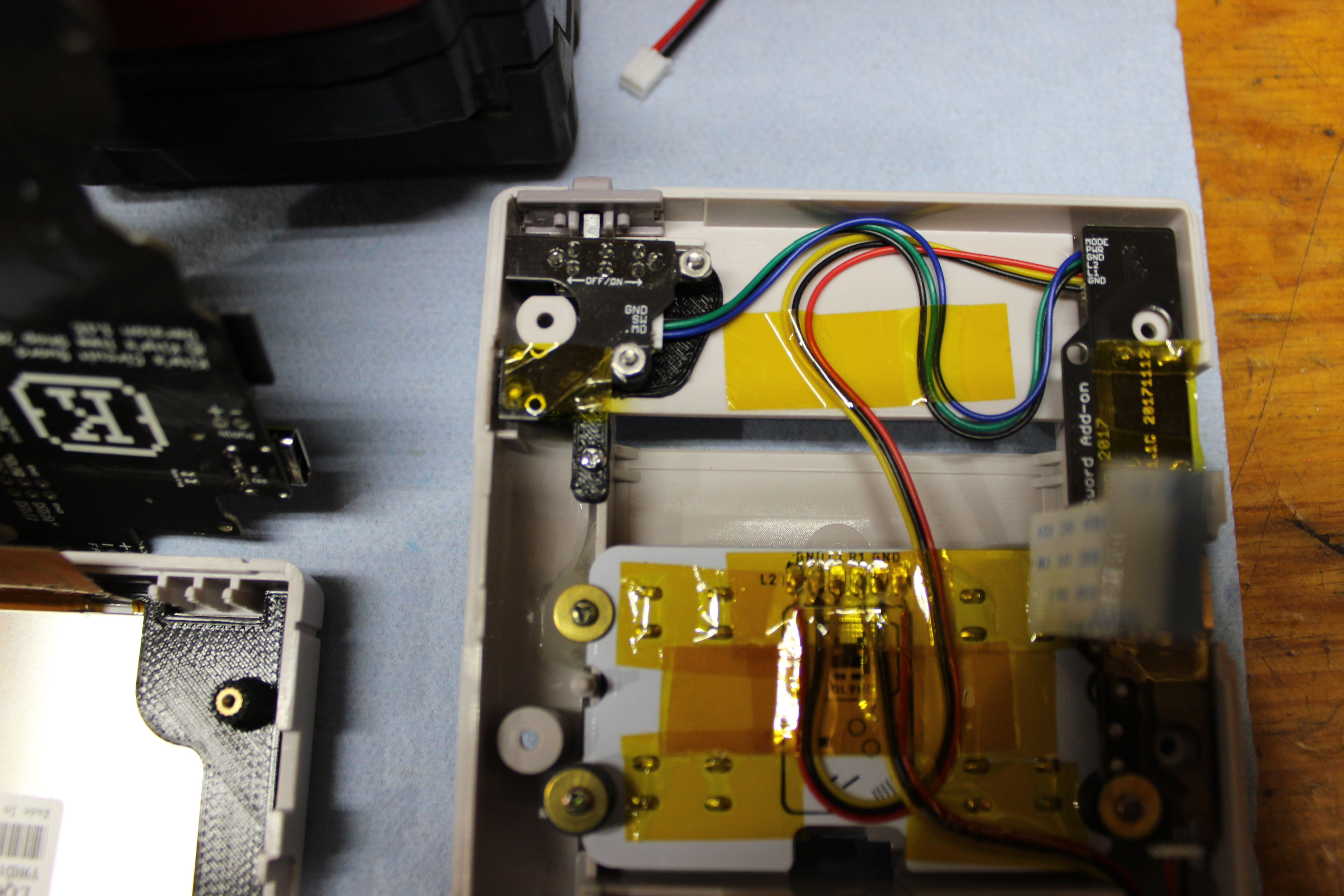

HoolyHoo - would you mind posting a photo of how the ButtonSupport piece is installed? I have both printed out and the ModerPowerBracket seems straightforward but I am not sure where to put the little ButtonSupport guy. Thank you.
Edit: One more question - with the bracket, the mode button is no longer centered in the hole in the case. In fact it's quite off. I will replace the momentary switch anyways for one with a longer button but is the expectation for users to solder in the new button with a lot of extension through the legs? In other words, not flush against the board like it the setup from Kite? Ah yes, I see in your description that's exactly what's going on.

After soldering the new, longer button, it will hang further down as I stated in my first post. The purpose of the second 3d part is to give the button the support it needs when pushing the button so that it doesn't bend in. Maybe this will make it clearer as to how it is supposed to be after install.
As you can see, without the "red" part, the button would have a gap and would not be stable when pushed. Originally, I had it as only one piece, but the problem with that was that trying to get the board and 3d part into that location was very difficult because of the angle the button needs to go when placing it. For ease and convenience, I opted for the current design. :D Hope that helps.

For getting the proper height on the new momentary switch, do you recommend putting all the fixtures and board in place then kind of free floating the switch in place and then soldering it in place?

That is exactly the way I did it. I just tack soldered one leg to where I had it in the right place then disassembled the unit and finished properly soldering it.

Hi, I finally got everything fitted thanks for the pictures above and it works great. My button has a nice backing and pushing it in doesn't cause and shifting. However, I am having a simple problem and I am wondering if anyone else is facing it as well. The screw that goes through the red and green part is not long enough to reach the hole in the case. In other words, the 3d printed parts are too thick. I am confident the prints I made are accurate to the 3D models. I also got extra sets of Gameboy DMG screws and even with slight variances, none of the threading seems to catch into the case slot.
Right now, the setup is pretty stable but only because it's being held stiff by the screw. This provides some support but you can easily wiggle the green/red section side to side. Nothing is tightened.
Is there a comparable screw size someone can recommend? Thread size and length would be appreciated.
