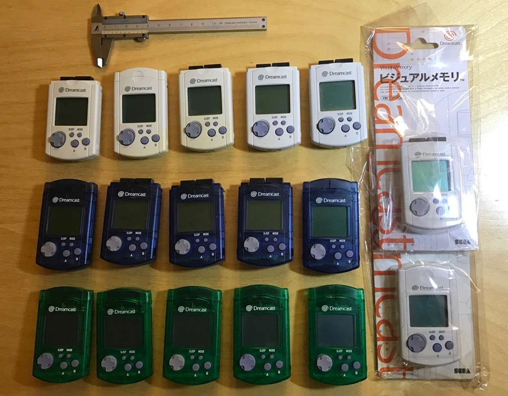

I've got extra VMUs last week. Some of them are missing the cap. Is this something we can easily design in 3D printer ?

Post by moosepr » Sat Apr 15, 2017 1:38 pm
That's a whole lot of vmu's!
Are you going into production?

satri360 wrote:
Sat Apr 15, 2017 10:39 am
Depending on the wall thickness, I shouldn't think it would be difficult. I'm a bit overwhelmed with work atm, but could take a crack at it in a couple weeks. I'll keep an eye out for an original cap and can probably duplicate it reasonably quickly. Or would you want to modify it for extra space?
Hehe. I start to collect all the variants of the VMUs but found red/black/godzilla versions are way too pricy. This should be good enough to play with casing and give pi-powered-vmu to friends eventually. ;)
That would be very nice if you can help duping the cap! The thickness is 1.50mm. Actually I need to remove the internal rib otherwise SD won't fit in the case.
