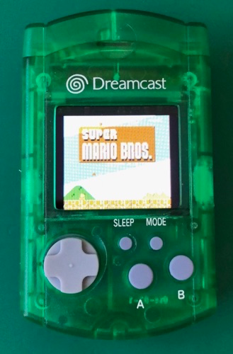

Dreamcast VMU Zero All-in-one
Post by satri360 » Sun Jan 28, 2018 9:11 pm

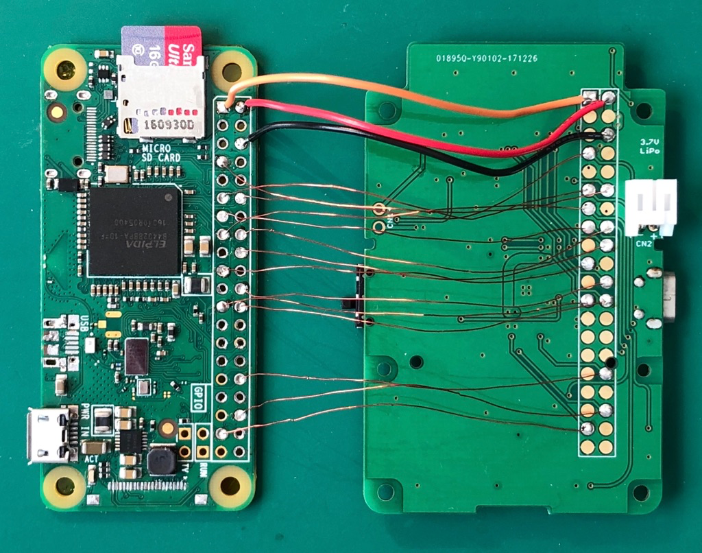

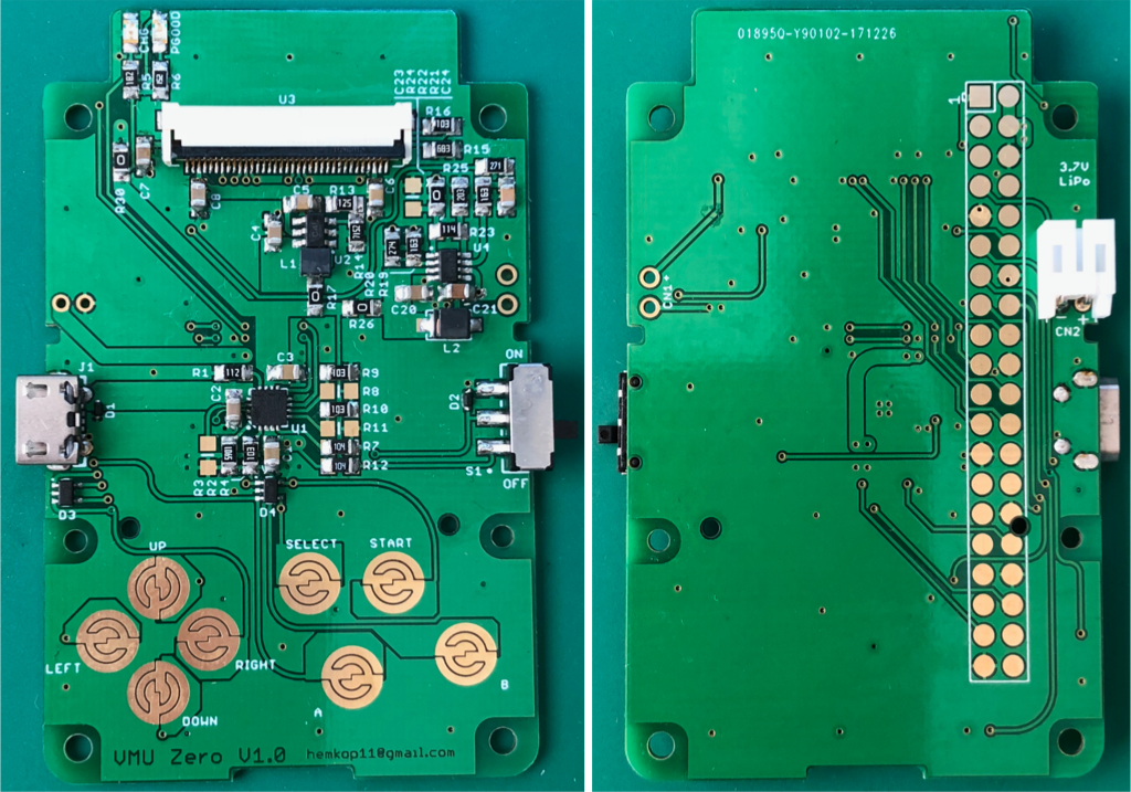

I put together the LiPo Charger and Boost DCDC for OLED from previous project in single PCB and added Amplifier for the original Piezo in the Sega Dreamcast VMU. Build instructions will be found at the very bottom of this post.
Schematics and Eagle CAD PCB File
Dreamcast VMU powered by Raspberry Pi Zero Project
FBDEV Driver for SEPS525/DD-160128FC OLED Module

Parts List:
  • Raspberry Pi Zero W
  • vmuzero_seps525 PCB (Available in $4.99 for PCB while supplies last ;) )
  • Some components BOM
  • 150mAh LiPo Battery
Schematics/PCB CAD files are uploaded in GitHub so you can build by yourself or buy from me for the first 8 orders. Just send me a PM if you are interested. Please note that components are not included and you need instruments to solder a QFN device.
All Sold Out. Wait for V2 PCB ;)

Nice work! Maybe some more pics t match the video?
Great to see another VMU build to kick-off 2018. Nice PCB, too and thanks for sharing :D

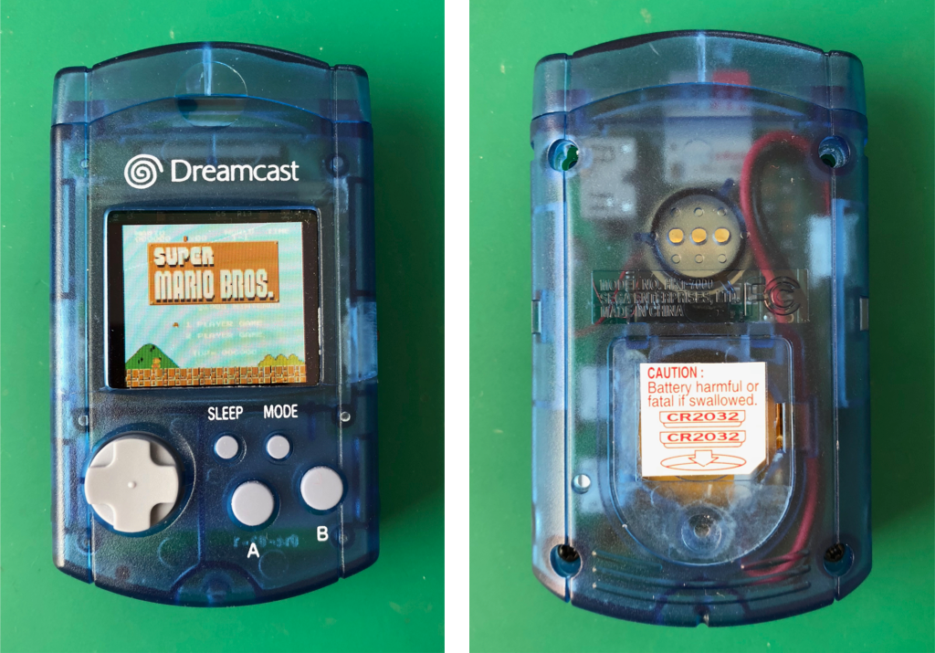

Post by Helder » Thu Feb 01, 2018 3:18 pm
How long does the battery last? and the gameplay video seems a little sluggish or is it just the way it looks because of the camera?
satri360
Posts: 45
Joined: Wed Mar 22, 2017 12:59 am
Has thanked: 10 times
Been thanked: 64 times
Re: Dreamcast VMU Zero All-in-one
Post by satri360 » Fri Feb 02, 2018 9:52 am
I measured average ~220mA at VBAT while running NES emulator on Zero W so theoretically it would only last 40min with 150mAh battery. We should be able to accommodate higher like 350mAh battery if we ripped the OTG and VBUS connectors.
Not sure about the sluggish performance but NTSC version of Super Mario Bros is probably slow like this video ?

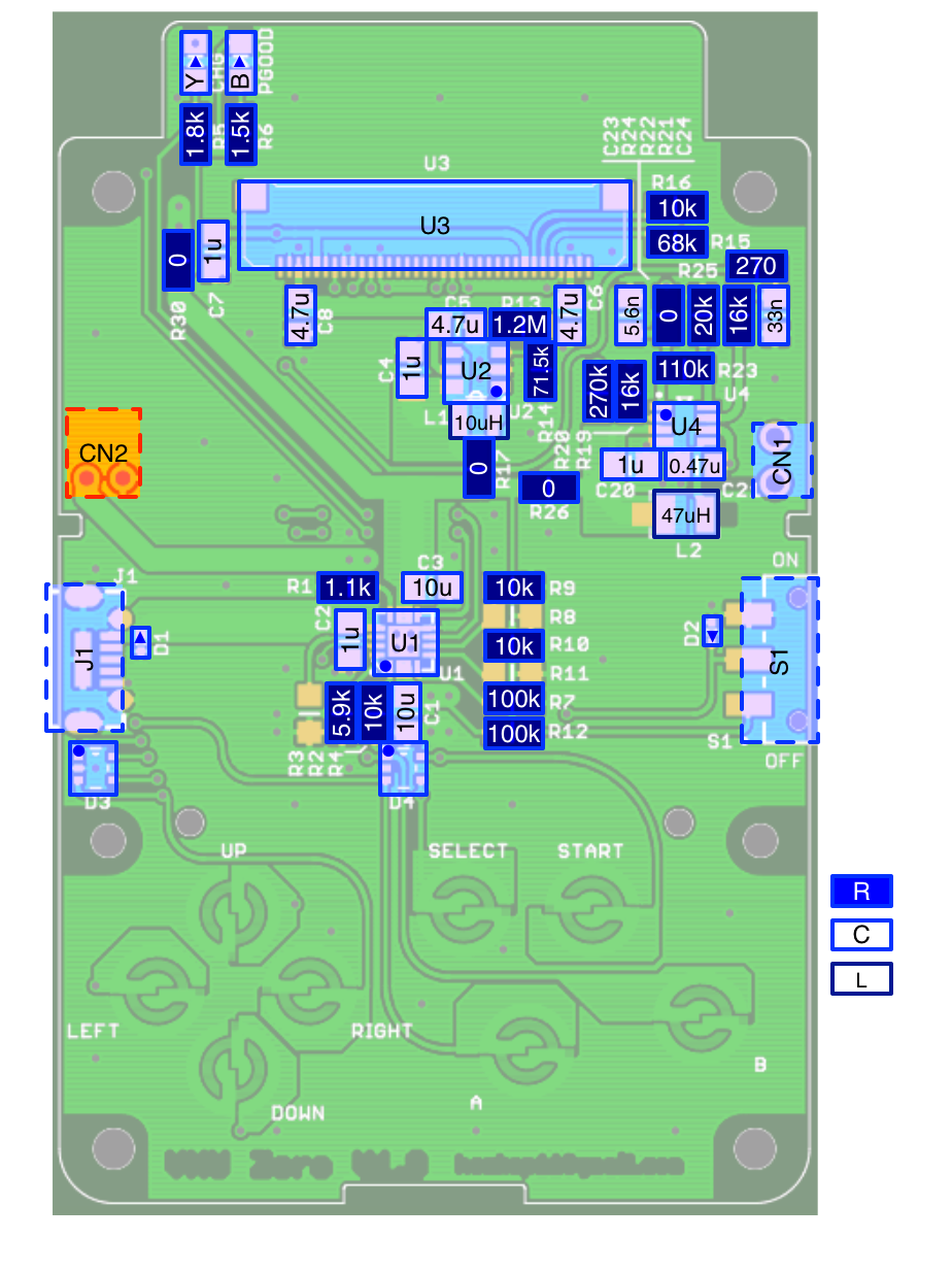

VMU Zero Build Instruction - PCB Assembly
(Skip to next step if you have pre-assmebled PCB)
Tools
Hot Plate
JBC CD1-BB Soldering Station
JBC C245-030 Conical Soldering Tip
JBC C245-768 Chisel Soldering Tip
ChipQuik SMD4300TF Tack Flux
ChipQuik SMD4300SNL10 Solder Paste
Senju ESC-M705-0.3 Solder Wire
Fluke VT04 Thermal IR Camera
Nikon SMZ Stereomicroscope
Parts
All of the parts but LT3469 Piezo Driver are available from DigiKey at the time of this writing. You can buy samples of LT3469 directly from Linear Technology.
BOMShow
https://github.com/satri360/vmuzero_sep ... 00_BOM.pdf
Part Value DIGIKEY MPN PACKAGE SUPPLIER Qty
C2, C4, C7, C20 1.0uF 490-11597-1-ND GRM21BR71C105KA01K 0805 (2012M) Murata 4
C1, C3 10uF 490-3340-1-ND GRM219R60J106KE19D 0805 (2012M) Murata 2
C21 0.47uF/35V 490-3328-1-ND GRM21BR71H474KA88L 0805 (2012M) Murata 1
C23 5.6nF 0805 (2012M) 1
C24 33n 490-12560-1-ND GRM219R71H333JA01D 0805 (2012M) Murata 1
C5, C6, C8 4.7uF/16V 490-3335-1-ND GRM21BR61E475KA12L 0805 (2012M) Murata 3
CN1 VMU Piezo 1
CN2 VBAT 455-1719-ND S2B-PH-K-S(LF)(SN) JST 1
D1, D2 SP1003-01 F3377CT-ND SP1003-01 SOD723 Littelfuse 2
D3, D4 SP1001-04J F2895CT-ND SP1001-04 SC70-5 Littelfuse 2
J1 USB_MICRO_B 102-4007-1-ND UJ2-MIBH-4-SMT CUI 1
L1 10uH 490-15888-1-ND LQH2HPZ100MJRL Murata 1
L2 47uH 490-2497-1-ND LQH32CN470K23L Murata 1
CHG YELLOW LED 754-1937-1-ND APT2012LSYCK/J3-PRV 0805 (2012M) Kingbright 1
PGOOD BLUE LED 754-1938-1-ND APT2012LVBC/D 0805 (2012M) Kingbright 1
R17, R24, R26, R30 0 RHM0.0CPTR-ND MCR10ERTJ000 0805 (2012M) Rohm 4
R25 270 0805 (2012M) 1
R1 1.1k 0805 (2012M) 1
R6 1.5k 0805 (2012M) 1
R5 1.8k 0805 (2012M) 1
R2 5.9k 311-5.90KCRCT-ND RC0805FR-075K9L 0805 (2012M) Yageo 1
R10, R16, R4, R9 10k 0805 (2012M) 4
R19, R21 16k 0805 (2012M) 2
R22 20k 0805 (2012M) 1
R15 68k 0805 (2012M) 1
R14 71.5k 1% 311-71.5KCRCT-ND RC0805FR-0771K5L 0805 (2012M) Yageo 1
R7, R12 100k 0805 (2012M) 2
R23 110k 0805 (2012M) 1
R20 270k 0805 (2012M) 1
R13 1.2M 1% 0805 (2012M) 1
S1 SPDT 401-1999-1-ND JS102011SAQN C&K 1
U1 BQ24075QRGTRQ1 296-38874-1-ND BQ24075RGTR QFN(16) Texas Instruments 1
U2 TLV61046ADBV 296-46927-1-ND TLV61046ADBVT SOT-23(6) Texas Instruments 1

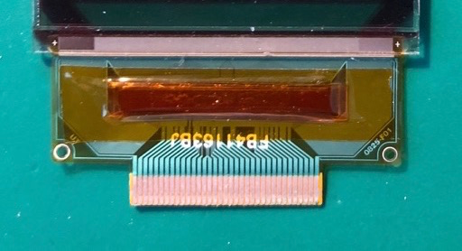

U3 DD-160128FC-2B OR727TR-ND XF2M-3515-1A Omron Electronics 1
U4 LT3469TS8 LT3469ETS8#TRMPBF LT3469ETS8 SOT-23(8) Linear Technology 1

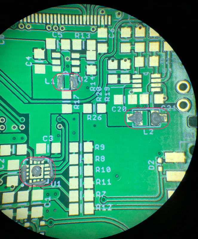

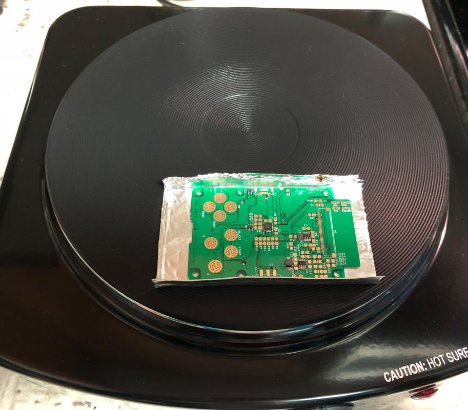

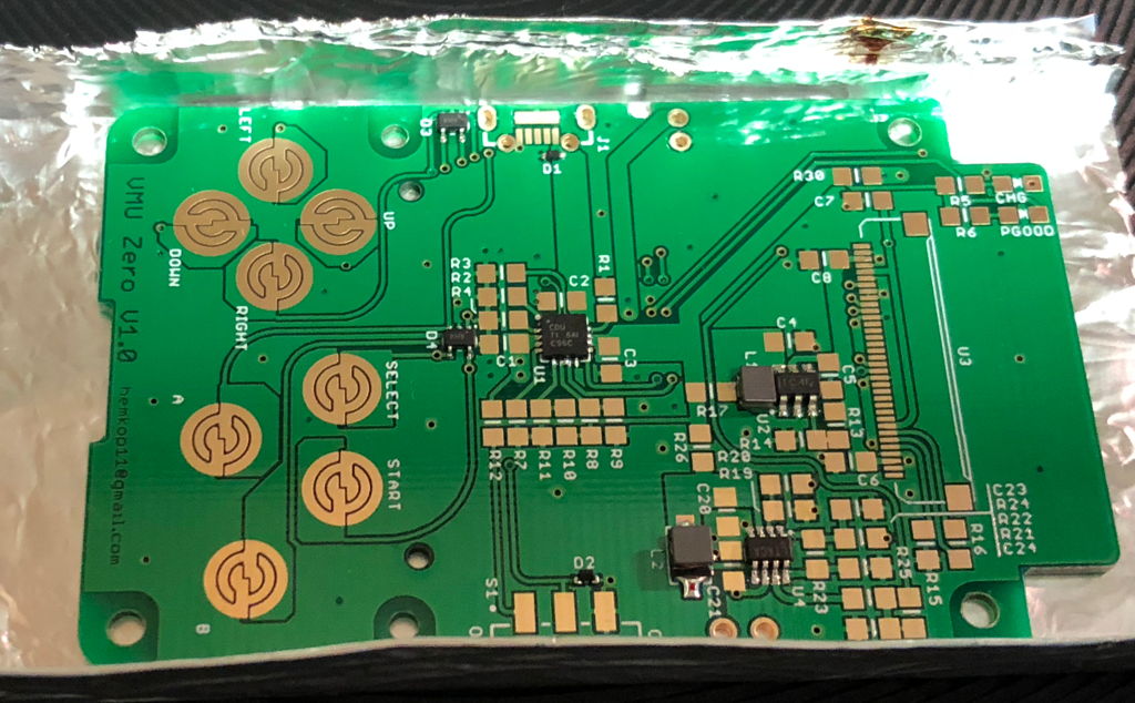

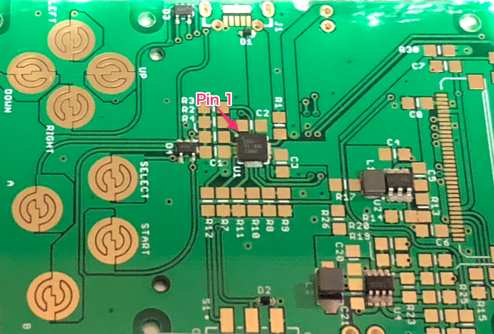

Reflow

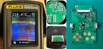

Apply a bit of solder paste on the pads of U1, L1, L2, D3 and D4. Optionally for D1, D2, U2, U4 and CN2.
ImageShow
Grab components with a tweezer and place them onto the PCB. Make sure to orient the U1 properly.
ImageShow
Position the PCB on the hot plate over the thick tinfoil as a heat spreader.
ImageShow

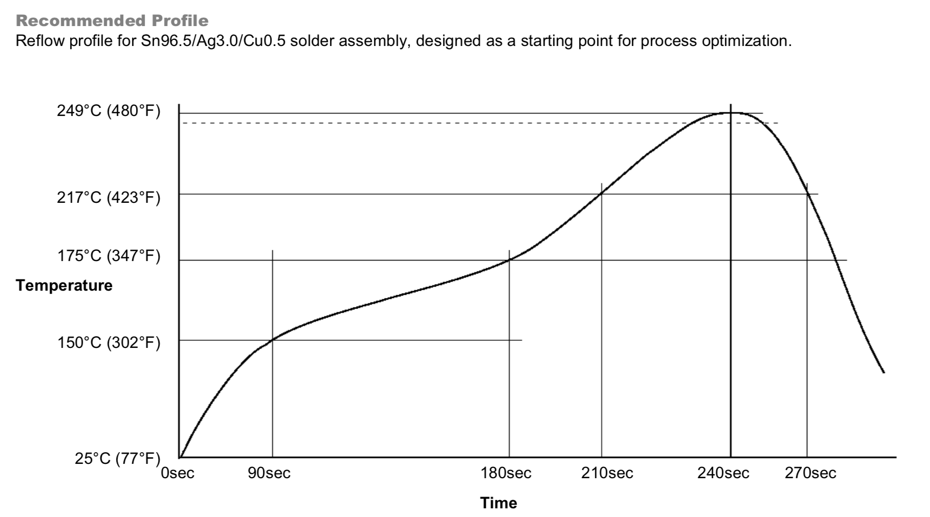

Cooking time! Turn on the hot plate and try to follow the recommended temperature profile of your solder paste.
SMD4300SNL10 Temperature ProfileShow
I heated it up to 180C in 3 minutes then 220C for the next 60s and hold for seconds. Thermal camera helped a lot to control the temperature. You should see solder paste turn shining silver when it starts melting. Do not heat too rapidly or parts would bounce up.
ImageShow
Cool it down. Be careful, PCB is extremely hot.
ImageShow

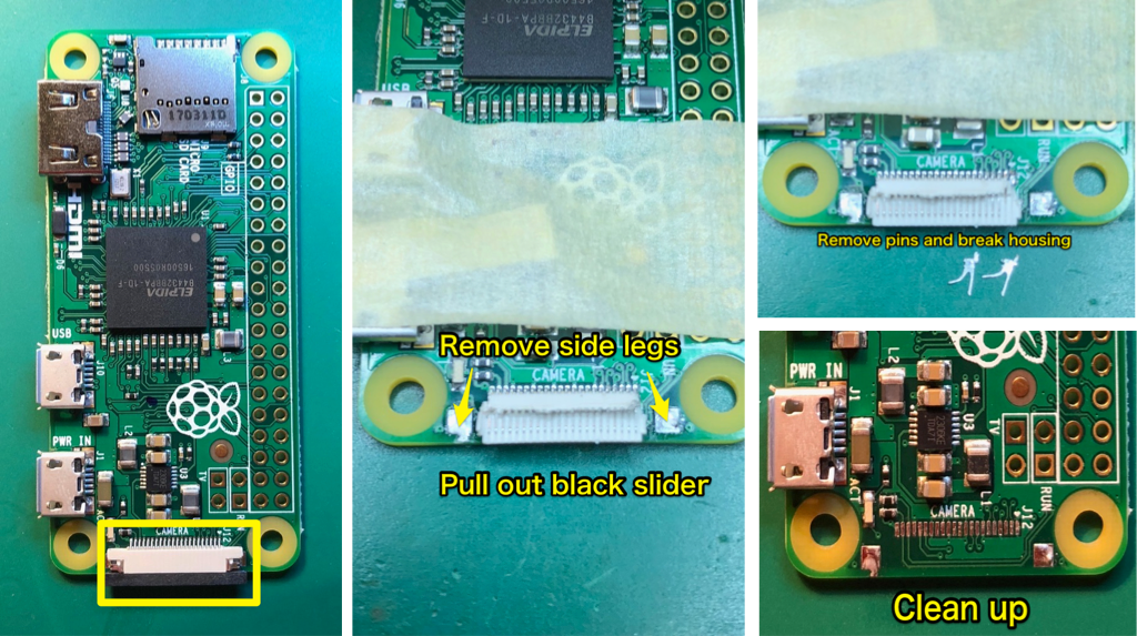

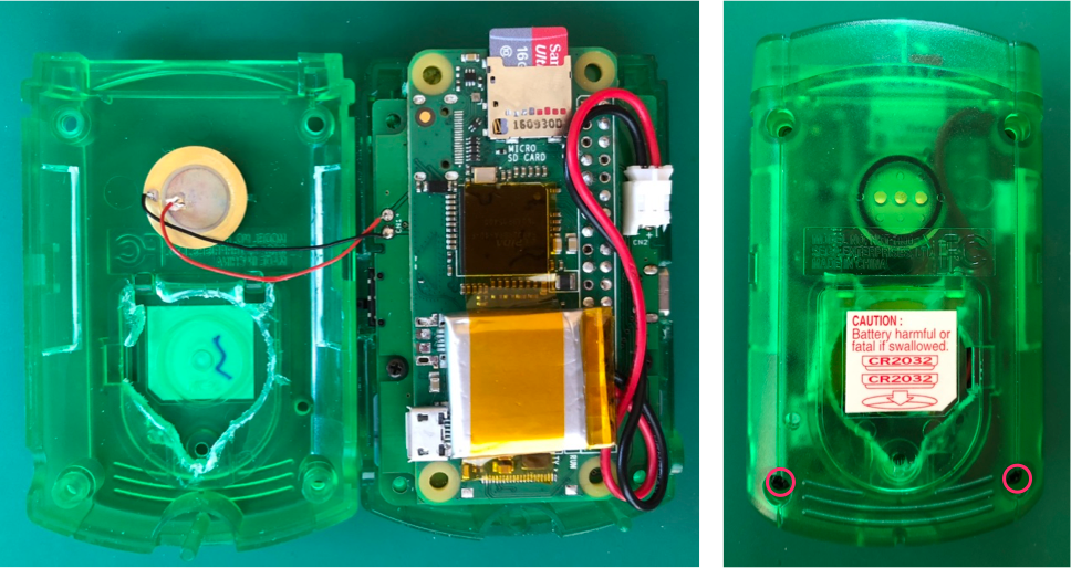

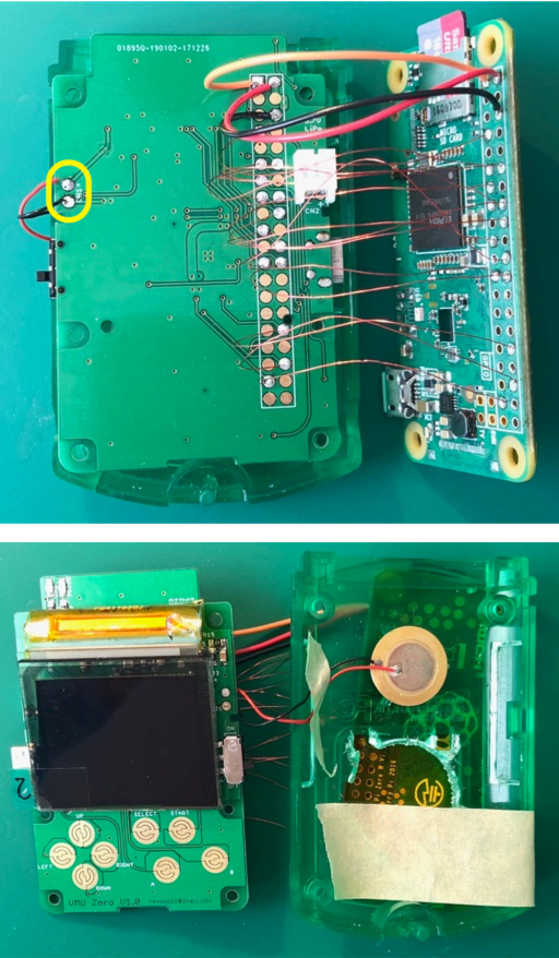

Assemble
Install the rest of the SMT parts. Start with the U3 FPC connector then solder other parts on the top in order of increasing size.
PCB AssemblyShow
Finally install the CN2 battery connector on the bottom side. We will solder the piezo speaker from the VMU to CN1 later.

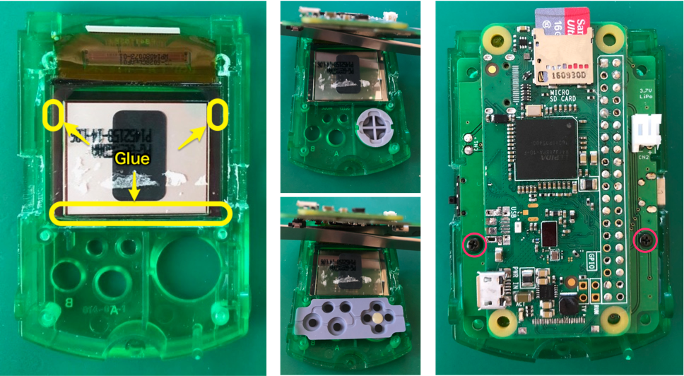

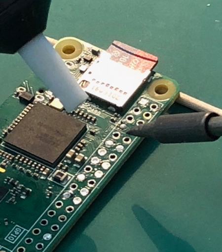

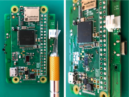

VMU Zero Build Instruction - Modifying VMU
Tools
Screw Driver
Side Plier
7mm Flat File
XACT Knife
Air Duster

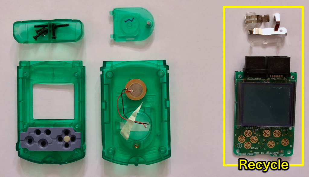

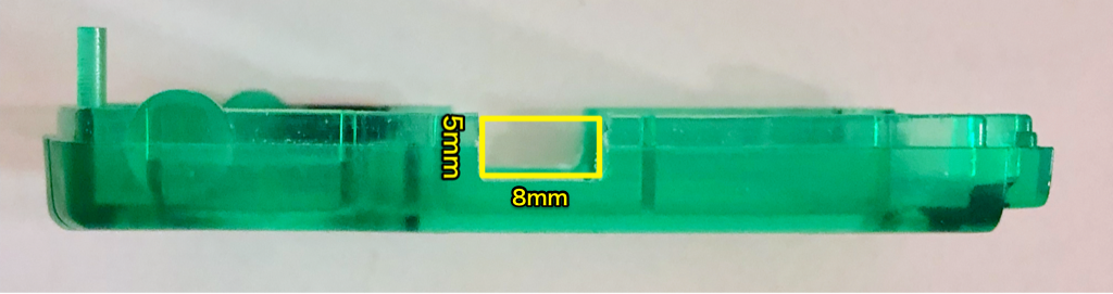

Disassemble VMU
Strip down the VMU and keep everything but the PCB, coin cell and display.
Try not to touch the piezo speaker to prevent fingerprints on the disc.

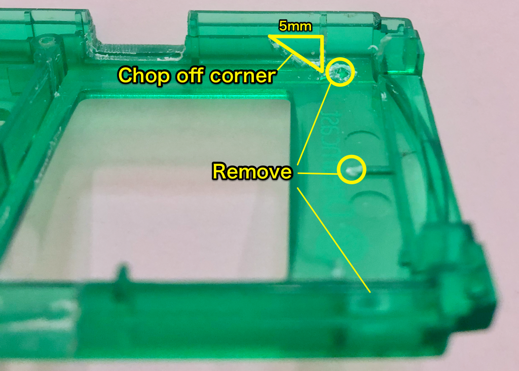

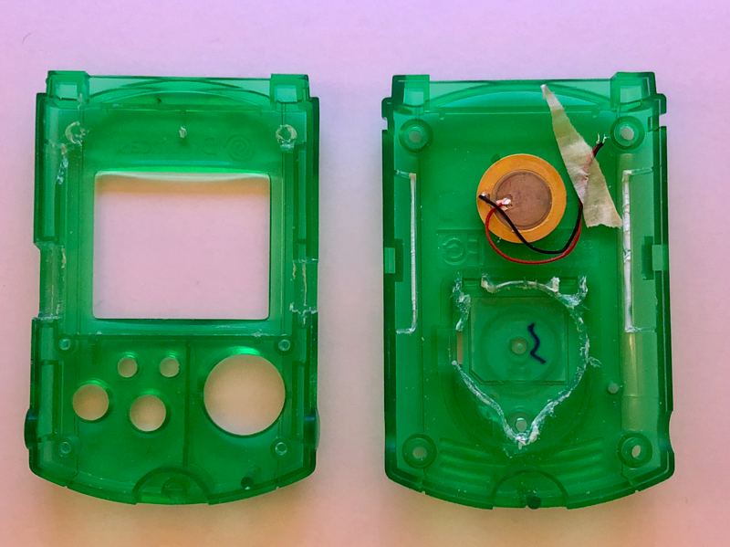

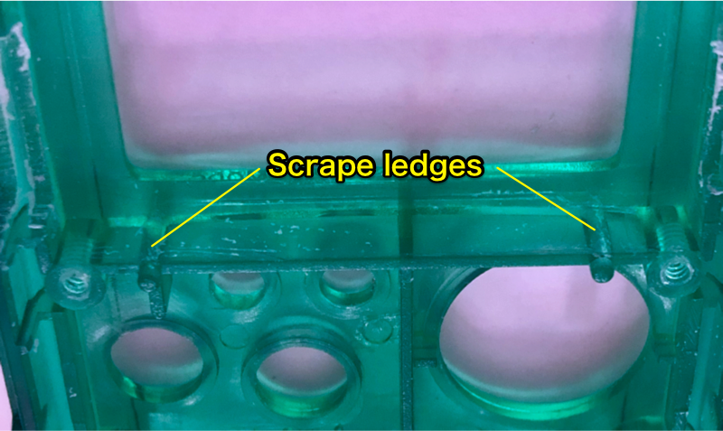

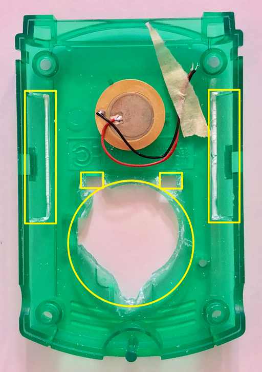

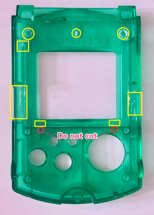

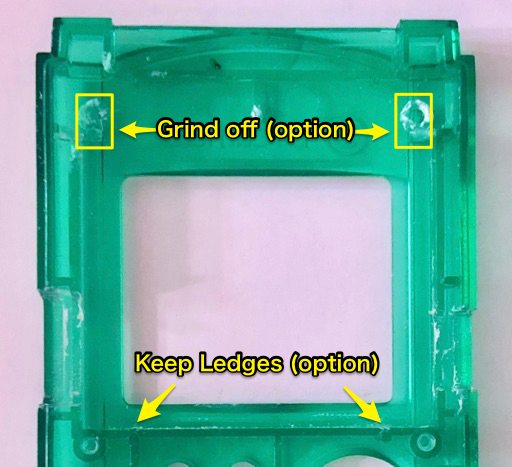

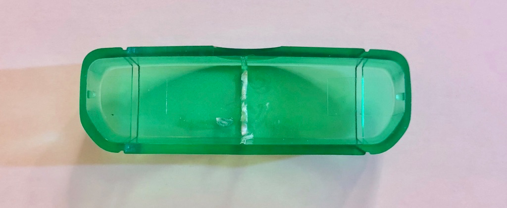

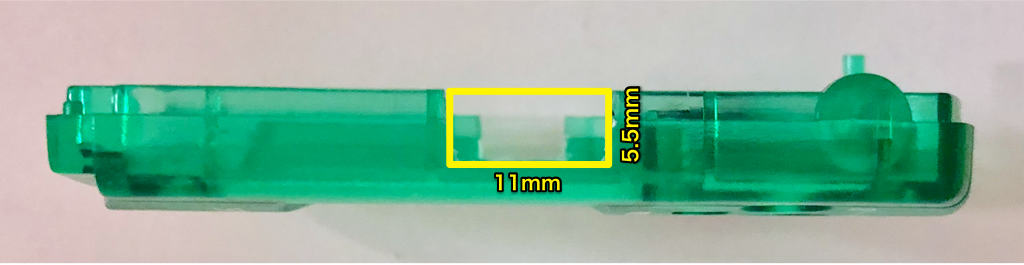

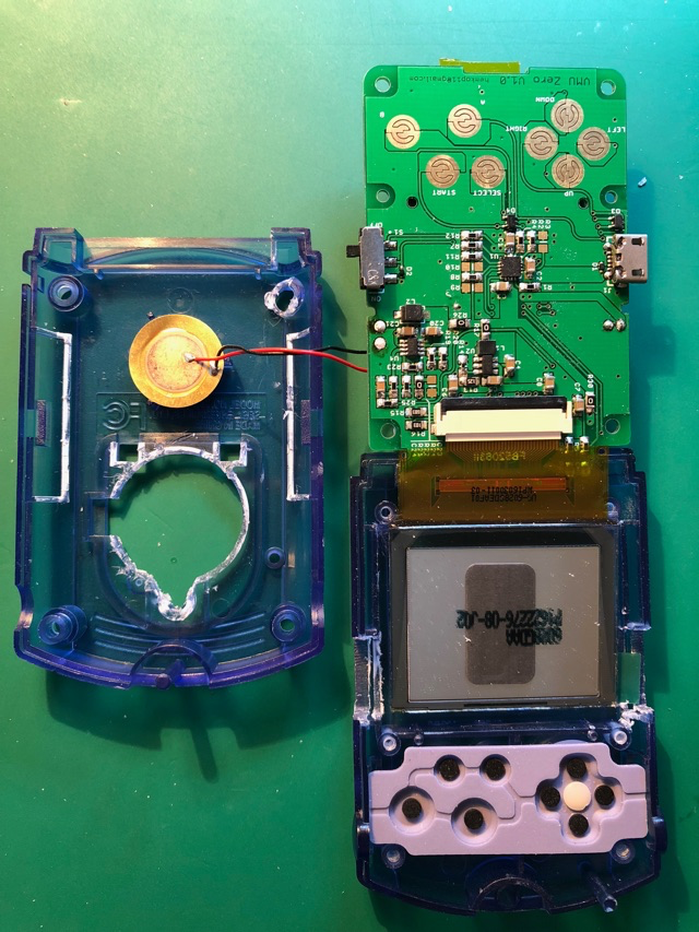

Modify Case
Use plier and flat file to make some changes to the case.
TopShow
Top LeftShow
Top RightShow
Top CenterShow
Alternatively you may keep the ledges and scrape the upper walls to fit the display nicely in the center.
Top UpperShow
BottomShow
LidShow
History

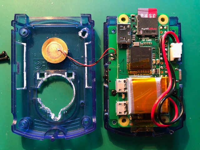

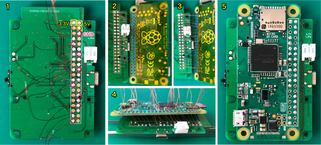

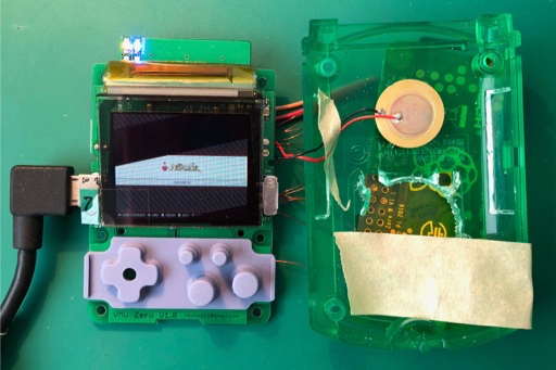

VMU Zero Build Instruction - Final Assembly
Tools
Desoldering Wick
Desoldering Pump
Parts
Assembled PCB
Modified VMU Case
OLED Display
Raspberry Pi Zero W
150mAh LiPo Battery
AWG34 Enameled Wire
AWG28 Stranded Wire
Reworks

Tape Display Controller (optional)Show
The display controller occasionally failed to perform an analog reset under very bright circumstances. I have reduced the reset period to overcome this problem but you may still observe the black screen if this happens. Shade the controller in hopes of resolving this issue or you can cover it by hand during boot.
Remove Camera ConnectorShow
Desolder the camera connector using solder iron and plier.
Pre-assembly Test
Semi assemble and check the basic functions.
Wiring PCB and PiShow
Prepare 5cm of 3x AWG28 stranded wires and 14x AWG34 enamel coated wires. Solder wires to connect the pads of Pi and the PCB. Leave some ground pads at this time to save some time.
#1 Power 3.3V (AWG28 orange)
#2 Power 5V (AWG28 red)
#6 Power GND (AWG28 black)
#7 Key_A
#11 Key_LEFT
#12 PWM0
#13 Key_Down
#15 Key_Right
#16 Key_Up
#18 OLED_Reset
#19 OLED_MOSI
#22 OLED_DC
#23 OLED_SCK
#24 OLED_CS
#32 Key_B
#36 Key_Select
#37 Key_Start
(Note: HDMI and OTG connectors are removed in this image but it is not required for this project)
Speaker and DisplayShow
Solder the speaker wires to the PCB. Flip the PCB and attach the OLED FPC.
Double check all the wire connections before powering up the unit.
Power On ⚡Show
Attach 1A or higher USB power cable to the PCB. It will power up the unit regardless of the position of the slide switch as it only controls the battery. First, check the green LED flashing on the Pi.
You should see the RetroPie splash screen if everything goes well. Place the rubber pad on the PCB and press any key to start the configurations. Press UP, DOWN, LEFT, RIGHT, START, SELECT, A, B then hold A to skip the rest. Copy your favorite ROMs to the Pi and play some games to check the audio.
Unwiring PCB and PiShow
Use desoldering wick and pump to unsolder the pads on the Pi.
Assembly
Solder the Pi to the PCB and fit everything in the VMU. You are almost there.
Bonding PCB and PiShow
Remove the speaker and display. Unsolder the 3 power wires from the PCB and replace with AWG34. Wire all GND pads #9, #25, #39, #6, #14, #20, #30, #34 with the same AWG34. These wires will work as a core when soldered the PCB down to the Pi.
Thread wires to the header of the Pi. Start from the of row closer to the edge then finish the other. Slowly pull up the wires through the Pi all the way till the Pi touches the PCB. Cut the wires right above the Pi and solder them down.
Again HDMI and OTG connectors are removed in this image but it is not required for this project.
Rework JSTShow
Cut the side wall of the CN2 battery connector to avoid it hitting the VMU.
Fixing Display and PCBShow
Glue the OLED to the case. Place the directional key support and rubber pads. Carefully insert the Display FPC to the PCB. Align the PCB to the VMU by matching the 2 notches on the PCB to the protrusions of the VMU case. Screw down the PCB to the case.
CompleteShow
Wire the speaker to CN1 and attach the battery to CN2. Try to find a place for the battery wires and close the case. Screw the case at the lower holes. Close the lid.
Slide the side switch to On position and enjoy the game 🎮
