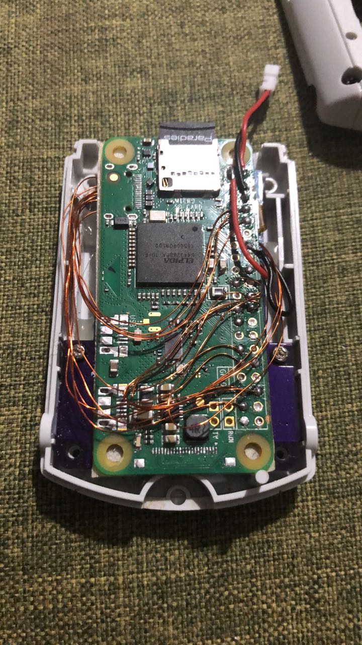

after messing with satri360's board for a while I now want to start my own build.
I really like it, it works just fine and I fitted a 800mAh battery inside, as well as magnets to keep the lid closed.
Picture of VMU with Satri360's boardShow

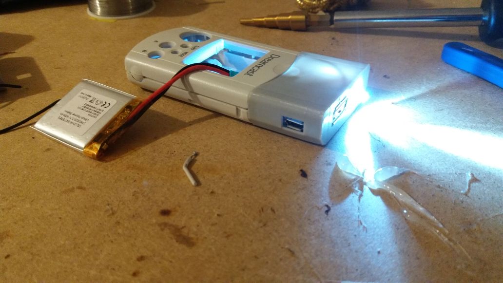

But I have some issues with charging batteries - it only does so while its on and it has issues charging the large battery - I can only get ~15 minutes of use charging it over night through the vmu and about 4 hours charging it externally.

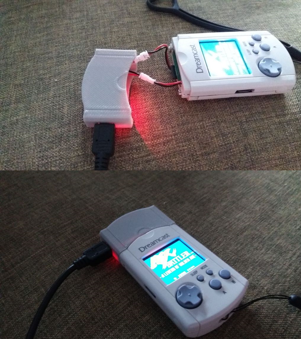

Thats why I build my first module today:
Picture of charging moduleShow
Now I can play through usb and charge at the same time at full speed as well as charging while it is off. The module can be removed of course and the VMU works just fine without it. It even comes with a built in flashlight as well as USB out to use it as an emergency battery bank!

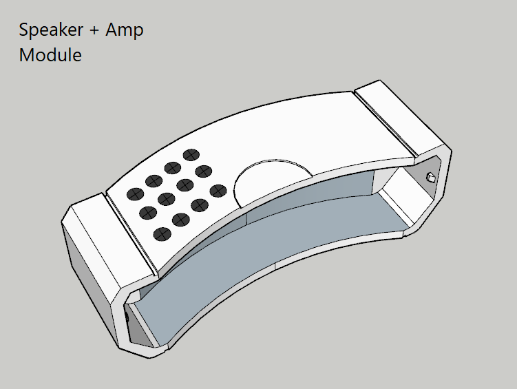

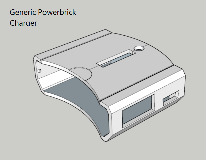

As for modules:
- Charger Module (lipo + boost + switch), attach to recharge the battery and play from usb power
- Audio Module (amp + good speaker), attach to have better audio than the tiny internal speaker

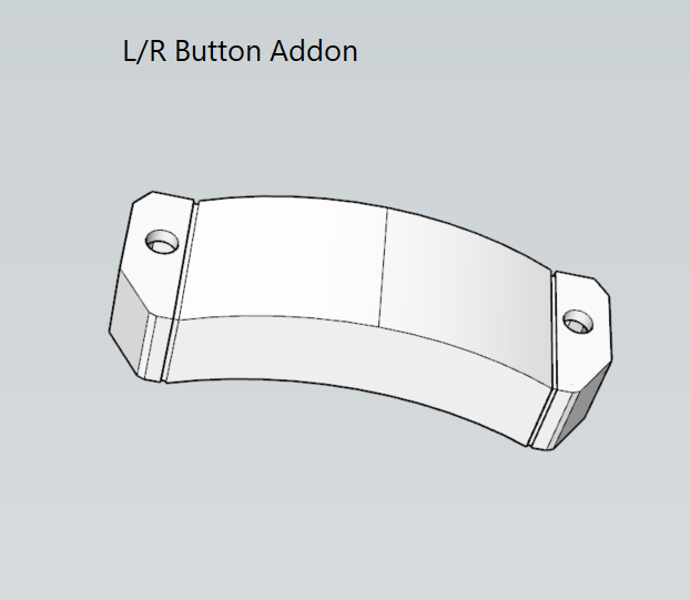

- Small L/R Module (just 2 buttons), attach to play snes/gba games
MockupsShow
What do you think, any other ideas for modules?

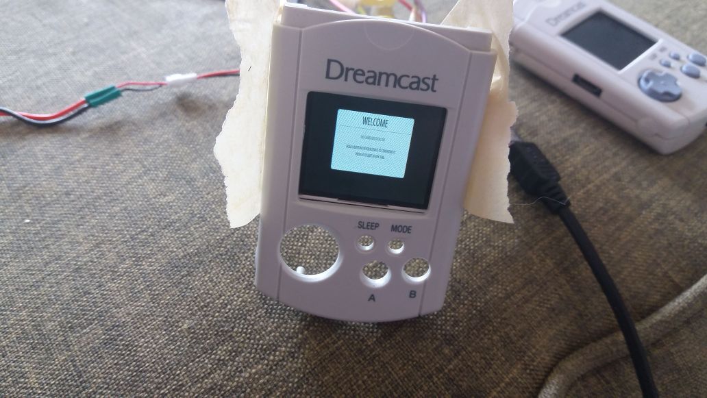

ScreenShow

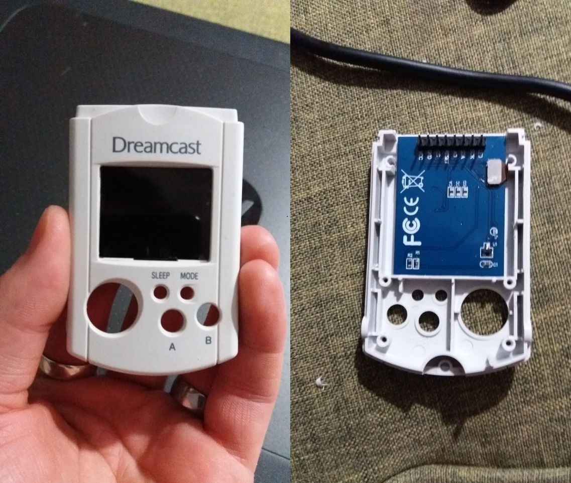

Thanks to a lot of help from moosepr I got the display working nicely.
It looks soo sharp in comparison.

- got the chargers for the charging modules, it doesn't even need the boosters, the PI runs just fine from the modules output (which is = battery voltage) but I will add them anyway
- before I can do the last case modifications to move the display lower I will need the button PCB's to see how much room I have for that, they should arrive next week
- I already started designing a nice tiny bracket for the screen and the PI so I don't have to glue anything in
- ordered a bit thicker magnetwire for the power lines
- ATiny's arrived, waiting for the programmer to do the lipo battery indicator
ScreenShow

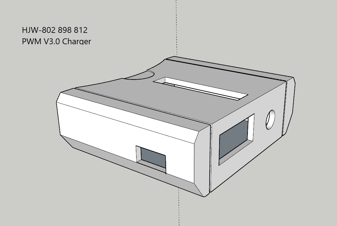

While I wait I printed a new charger for satri's board.
On my build I will have 2 x 2Pin JST for bat out and 5v in (to charge and play from the charge module or to directly connect to play from battery only) as well as a 10Pin JST to expose interesting pins from the PI (like GPIOS, analog video, usb or pwm audio).
This one only has the charger and no boost (it connects to the bat on satris board), the switch from his board works just fine with it. The one for my build will have an additional switch and maybe even the safe shutdown logic.
PictureShow

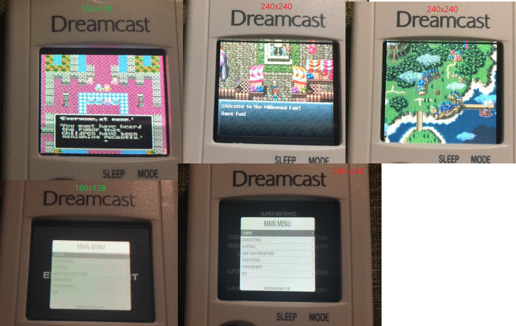

smoki86
Posts: 97
Been thanked: 47 times
Re: Modular VMU

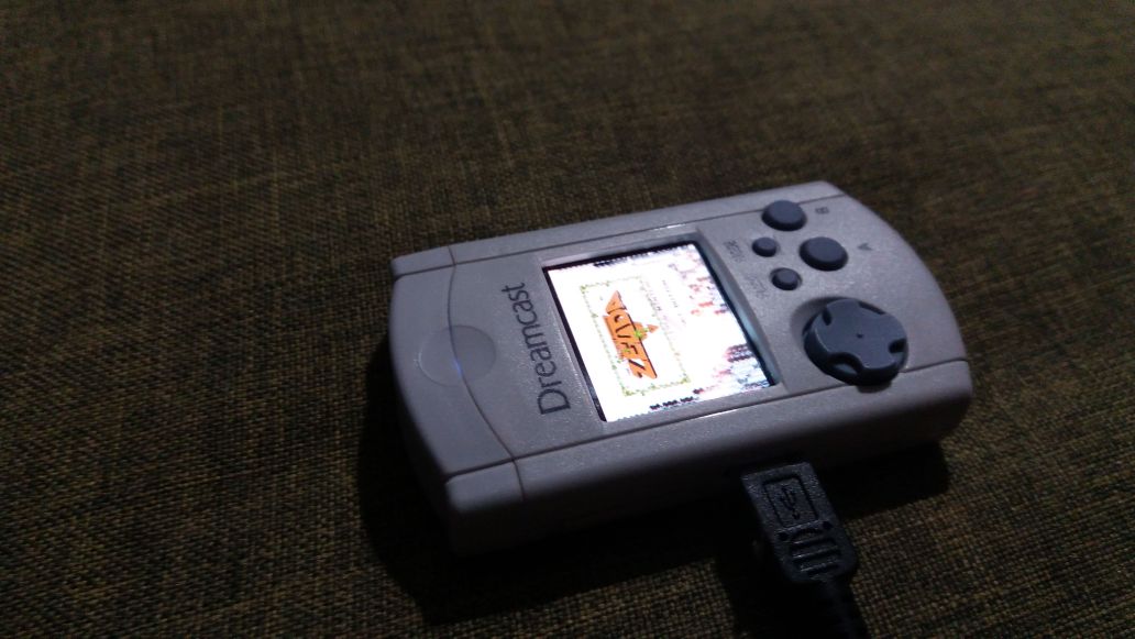

Post by smoki86 » Tue Apr 17, 2018 11:02 pm
More progress :)

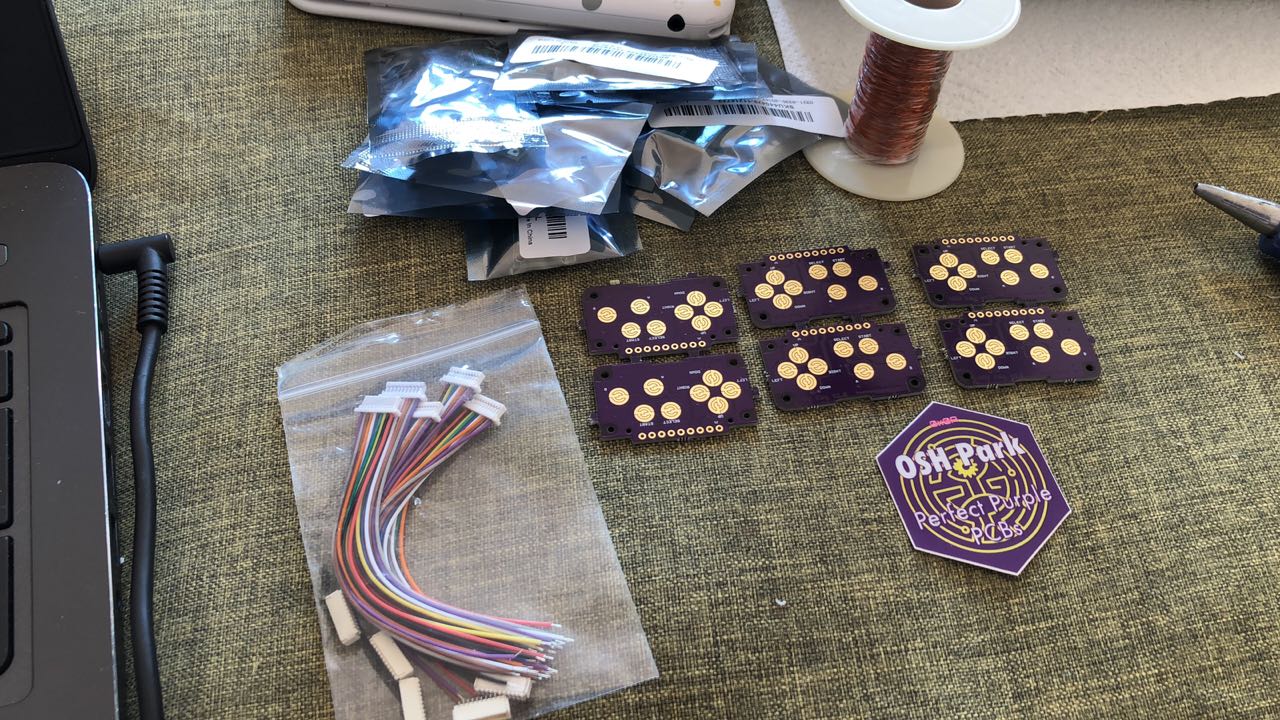

- boards are here!
- build a 'mvp' with no sound, small battery, external charging as a first step

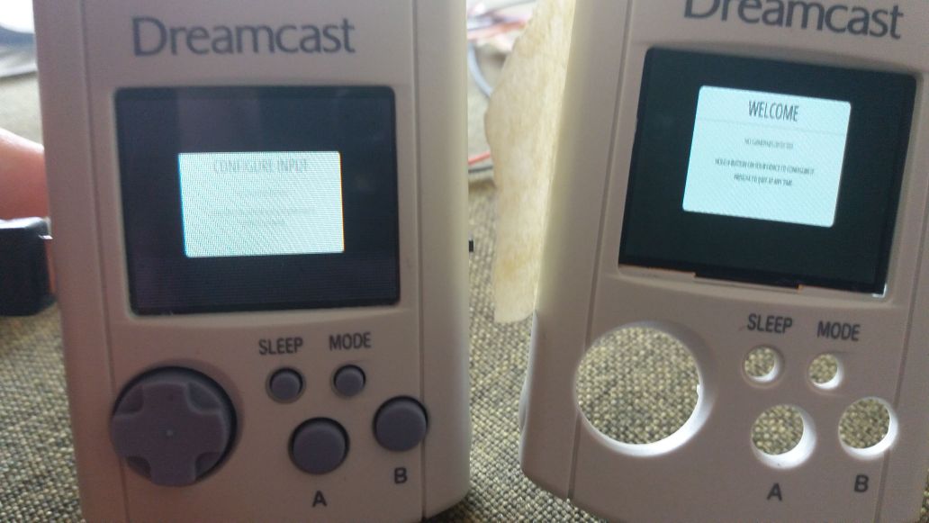

- screen is perfect, faster and so much sharper than the old one
- just 2 very tiny bars left and right because the screen is not just as wide as the vmu screen
Pics!Show
