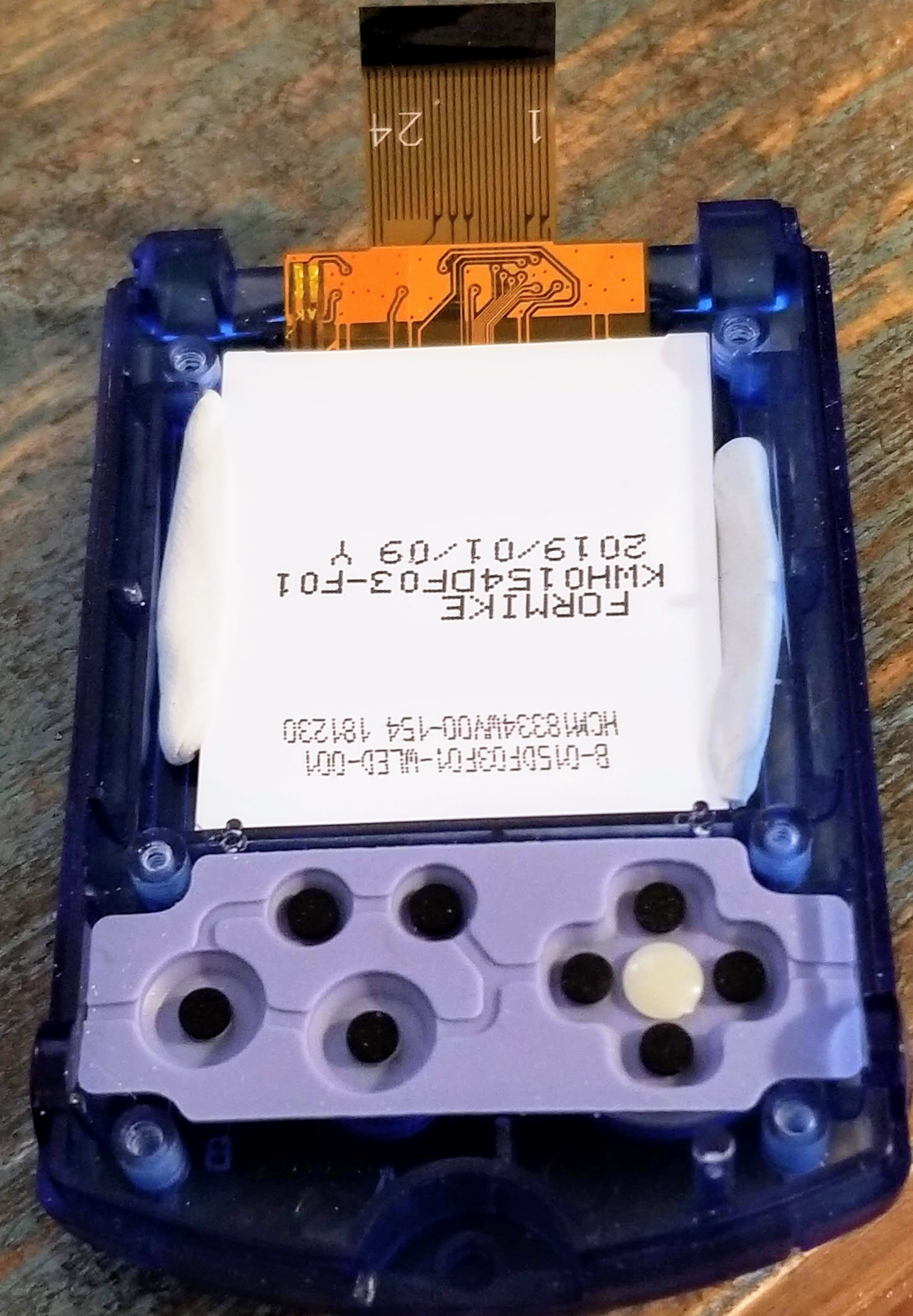

Case prepped. The plastic was softer than I expected. Flush cutters did the whole job. I did end up needing to trim the side walls on the back piece as well later.

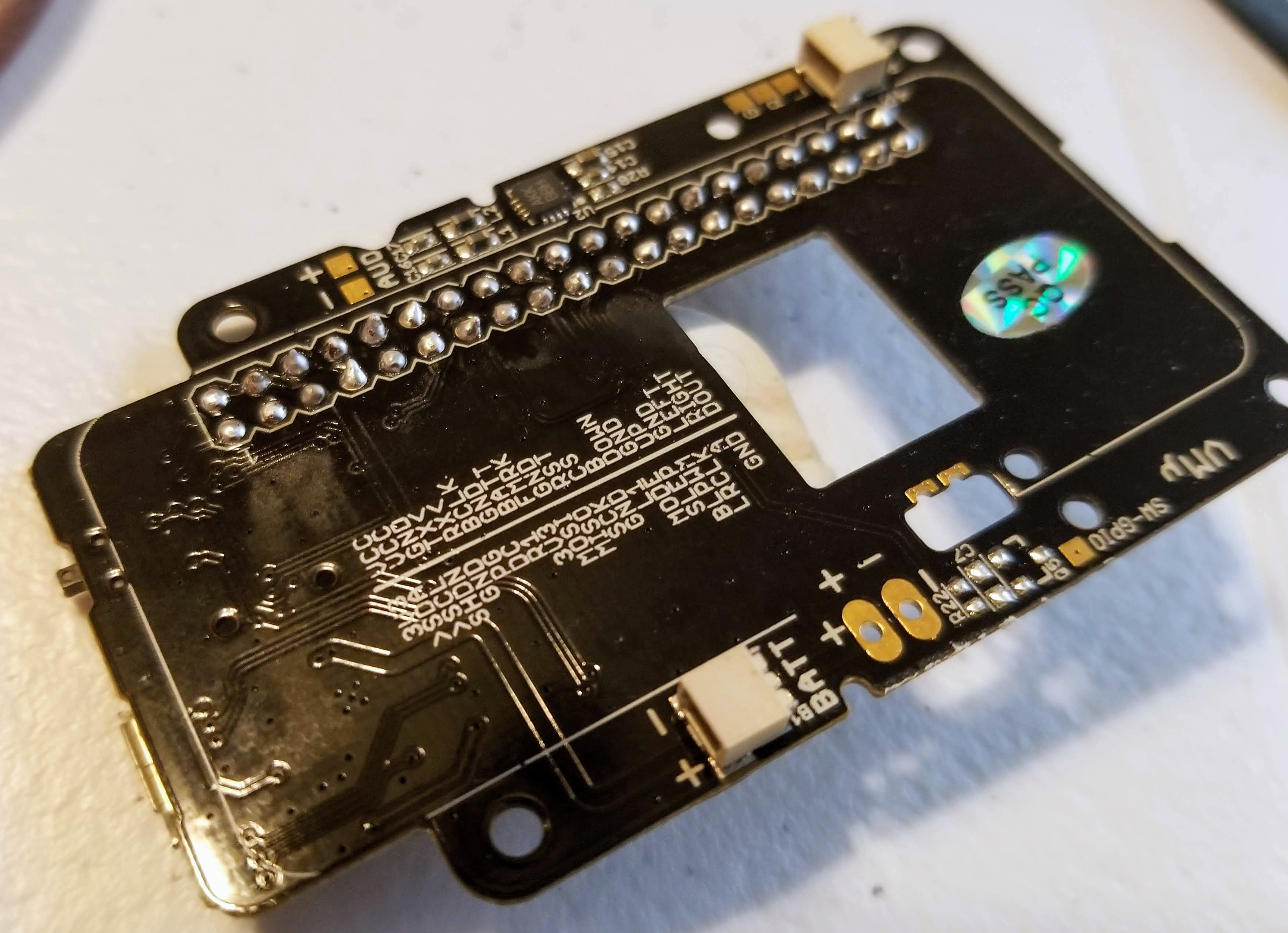

First batch of soldering done. Thank goodness for all the test pads on the back. Out of 40 pins I had to redo 8.

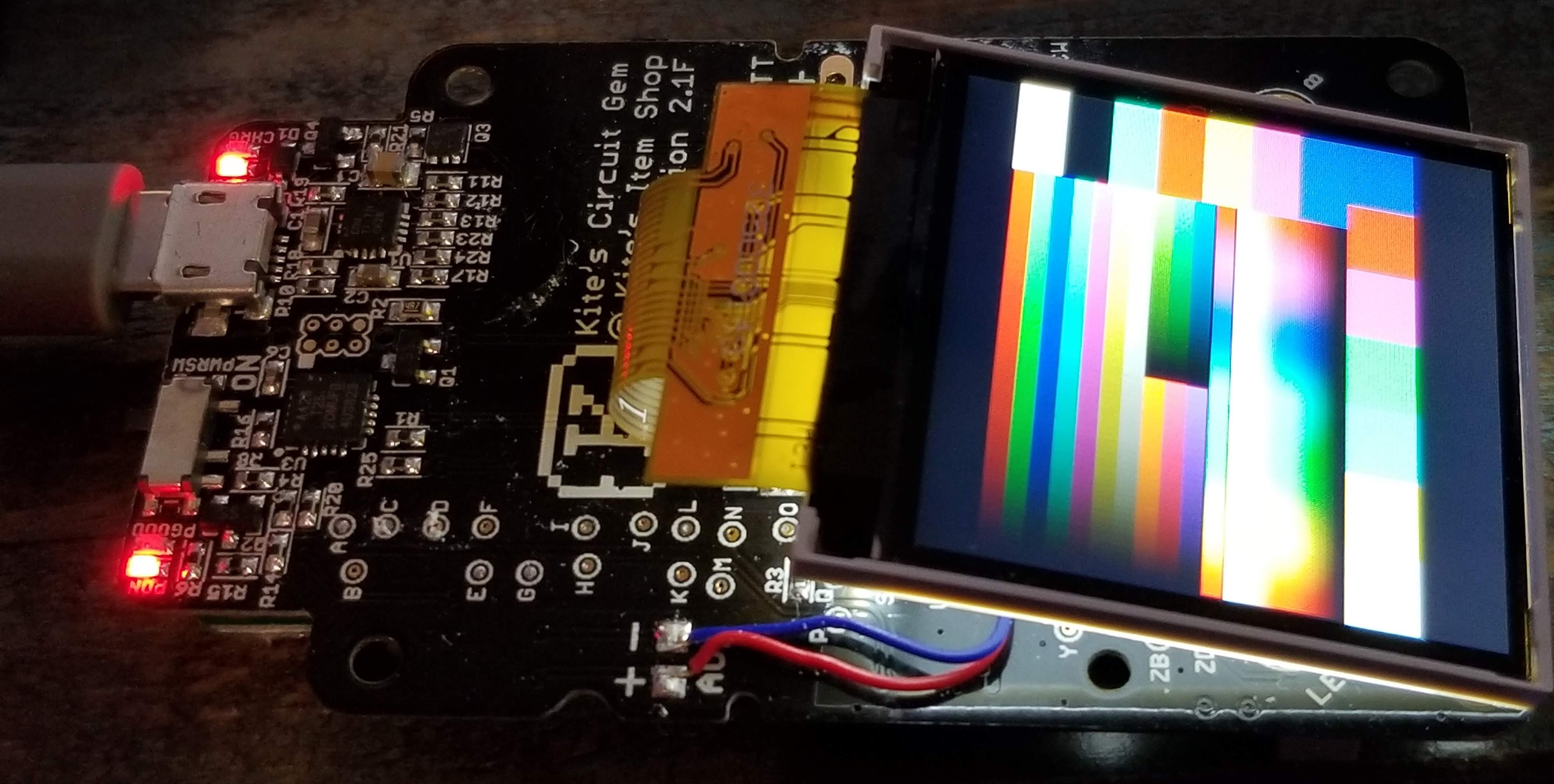

Screen in.

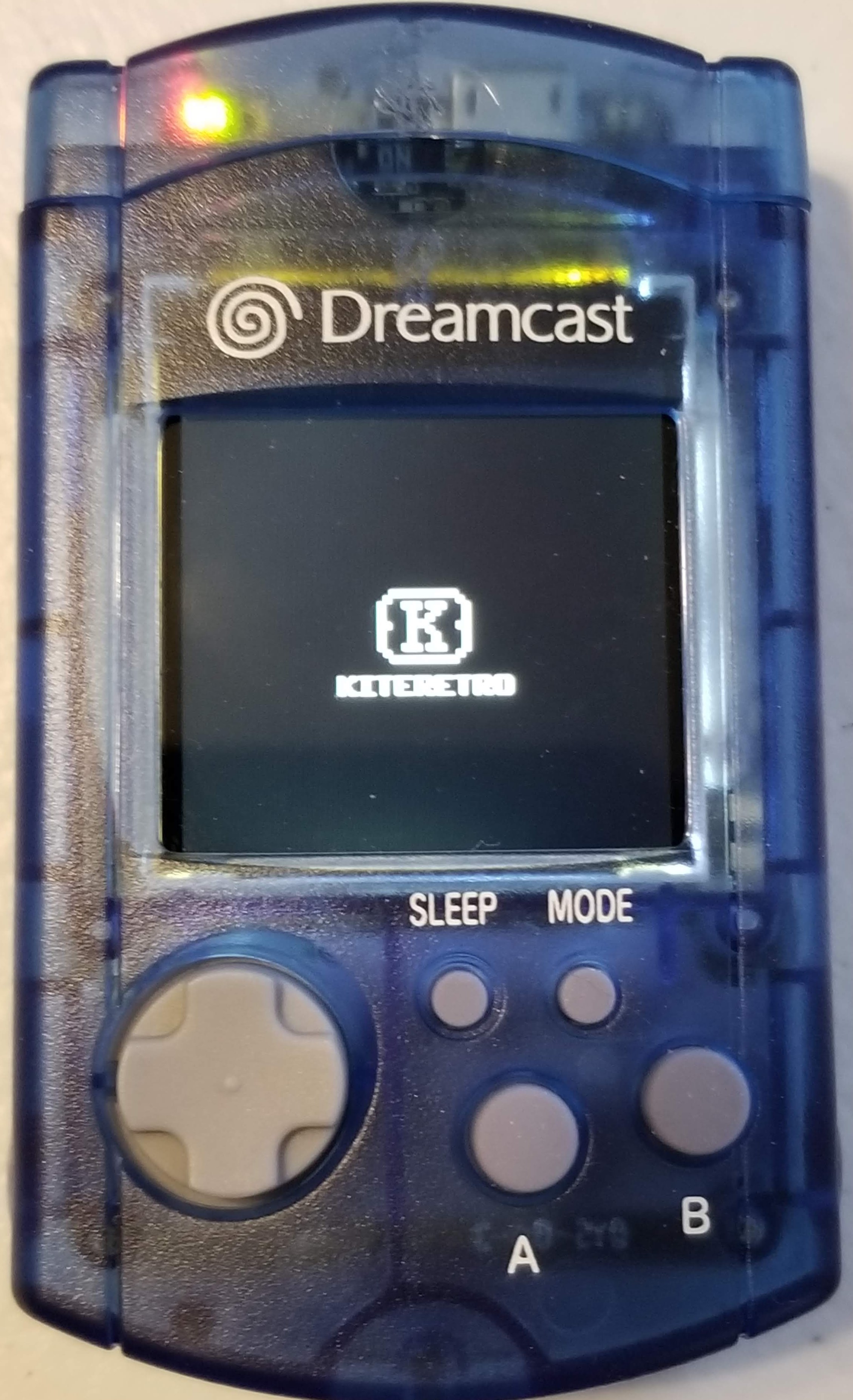

Test boot.

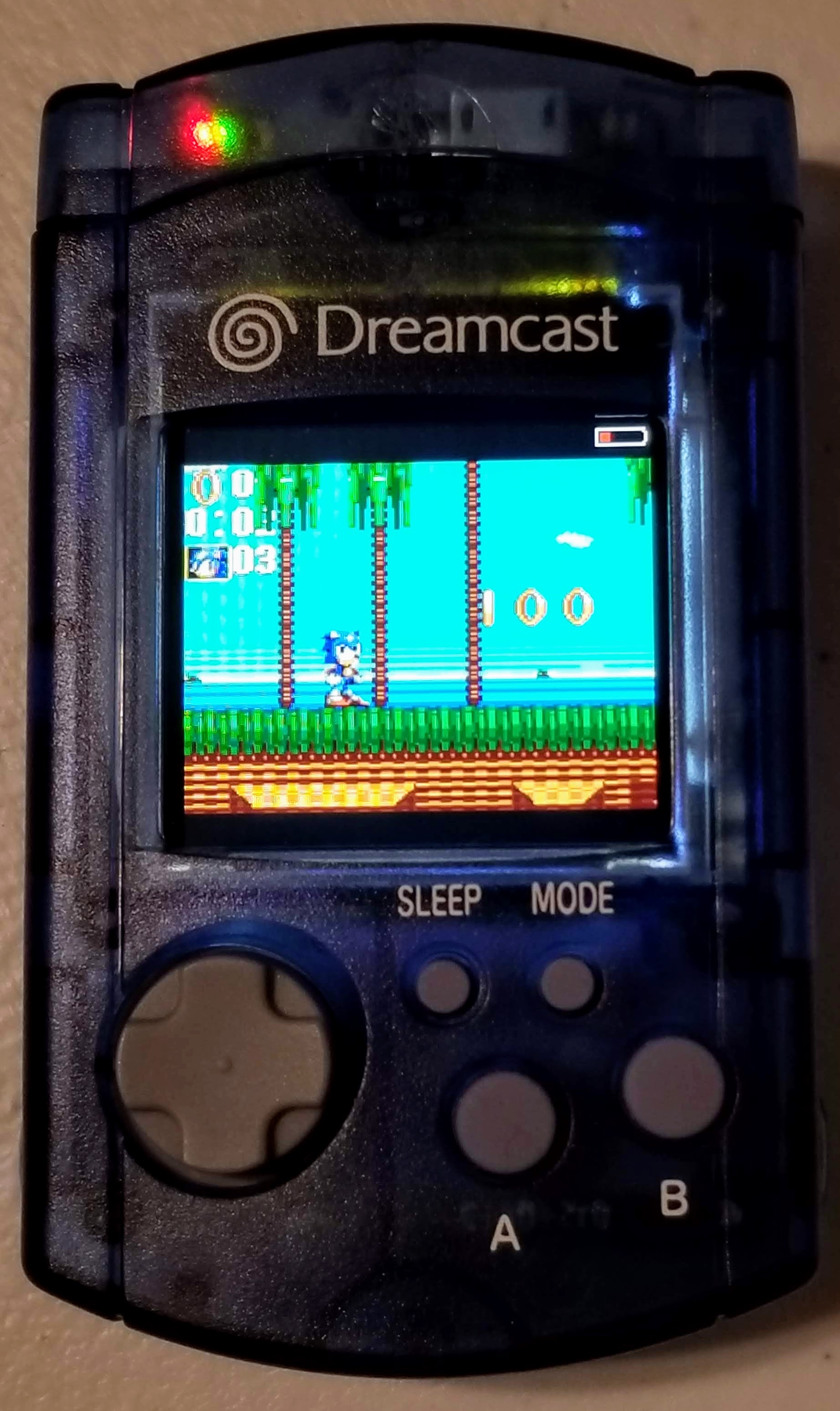

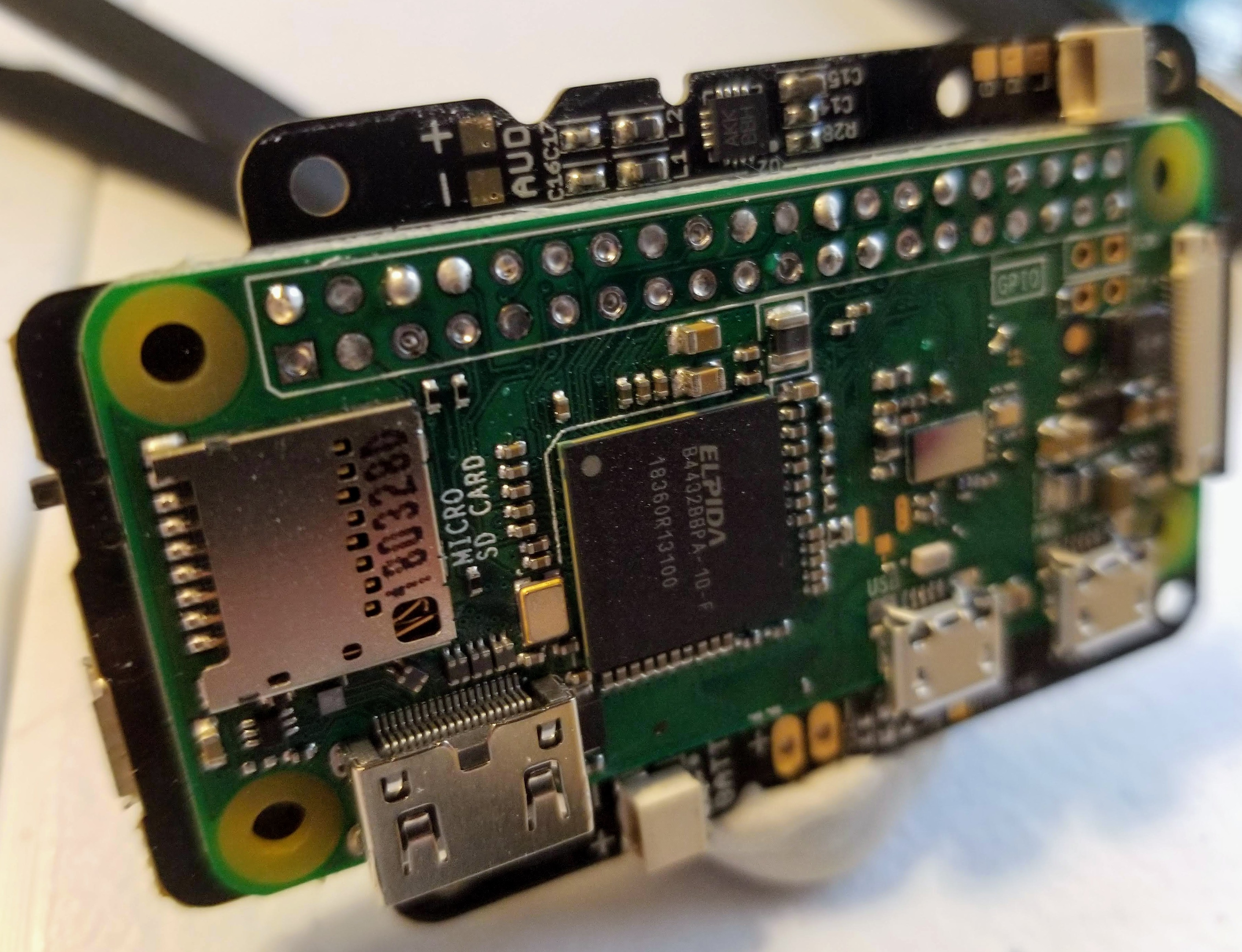

All closed. Tight fit but I removed nothing from the zerow. I used a small 350 battery.
Edit:
Software was very easy to setup. Writing all the WiFi info in ahead of time like the wiki suggested meant I never even needed to plug in a keyboard. I am damn impressed with the pre configured image. This was a fun project.

Nice work. Did you remove the usb and hdmi ports?

Silly question but I couldn't figure out where the test pads for about a dozen points were. I have seen the diagram but for example, for LCD DC, it's point J but uh where is the partner pad? I don't see it anywhere on the PCB. Same with the other LCD, also BATT MON, TXD, RXD, etc. Any help would be appreciated.

Nope. I removed nothing.
J is pin 13 on the pi header. https://github.com/kiteretro/Circuit-Ge ... it-Gem-FAQ So you touch the test pads and pins on the corresponding header on the other side. It’s rather awkward but invaluable.

Hi, I understand that J = 13 but where is LCD DC?
They are alphabetical ordered vertically, so follow the test points down. J is to the bottom left of the [K] logo on the front, under 'I' and above 'L'
