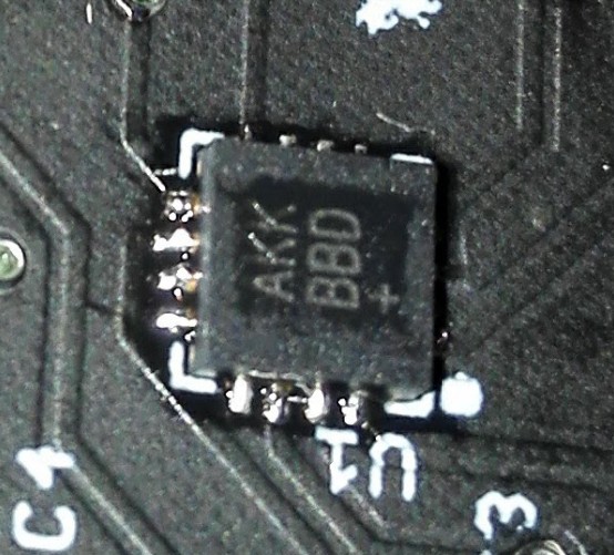

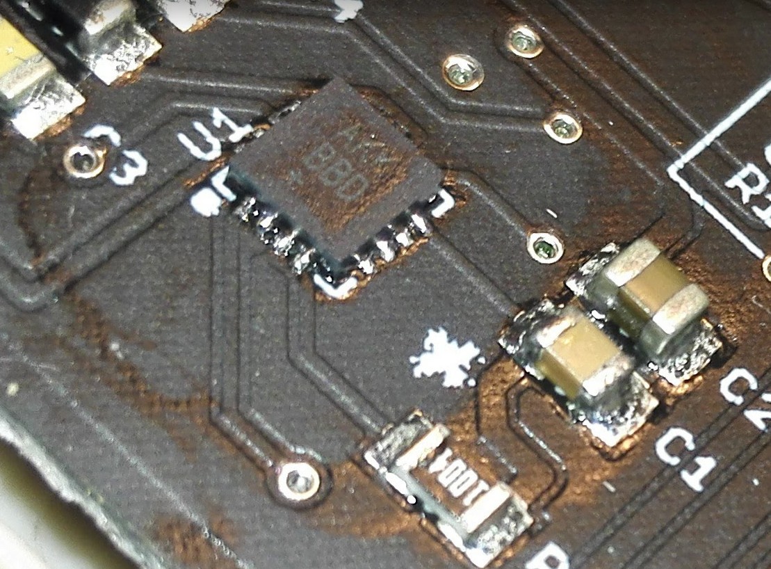

Tried reflowing your audio related components? And make sure the audio is turned upon alsa

I don't think I'm capable of soldering something this tiny. Therefore I bought a Kit and not just the PCB.
I've checked retropie and raspi settings, should be on everywhere. It's everywhere set to 100%.
I don't know what's the right setting, but the image came preset with PCM.
The other two options didn't work either.

Ok, I just did it. Used my phone as a magnifier.
Looks to me like everything is solderer as before, just more solder.
The resistors and capacitors around are looking good to me.
Still, no Sound.
Can anybody with a working PocketPi tell me which settings for audio are the right ones in retropie and raspi-config?
Maybe it´s just again me and I have something wrong.
