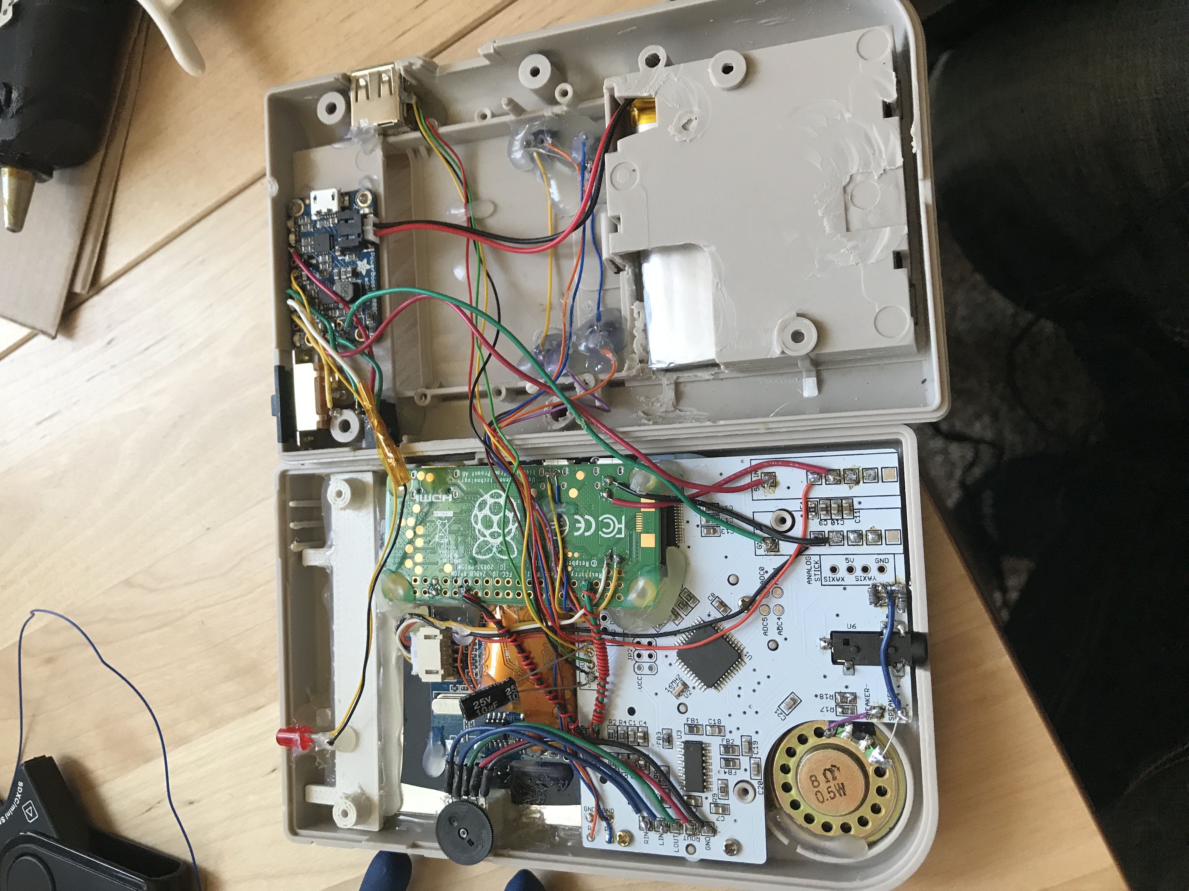

Helder wrote:
Sun May 14, 2017 10:47 am
Maybe a bad ground somewhere? are all GND points going to the AIO powerstrip area? Maybe use a filter cap like 10uf between one of the 5V and GND points on the usb hub solder holes like the one you are using as an external usb connector you plugged the keyboard in. Put the positive side of the cap (usually the one WITHOUT the WHITE Stripe) to 5V and the White stripe aka the negative to GND.
What power boost board are you using in the build? has it differed from previous builds?
All the builds are identical except for the screen. The other ones I used the adafruit, this one I used a gearbest. All using owerboost 1000c
All the grounds except the L-R ground and the ground to the USB connector go to the hub, I can switch those and see if it makes a difference.
I just tried the 10 uF and it made no differences. Reference picture:
EDIT: I almo moved all the grounds to the power strip and there's still the slight stutter. Still goes away when keyboard is plugged in. Or another controller etc.

jermzz wrote:
Sun May 14, 2017 3:18 pm
how have you got the pwm wires shielded (i know i keep going on about shielding)....
it looks like you just have a wire wrapped around the pwm wires, have you actually grounded them to the power strip (are they even grounded)

One thing to remember is the speaker you're using, how big and what is the power rating of it? If it's a small low power speaker you will get this behaviour. I tried a larger 8ohm 0.5w and a small one same specs and the sound quality is vastly different.
I can't really recommend any particular speaker but I've seen people use 1W laptop speakers that will give better output and less likely to do the clipping.
They are wrapped around the wire and soldered to their respective ends. One side to pi and one side to pwm pad.
Should they be grounded? Just one side, or both sides to the same pad?

Helder wrote:
Mon May 15, 2017 1:32 am
I use the adafruit speaker which is 8ohm .5w. I also tried a stock gameboy speaker from a broken one I gutted with the same outcome. I will look into a different speaker, but again I've used the same parts for all the builds, so it seems something is different. I wish I could figure out why the USB fixes the problem. Maybe I should solder in another internal USB and stick a dongle in it. Hahaha.

jermzz wrote:
Mon May 15, 2017 8:58 am
so to ground it, i would have thought both ends would need to grounded (i could be wrong)
now, not to confuse things....
i actually have mine already shielded, and have one end of the ground going to the pi zero (as luckily there are ground points right next to each of the pwm points) my other end is going to a ground point on the board (not the power strip, but one of the spare usb hub points)
this is why i'm going to re-shield the wires (thinking grounding to the usb hub may be the issue for me, but yours isnt like that)
also the speaker i have states that its a 8ohm 2 watt speaker (this might not be the reality)

VeteranGamer wrote:
Mon May 15, 2017 9:49 am
I honestly don't think it's the pwm wires. When I run USB audio directly to the pot, it still has the problem. Bypassing the pwm all together. It's somewhere between the pots and the speaker. Swapping to the 75ohm resistors did wonders, it's just not *perfect*

jermzz wrote:
Mon May 15, 2017 9:27 pm
then it may well be the speaker....
who knows....
