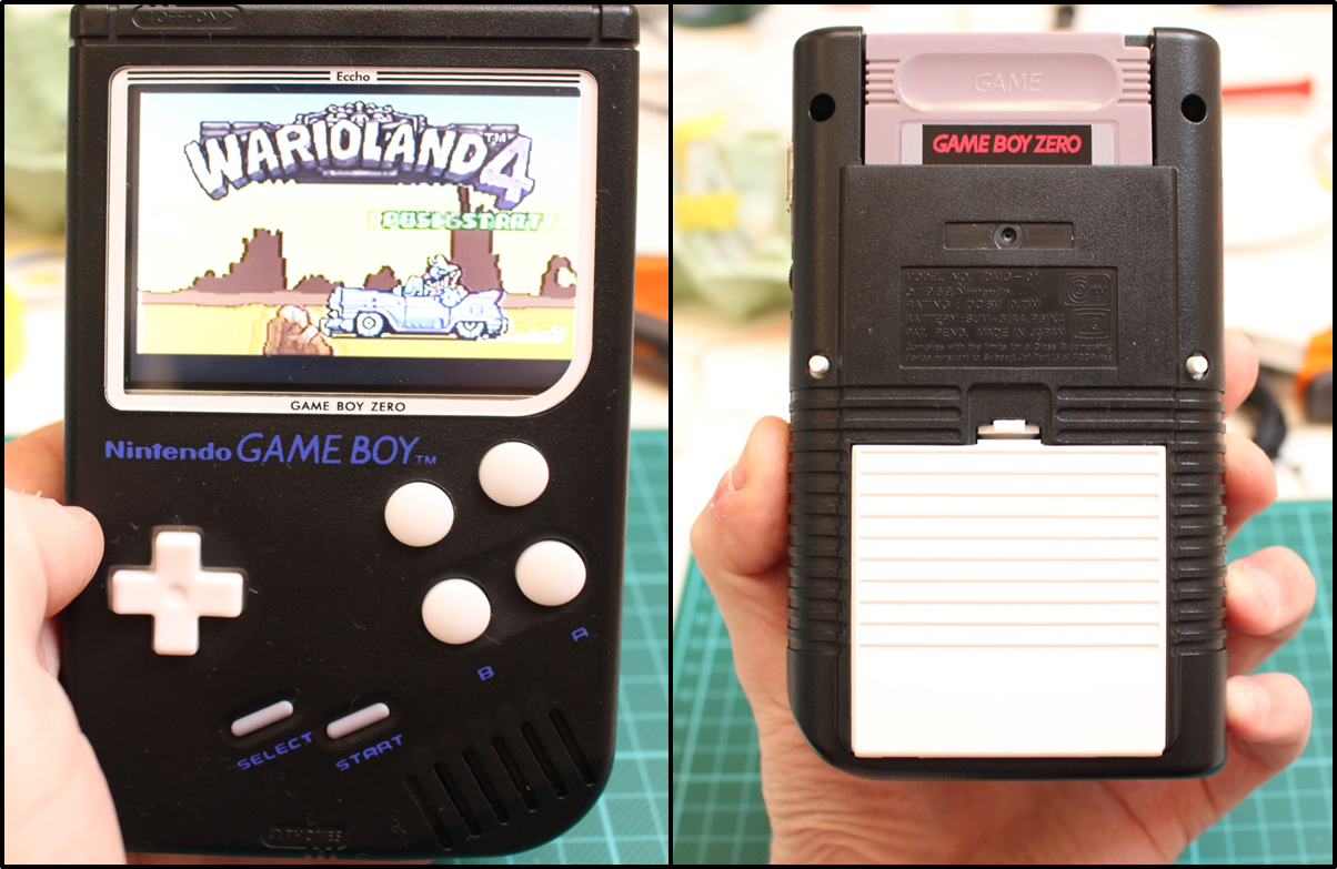

Hi everybody,
I have to be honest, Reddit brought me here. A GBZ build got upvoted to the frontpage and I jumped right into it. I was already looking a while ago for an opportunity to get into electronics. And here I am! My nostalgia for Game Boy Advance games pushed me further than I ever thought. Building GBZs now occupies a major part of my free time.
I would like to show off my builds in a minimal way as they do not bring anything new to the community.

First, The MinimalShow
Helder's AIO board
Raspberry Pi Zero
Second, Who Let The Dutch OutShow
Kite's SAIO
Raspberry Pi 3
Third, The RaphaelShow
Kite's SAIO
Raspberry Pi Zero
Fourth, The Hello KittyShow
Kite's SAIO
Raspberry Pi 3
ExtrasShow
The last GBZ is a wedding gift. I was really looking for some professional look. YaYa delivered! Awesome results!
Game Box and stickers by YaYa
Case recommended by YaYa
Final wordsShow
Give me your opinion, criticism is very welcome because it will help me improve.
Thanks everybody.

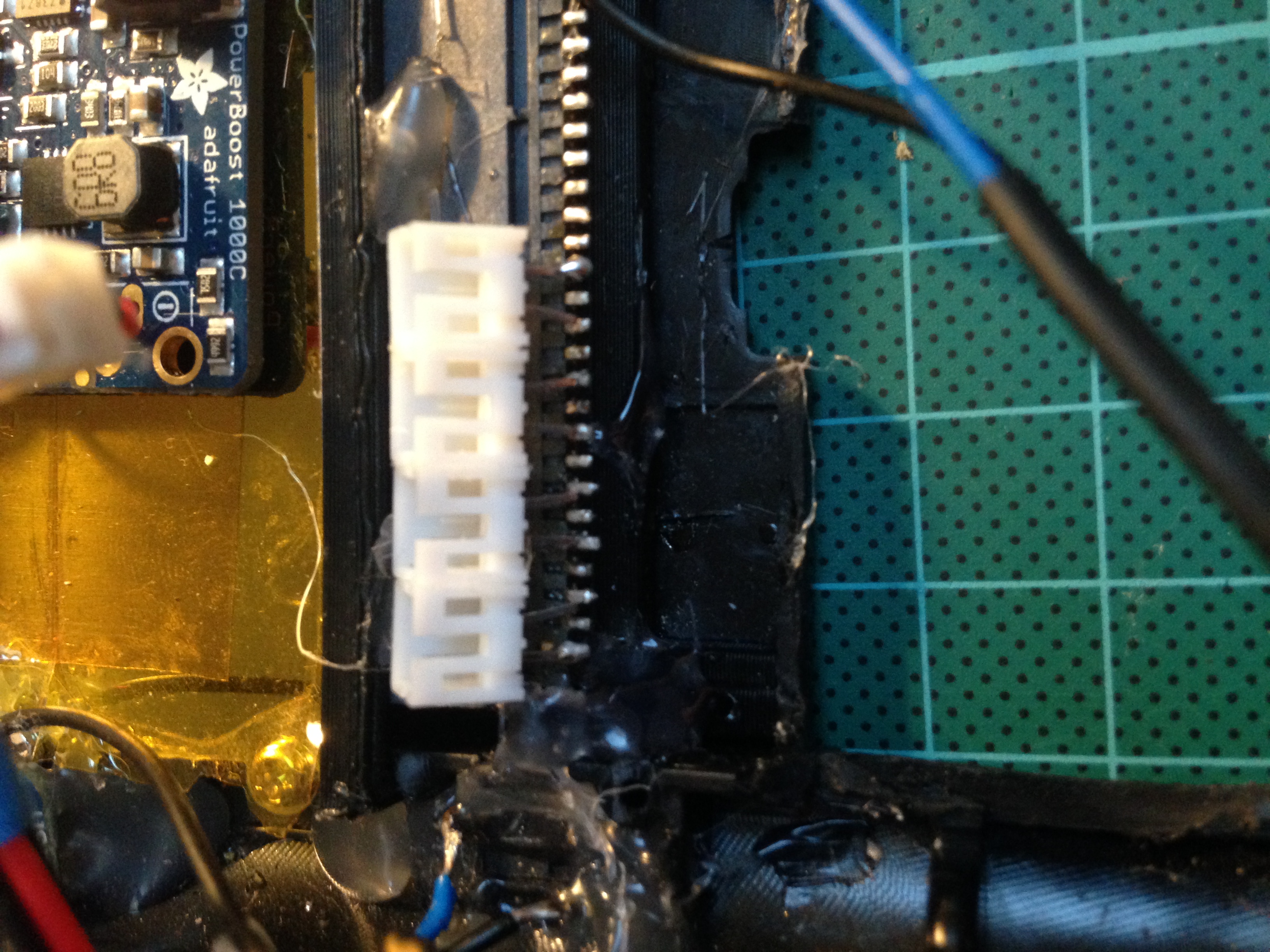

First bad idea. I tried shortening the wires as much as humanly possible to connect the data wires with the cartridge reader. To do so, I solder JST directly to the cartridge pins so that I could assemble everything (inspired by VeteranGamer's no hot glue GBZ build). It was a bad idea because of the space it took (bumping againt the RPZ and because the JSTs were hard to get rid off. This put all the "unstable" internals at risk of getting ripped because the space was very narrow due to the wires because super short... You can see in the second picture below how short I went. On the left side you have the approximate size of the JST connecting the RPZ and on the right side the ribbon of cable I also used. Both didn't work.
Second bad idea. I tried giving some "volume" to the cross button because it felt too loose. I did so with a drop of glue on each side of the cross. It turned out to not work out at all!
Chest of good ideasShow

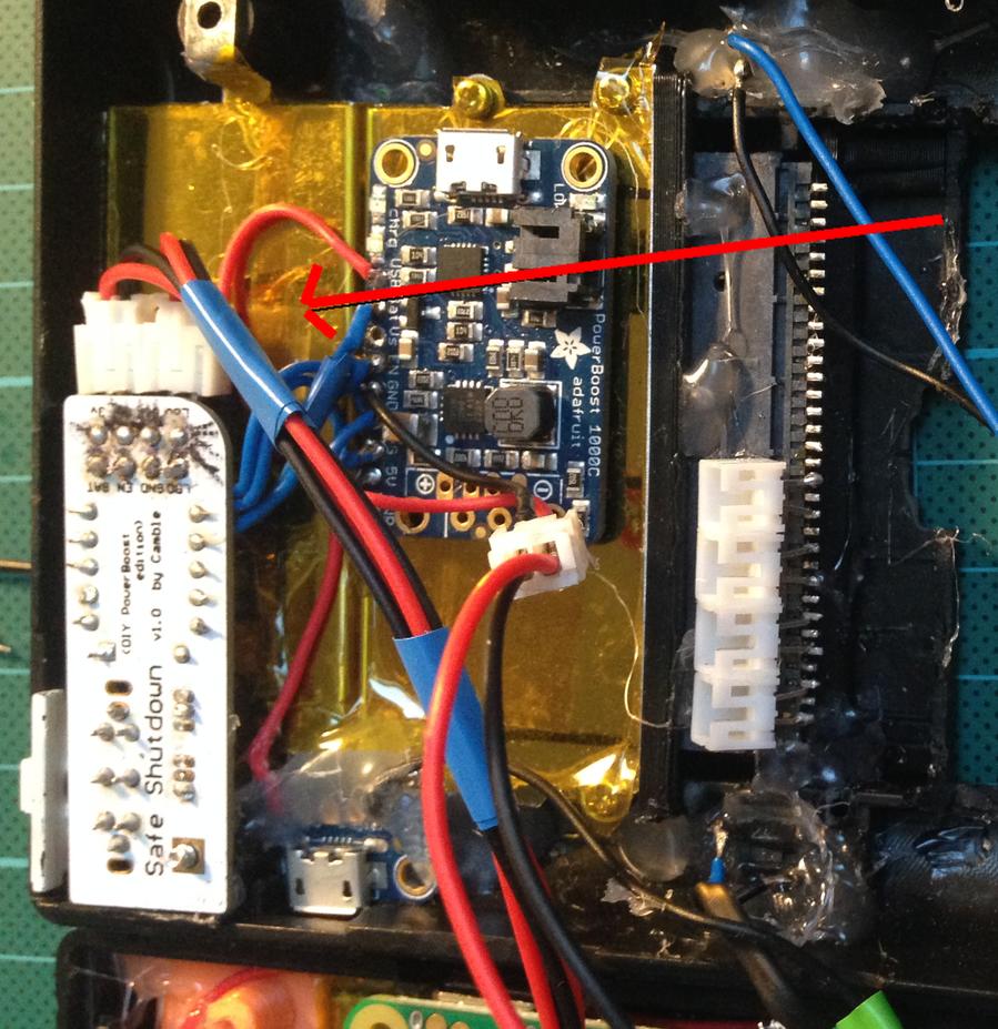

First good idea that I got was from VeteranGamer's build without hot glue. I soldered directly the JSTs on Camble's safe shutdown board. It helped a lot with testing Camble's script and so on because I was able to easily attach and detach everything. To give some more context, the safe shutdown came after I already finished the build. This means a lot of internals were already glued and a JST-based wiring helped a lot.
SSD cropped.jpeg (154.64 KiB) Viewed 11515 times

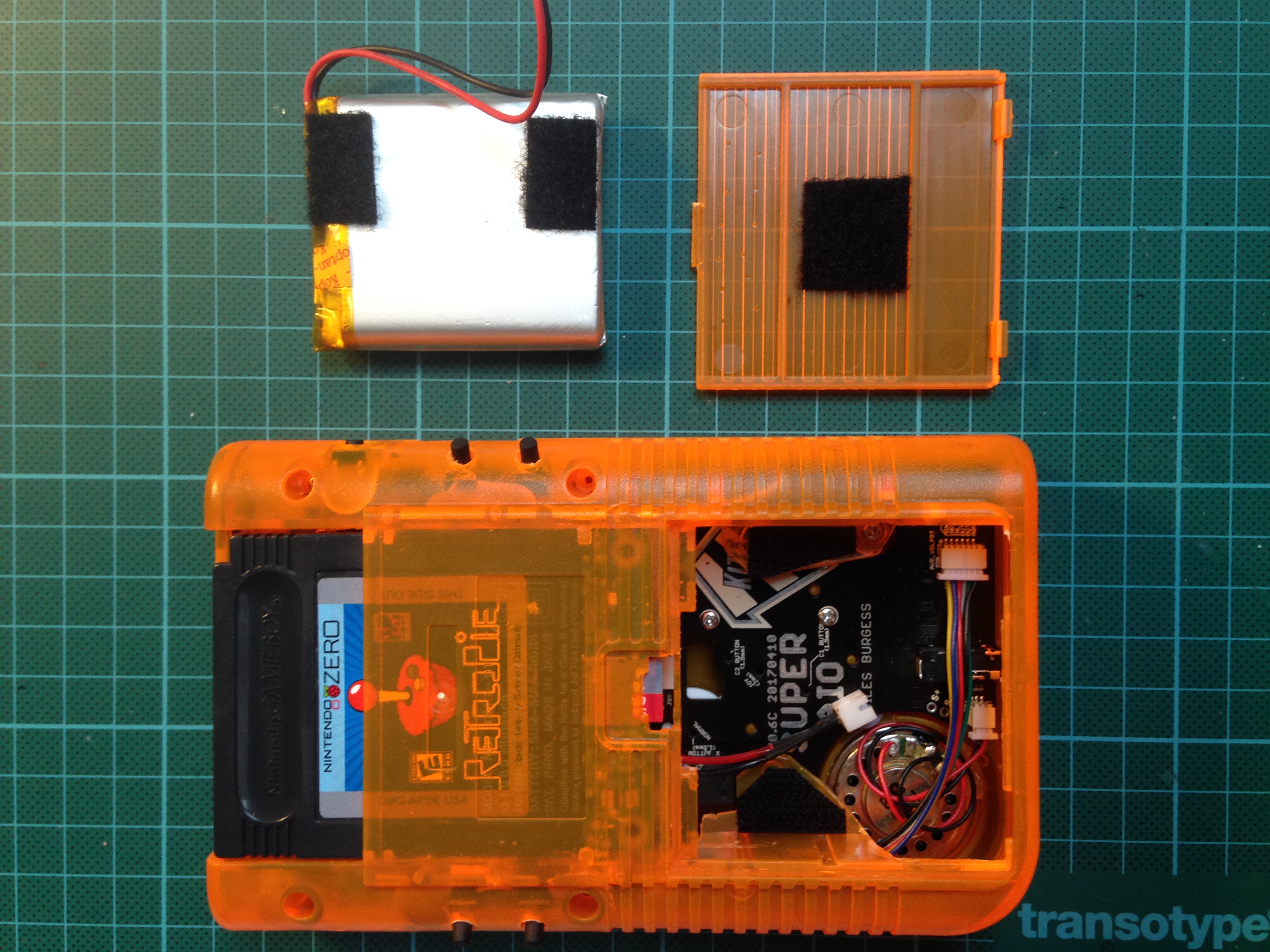

Second good idea. I fixed the battery compartment with regular velcro instead of suggested magnets!

Great work! I like the Stormtrooper color scheme of the first one. Where'd you get the custom screen surround? Did you make it yourself or commission it somewhere?

I bought it last year in December from Dominator. You could decide on the colours and titles of your screen surrounds. I really hope he comes back soon. Great items!

One question. I see both of your builds and they look pretty nice, both of them. Congrats!
About the cartridge reader from PRS-Tech, did you used it with Kite's SAIO? I see the microSD card in a weird spot but I cannot see if it you actually used it since you used an original black cartridge. I'm interested but no ones seems to have tried it yet with Kite's SAIO.
No, I used it only for the first build with Helder's AIO.
Elmafioso90 wrote:
Sun Jul 23, 2017 2:48 pm

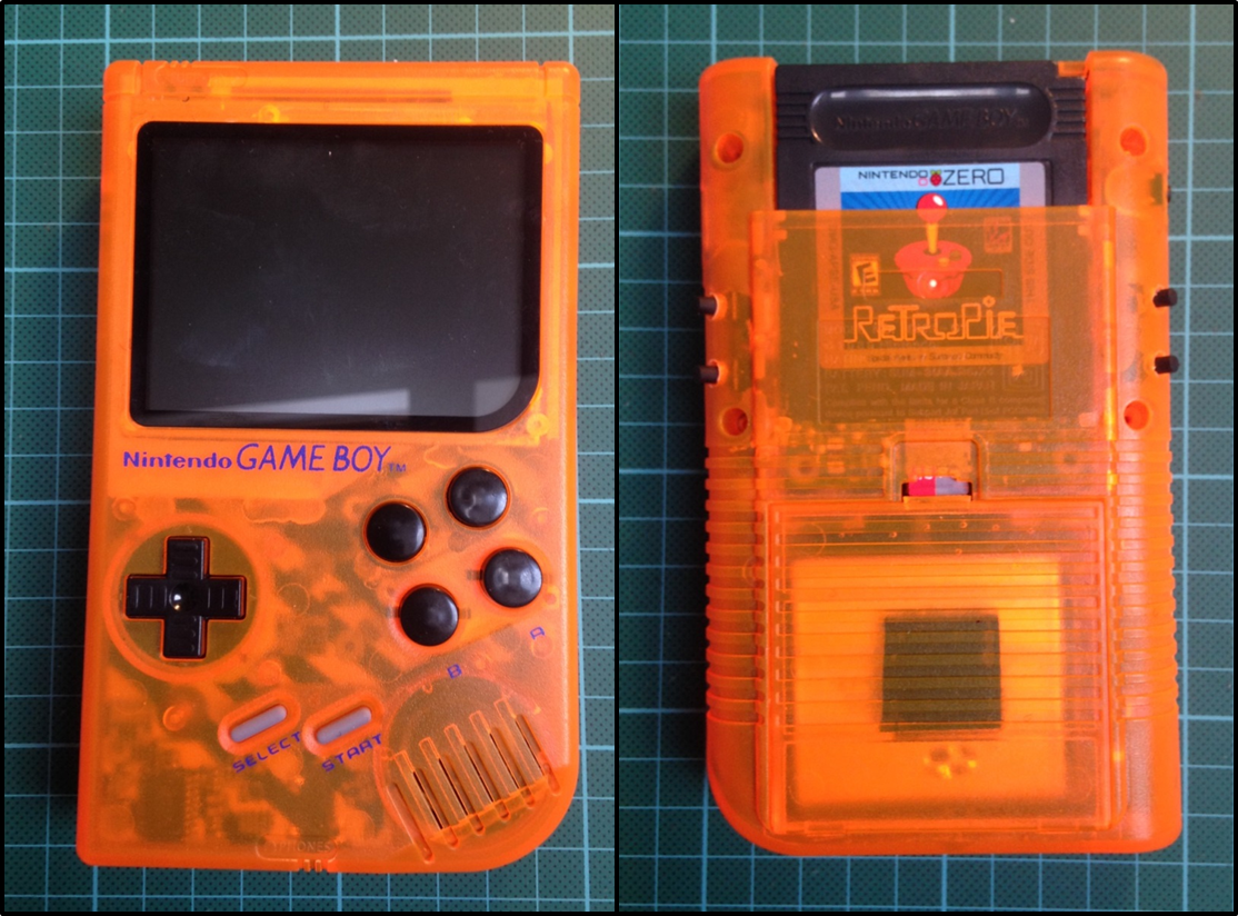

Great observation here. I turned the RPZ 180degrees so that the microSD pokes out at the bottom, thus being accessible by opening the battery compartment. I was unsuccessful with PRS's cartridge reader, that's why.
Nobody has done it yet because a Pi3 build with Kite's SAIO takes all the cartridge space. I could only see it feasible with a RPZero build, but here again, would it make sense since you have already an option of accessing the microSD card from the side? You would however score quite some retro points if you make it happen though :D
