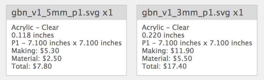

I see that they made Clear and Clear Matte. You used just straight up clear right. Here is a pic of the settings. Does that seem correct?
No! You've got the thicknesses backwards.
3mm = 0.118
5mm = 0.220
Yes it's normal clear acrylic, not clear matte

Post by Italian77 » Thu May 10, 2018 5:12 am
Holy cow! I knew that correct thickness. I can’t believe I swapped it. Thanks for catching that.
I loaded one file at a time at first from the site and had the size correct but it would not add both to the cart. The only way to add both to the cart was to download them first then upload them to get them into one project.
I subconsciously went smallest to largest and didn’t double check the file names. I’m usually more thourough than that.

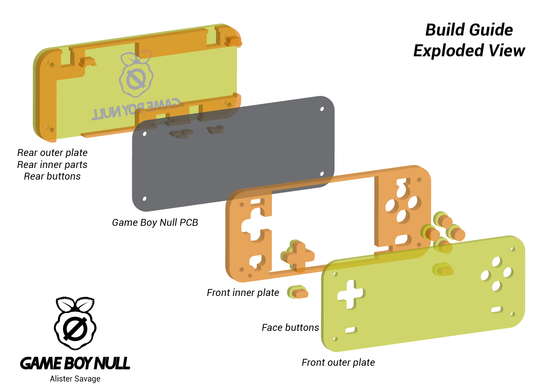

Here's my build guide: https://1drv.ms/b/s!AqMvwiYIMMtmjEArs95cerX9eGHc

There are three plates in the build guide above, but only two files on Ponoko.

Italian77 wrote:
Thu May 10, 2018 4:24 pm
Do you mean the black plate in the middle? That's the PCB, not a piece of acrylic, it's labelled...
On the first page, all the green parts are cut from the same 3mm acrylic sheet, and all the orange parts are cut from the same 5mm sheet.
Do you have any software you can use to open up the design files and look at them?

Post by Italian77 » Thu May 10, 2018 5:16 pm
I was referring to the one outer and 2 inner plates. I’m guessing one of the two files has two plates. I just can’t open them
