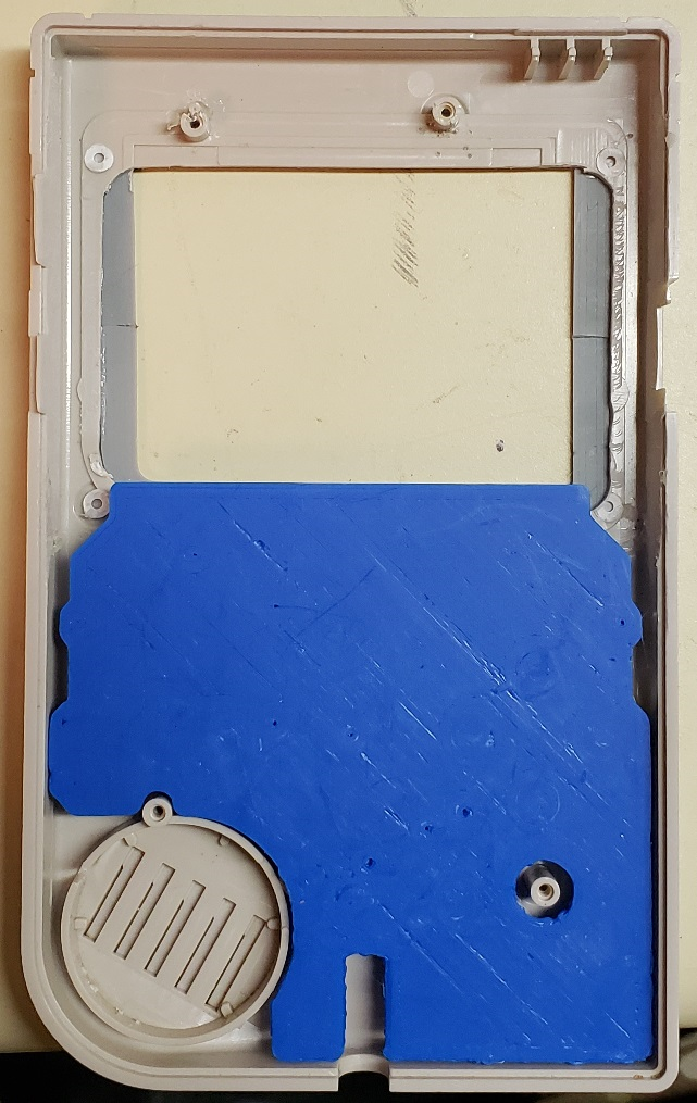

To get something you can extrude you can either create a new shape step by step along the existing lines or you can weld the lines together. As far as I know Fusion is not capable of welding splines though. You could use an exported .DXF to get the spline into other software.
Okay, I finally got a chance to mess around with Fusion 360 and your instructions. I think everything is now good but I won't be able to test print it til I get home later. I'm gonna upload everything in case someone else wants to use or modify things. The file is going to look sloppy I'm sure but I have to start somewhere. The stl file looks fine in Cura but again I won't be able to test print til later today.
Thank you again for helping me out. I hope this jump starts me to do more now.

Printed it up just now quickly and although it looks like crap (still figuring out issues with my 3D printer), the print comes out fitting with no known issues. I'm redoing it now on a high quality setting and so far the holes are printing with no trouble.

So from my experience printing this on both a Dremel 3D20 and my Anycubic Kossel Plus, the default scaling of the model's button wells is just a hair too small, but the print otherwise seems to be the right size. Are DMG buttons not supposed to fit?
Hi, sorry to hear you are having problems with the model.
Yes, the original DMG buttons are suposed to fit. I just checked the CAD model, the holes are 10.75mm in diameter. The is exactly the same diameter as the holes in my two original Game Boy DMG cases. Is it possible that the plastic in the print slightly deformed when cooling? That would be one explanation. Another might be that not all original DMG cases (and hence probably not all buttons) are exactly the same size. Some are off by half a millimeter or so in some parts. And so are repro cases.
Either way, if you want to edit the model, the .F3D format comes with the whole edit history and should allow you to adjust the model to your needs without too much trouble.
