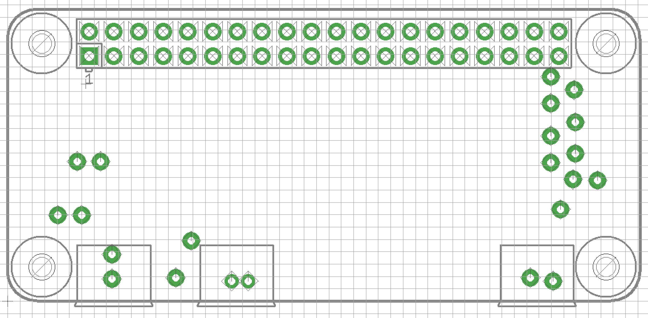

Hi everyone,
After searching for a Raspberry footprint for the EagleCad and finding only that it has no bottom pads (and I need with bottom pads), I decided to create my own footprint.
I uploaded it to my github, here is the link:
https://github.com/vitalibr/rpi-zero-eagle
Enjoy! ;)

Awesome, i'll test the footprint.
Hmm, pin 1 should be above the SD testpads? Doesn't look right.

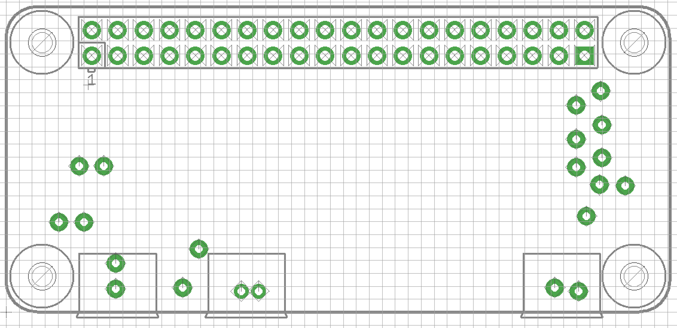

Recommendations
1. mirror the tDocu (51) layer to bDocu (52)
tDocu (51) mirrored to bDocu (52)
Screen Shot 2018-01-05 at 10.25.42 AM.png (335.33 KiB) Viewed 18807 times

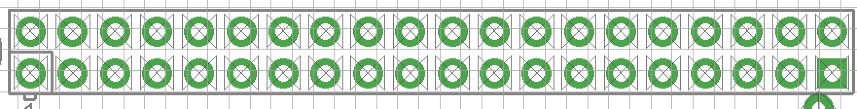

2. 2x20 header... ...square via the correct end
square via on bottom right of header
Screen Shot 2018-01-05 at 10.28.46 AM.png (97.54 KiB) Viewed 18807 times

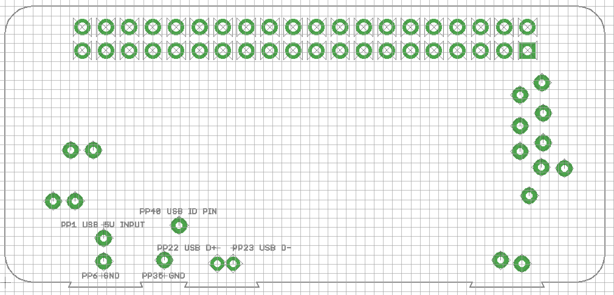

3. PP5 isn't used by most Gameboy Zero builds, you can get rid of it
PP5 removed
Screen Shot 2018-01-05 at 10.54.56 AM.png (330.12 KiB) Viewed 18805 times
4. You can additionally get rid of the HDMI test points (39,36,20)
5. Labels are nice ;)
Drill holes are removed as this will impact your design as well
Screen Shot 2018-01-05 at 11.11.00 AM.png (249.8 KiB) Viewed 18804 times
