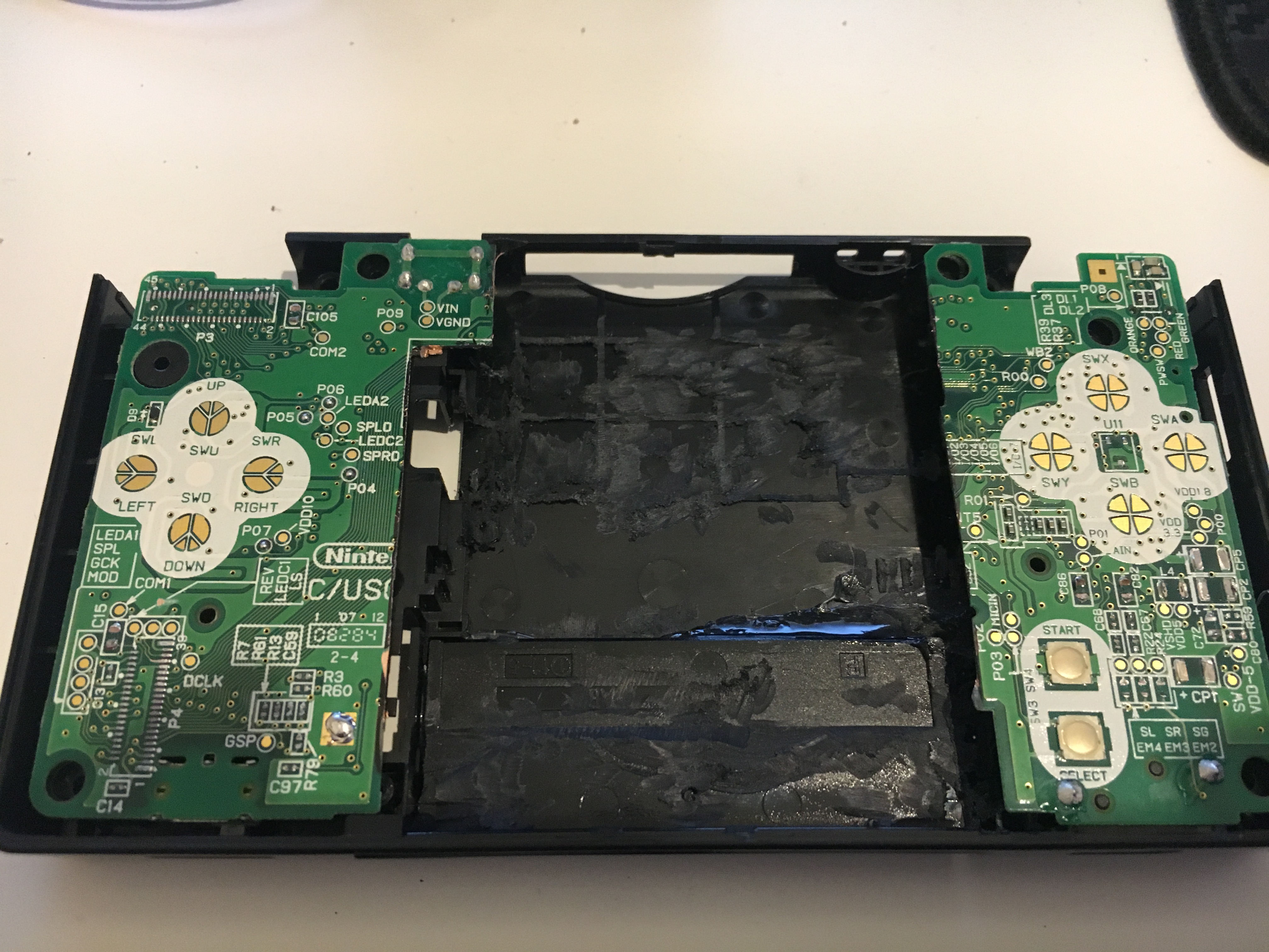

Hi guys, I'm working on this project and I want to show you my progress.
First of all, sorry for my bad english.

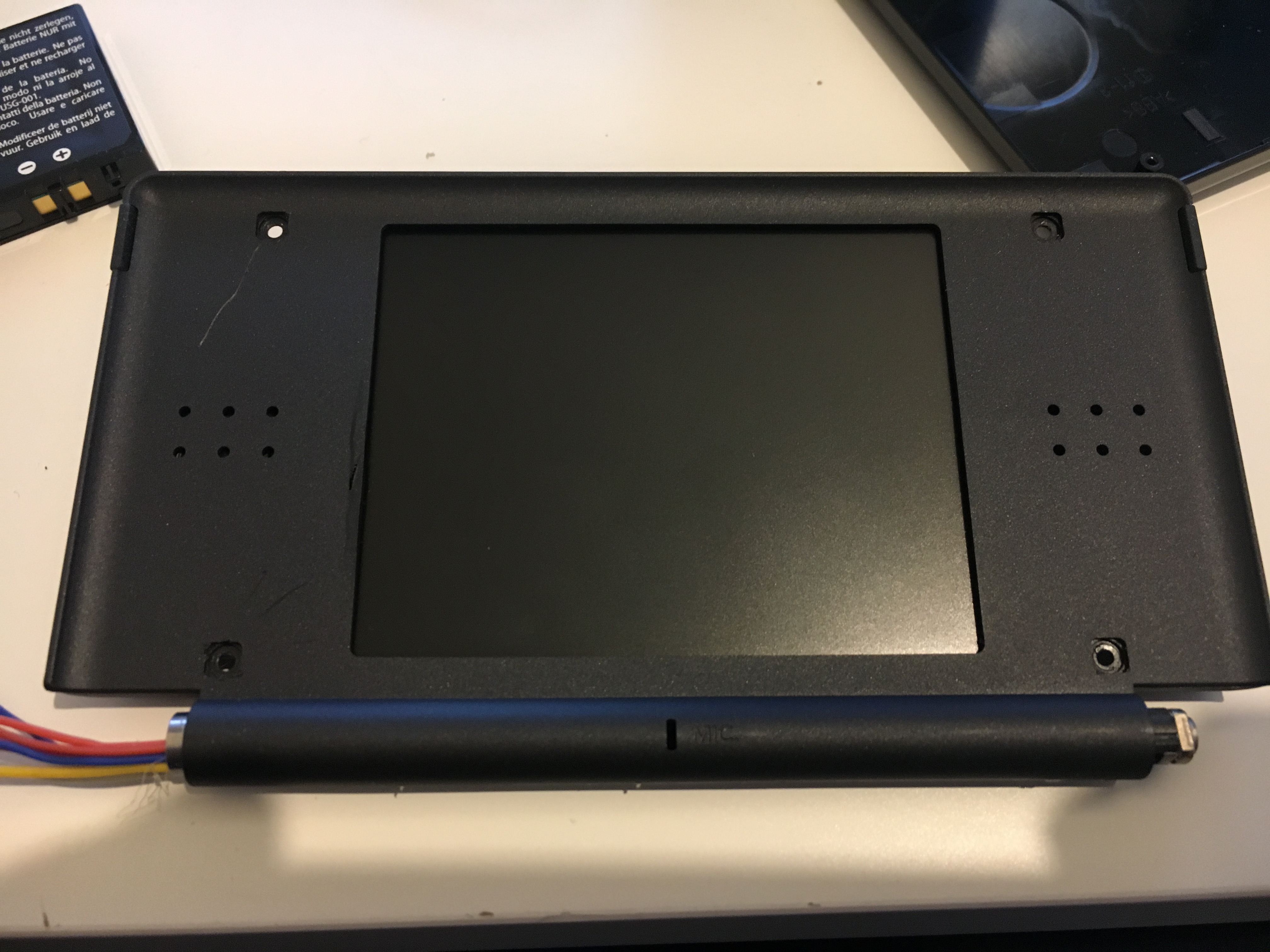

I'm using a working original DS.

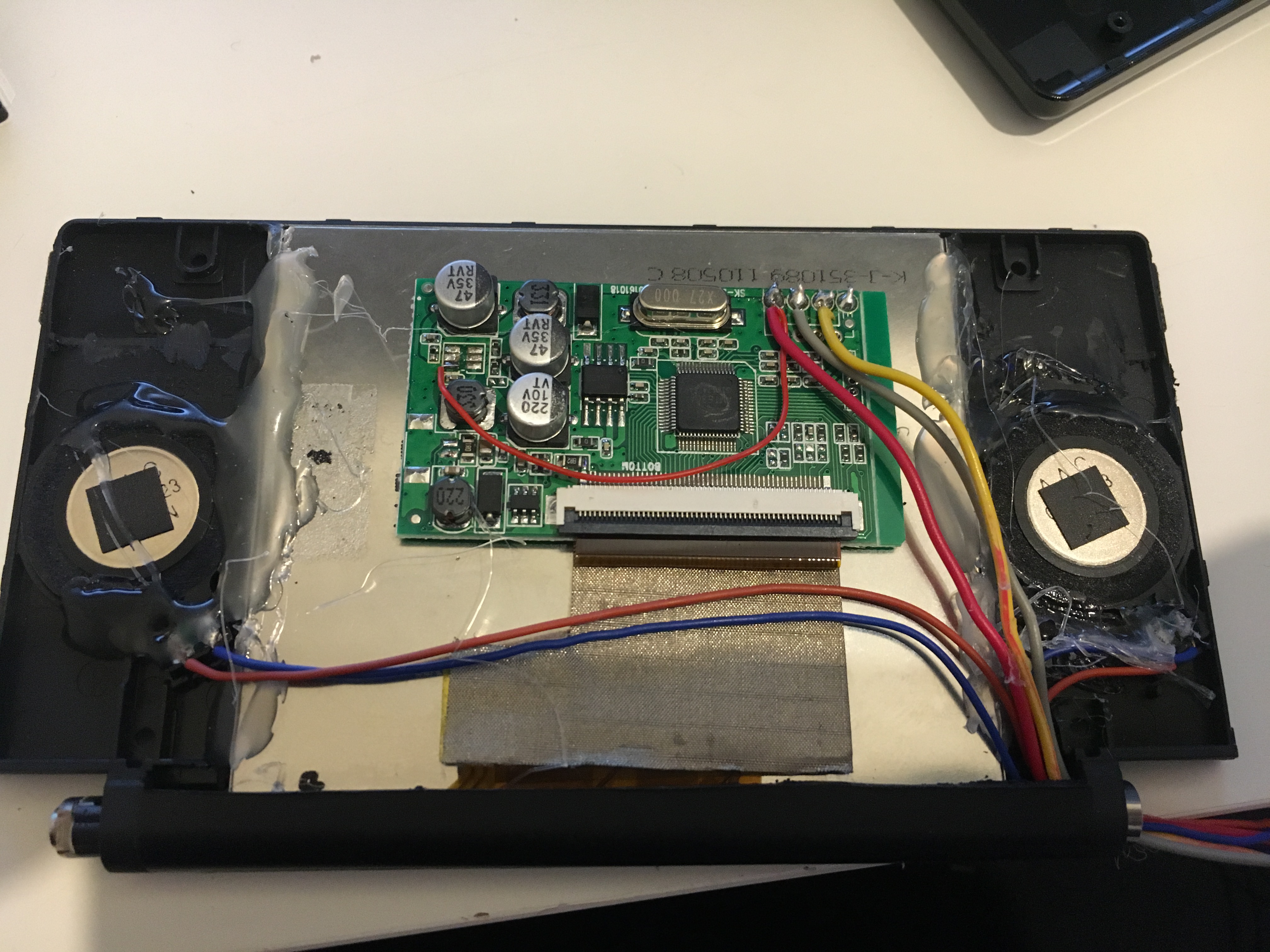

For the screen i'm using the same screen of gameboy zero: http://amzn.to/2FZFSes
i have mount it in this way:
the dimension it's ok, but i can't mount a protection, no problem:

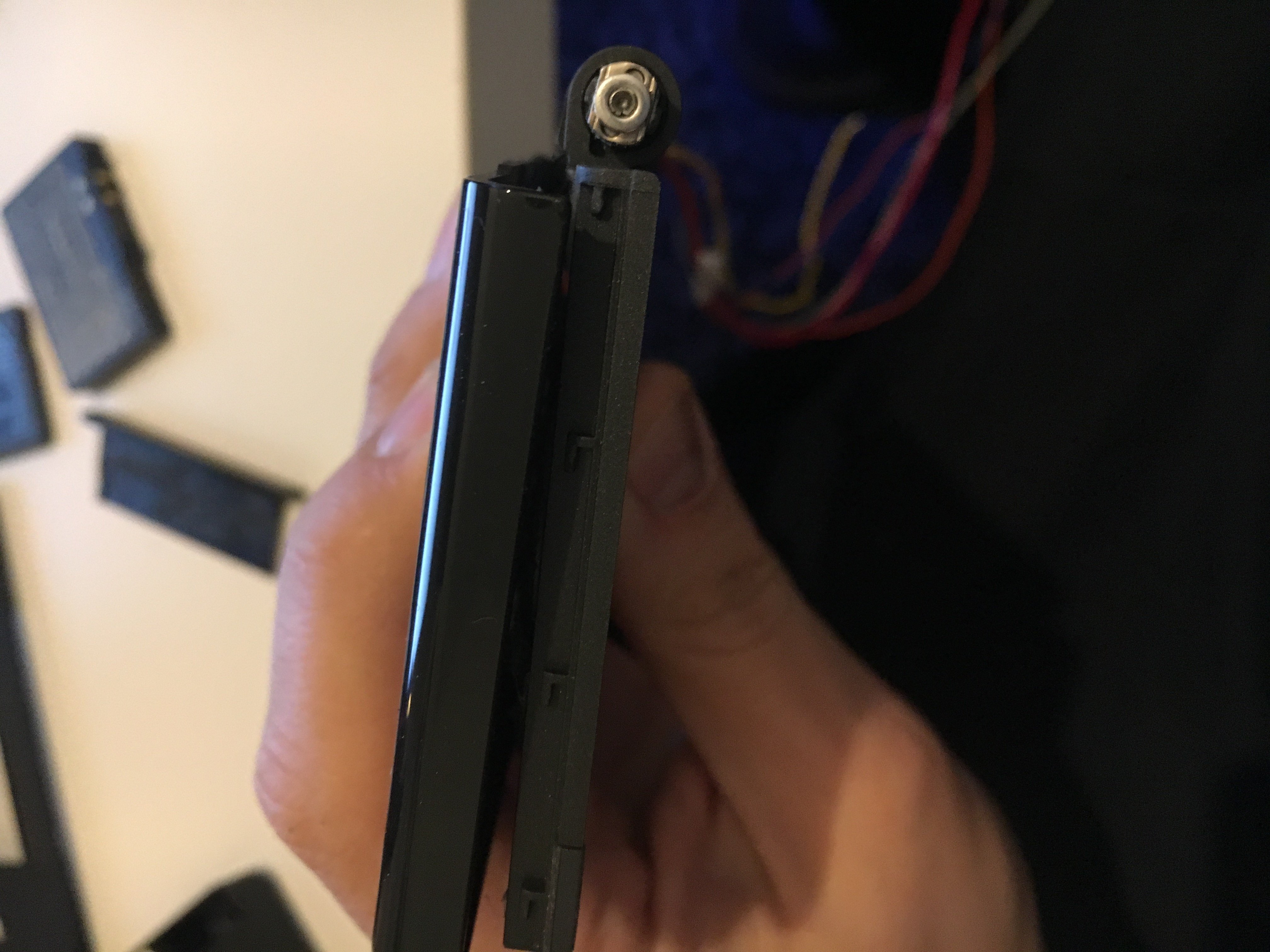

But i don't know how to close the shield:
If someone had an idea, pls tell me.

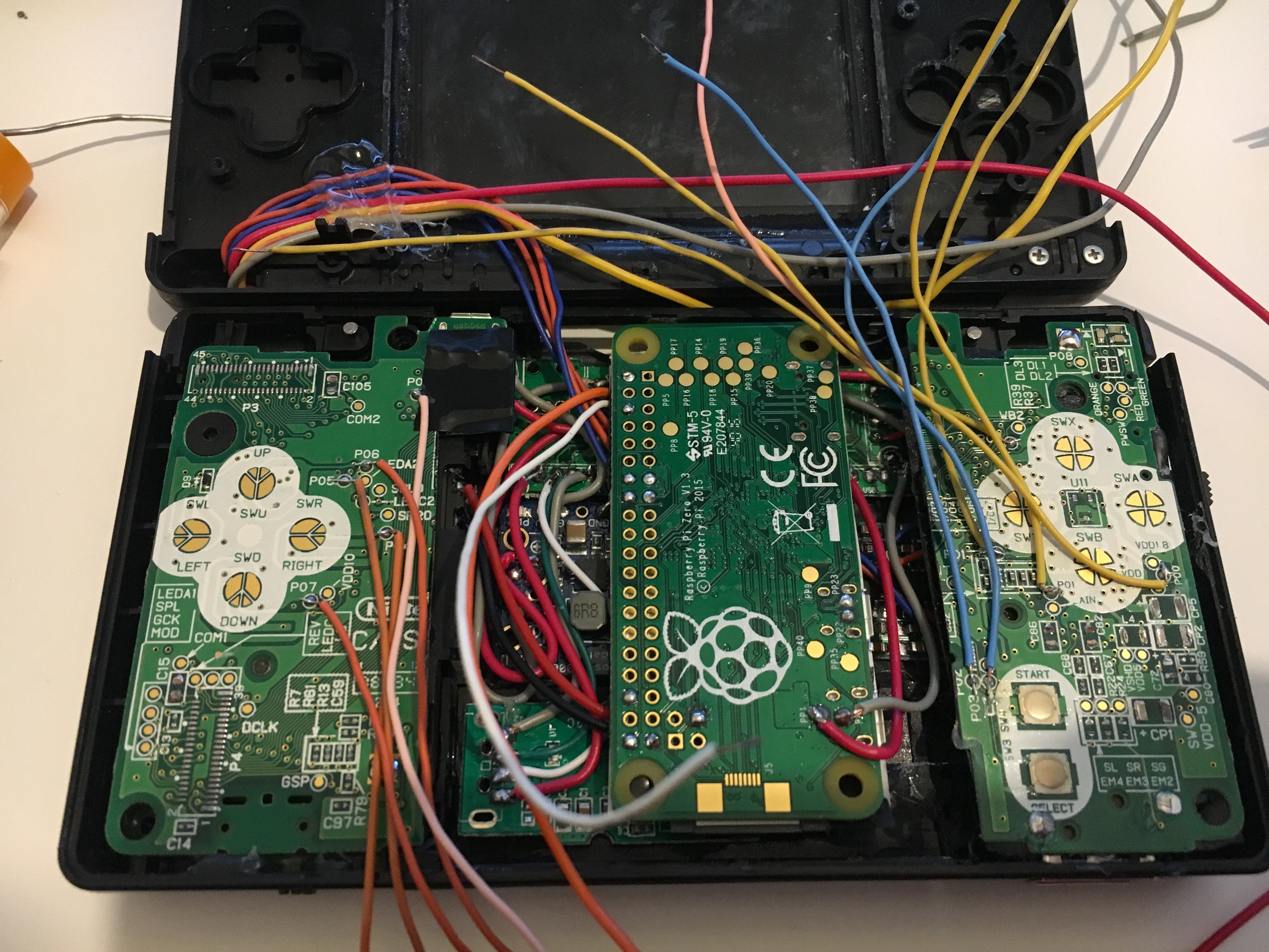

For the PCB, i'm using the original pcb and i soldering all button on the gpio. Recalbox as OS:

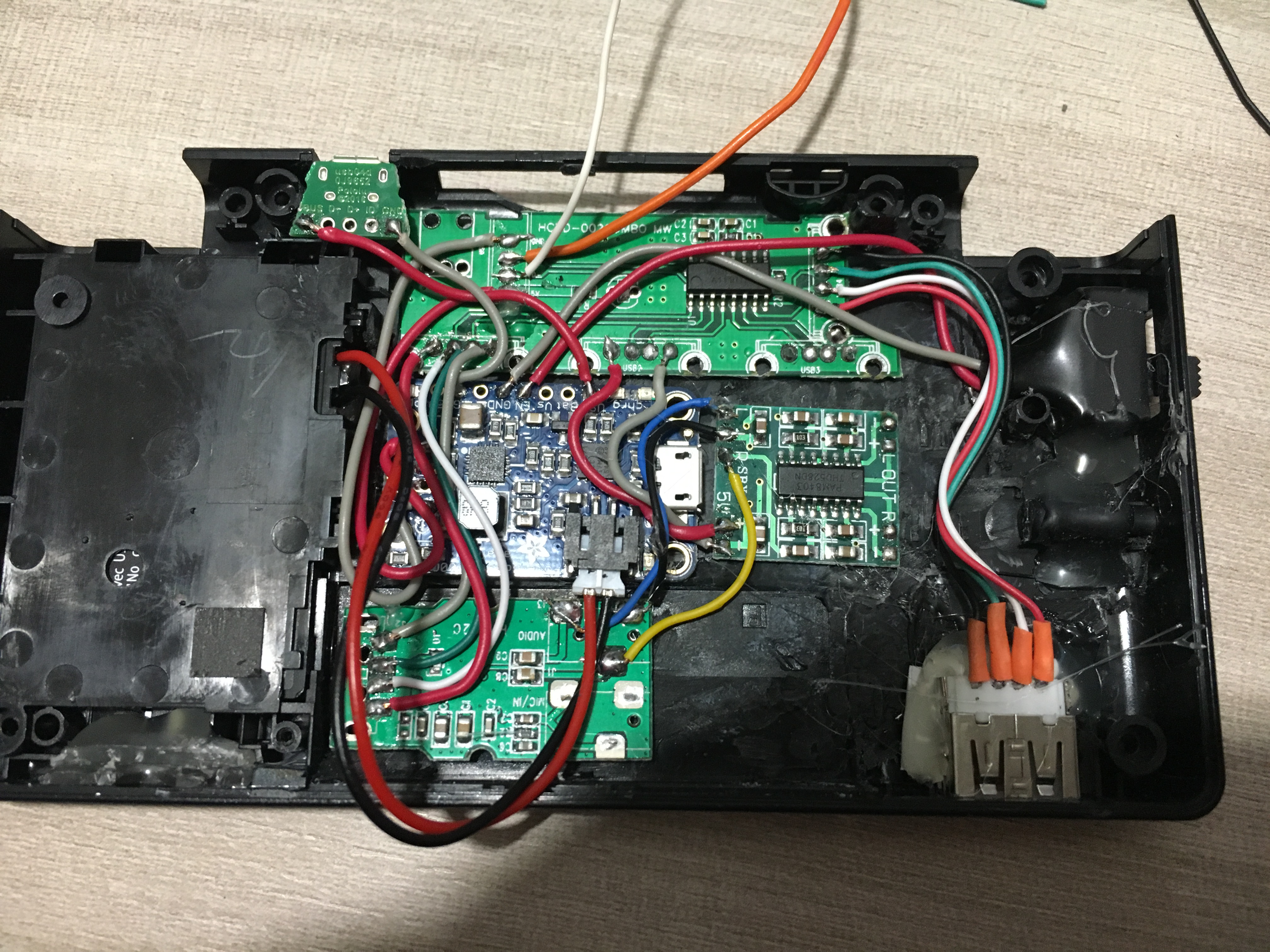

Update:
i have put the components into the case in this way:
My pi zero into the centre:
now I have to solder all the wires for the commands.
See u soon

Update:
all wired:
but when turn on, i have this problem:
[youtube]https://youtu.be/W1pubD5DD-M[/youtube]
video.mp4
(4.71 MiB) Downloaded 774 times
before this problem did not give it to me
what can i do?
brigghius
Posts: 33
Joined: Fri Apr 28, 2017 8:53 am
Has thanked: 15 times
Re: DS Lite Pi Zero
Post by brigghius » Sun Mar 18, 2018 8:57 am
PROBLEM UPDATE:
Ok I tried to connect the power directly on the Pi0, and IT WORKS!!!
so the problem is the power supply, But WHAT?

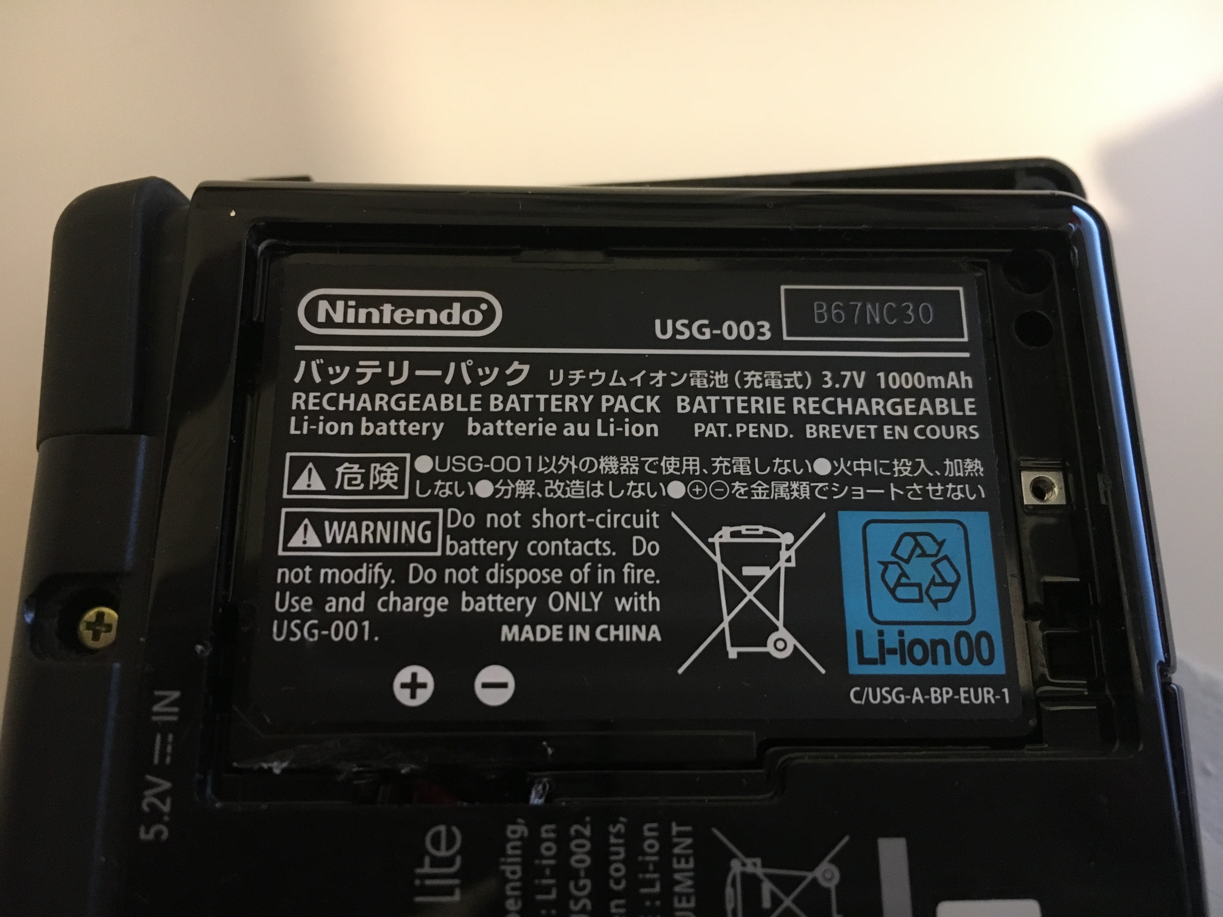

I think it could be the battery not suitable:
or there is not enough power supply to the raspberry.
what do you think?
understar
Posts: 7
Joined: Fri Feb 02, 2018 10:22 am
Re: DS Lite Pi Zero
Post by understar » Sun Mar 18, 2018 9:38 am
what do you think?
imho low power ... you need to remove the controller in the battery
and need a more powerful battery
brigghius
Posts: 33
Re: DS Lite Pi Zero
Post by brigghius » Sun Mar 18, 2018 10:16 am
what do you think?
yeah, i tried with another battery (2600mAh) and all it's ok.
now I buy another battery like this: http://amzn.to/2G193xP
or not?
