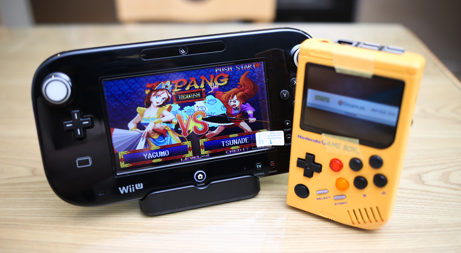

Hi
I am a Korean who likes Korean retro games.
I was inspired by your production.
The internal structure is different, but it has been helped.
Thank. Brother :) :)

Please post pictures from the internal part if possible!
Very clean project, well done!! :D :o
