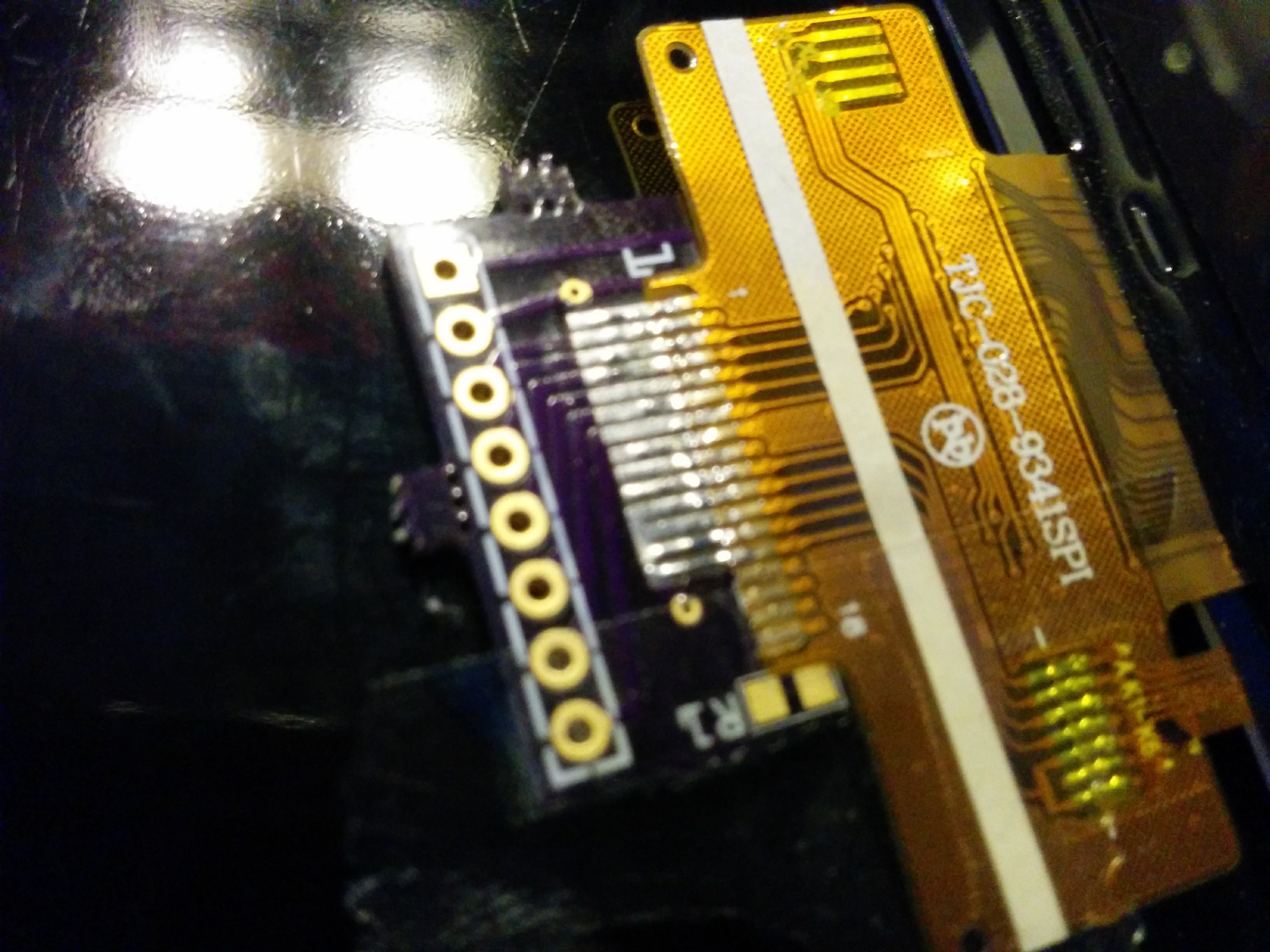

That screen looks to be just a larger ili9341. With a bit of careful soldering you could transplant the larger screen into to board of a smaller screen
Or you can get a custom board made up to let you use the screen like the one I designed a while back
https://oshpark.com/projects/BP9tGKag
This is designed for a 2.2 inch screen which only has 14 pins, but the last 4 pins on larger screens are only for touch, so you can overhang them

moosepr wrote:
Mon Aug 07, 2017 3:53 am
I saw the "pitch-conversion" pcb's at OSHPark... What do you mean... could I transplant the 3.2 inch from aliexpress to the 2.2 inch PCB (which has nice solderable connections)?

Post by moosepr » Tue Aug 08, 2017 3:04 pm
You sure could! Just make sure you get pin 1 in the right place and your golden
Would be the same as doing this

I reread this thread and it is clear now... I will buy the "ili9341 minimal copy" board you designed and hook it up. Which resistor did you use for the backlight? Thanks!

Post by moosepr » Wed Aug 09, 2017 12:10 pm
You need a 10 ohm 0805 resistor. Little bit tricky to solder but they are cheap! Can probably get 100 for a dollar

Post by moosepr » Thu Aug 10, 2017 4:57 am
Yeah it's tied to 3.3v so it only needs a little drop. You could even bridge it if you were really struggling to get a resistor
But I'm not sure on the long term impact that would have
