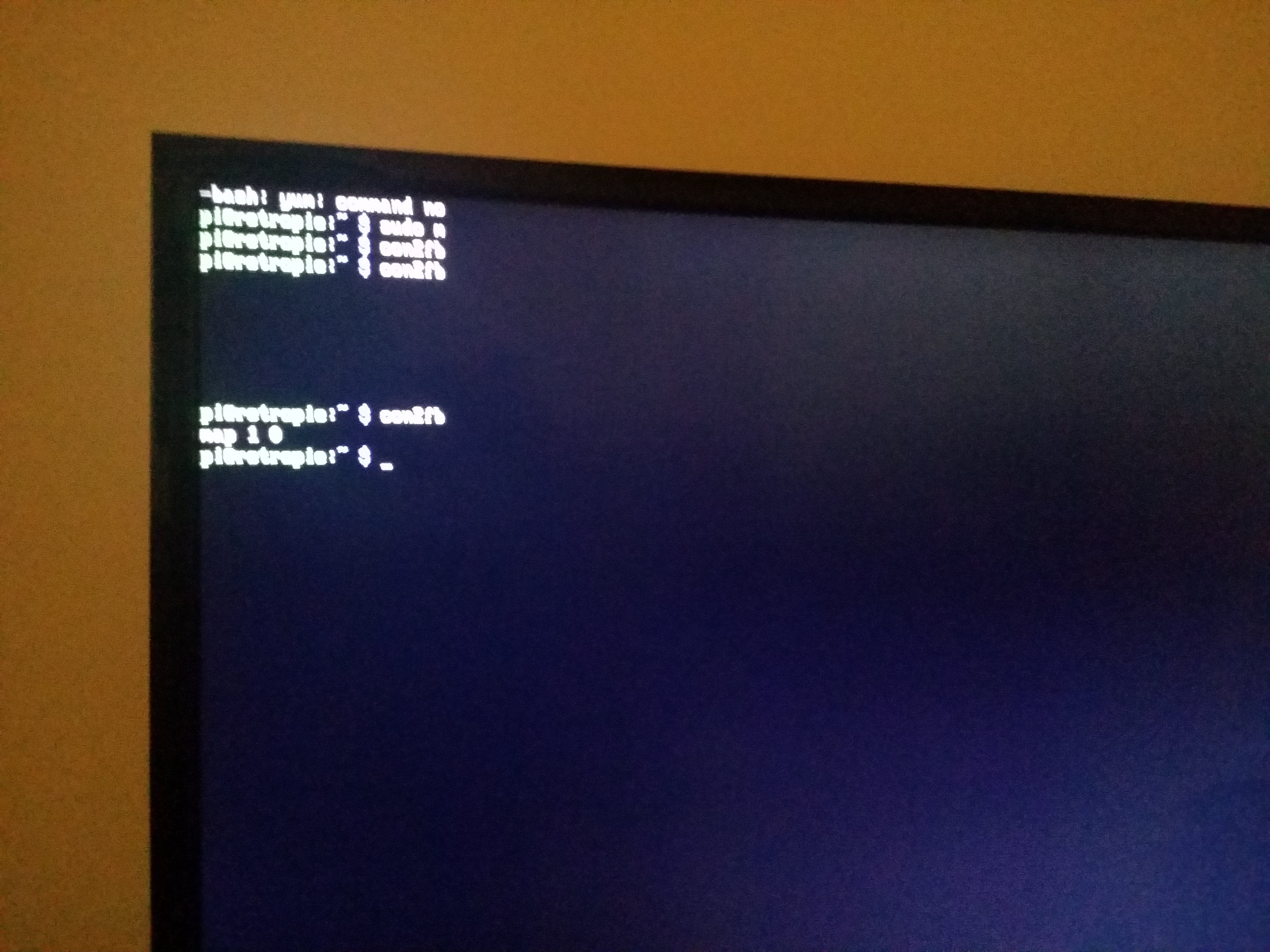

The correct name of the one I tried was hx8430bn is that the one you're referring to? I think I get closer with the one than any other, (The hdmi screen "freezes" after the con2fbmap 1 1 command, and returns after you run con2fbmap 1 0 with the displayed text looking very much like the resolution of the screen. The tft meanwhile, just stays white.

Yeah that was the one I was thinking of. The HDMI appears to stop working as the TFT then becomes your console (when it's working!)
The screen will go black once it has been initialized, so a white screen doesn't look good.
There is a flex FB driver system that was designed to be a 'one tool fixes all' solution, but I have not really played with it
