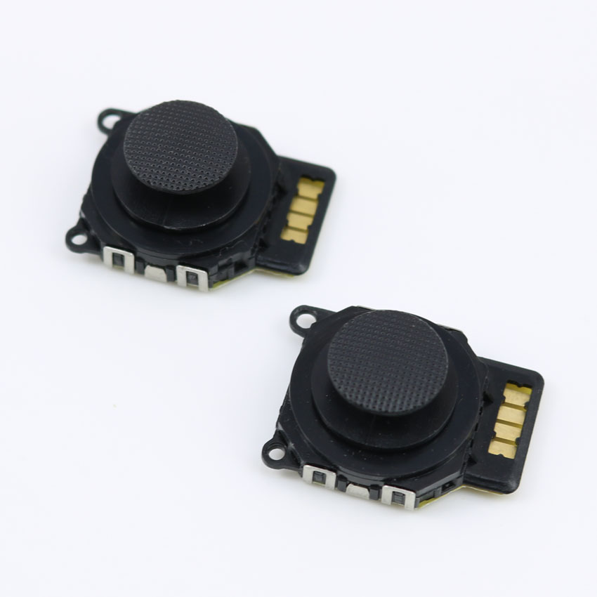

I have not done thorough test of analog sticks (yet), since my only PSP stick seems to be defect....Order on the way....

Hey you wouldn't happen to know what would be the pin out put for this kind of psp joy stick
