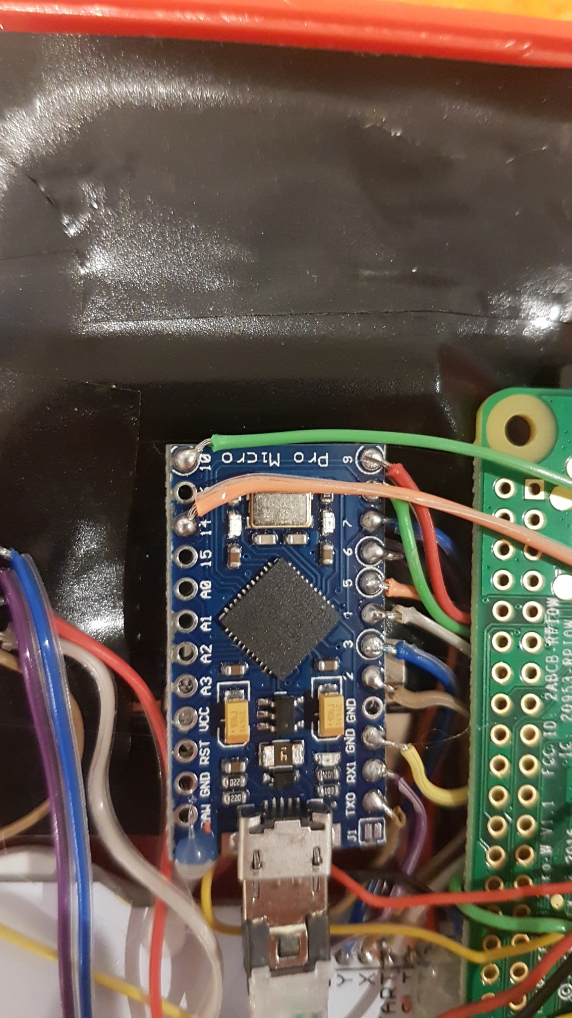

New code is definitely more stable in terms ot bounce.
Having issues however with my R1 button. Its not recognised.
I have my Leonardo wired up as per Sotas original code so essentially 0-10 and 14.
So 12 buttons in total.
I can configure input in Emulationstation as normal minus the R1 button. (This works with Sotas code so button is good).
Navigation in Emulation station is OK but only a couple of buttons work within games.
Any ideas @helder ?
Ive tried changing your code (New Sketches) to define only 12 buttons and re-order the numbers to match my the old code but no joy.
Any help welcome.
Heres my Leonardo:
