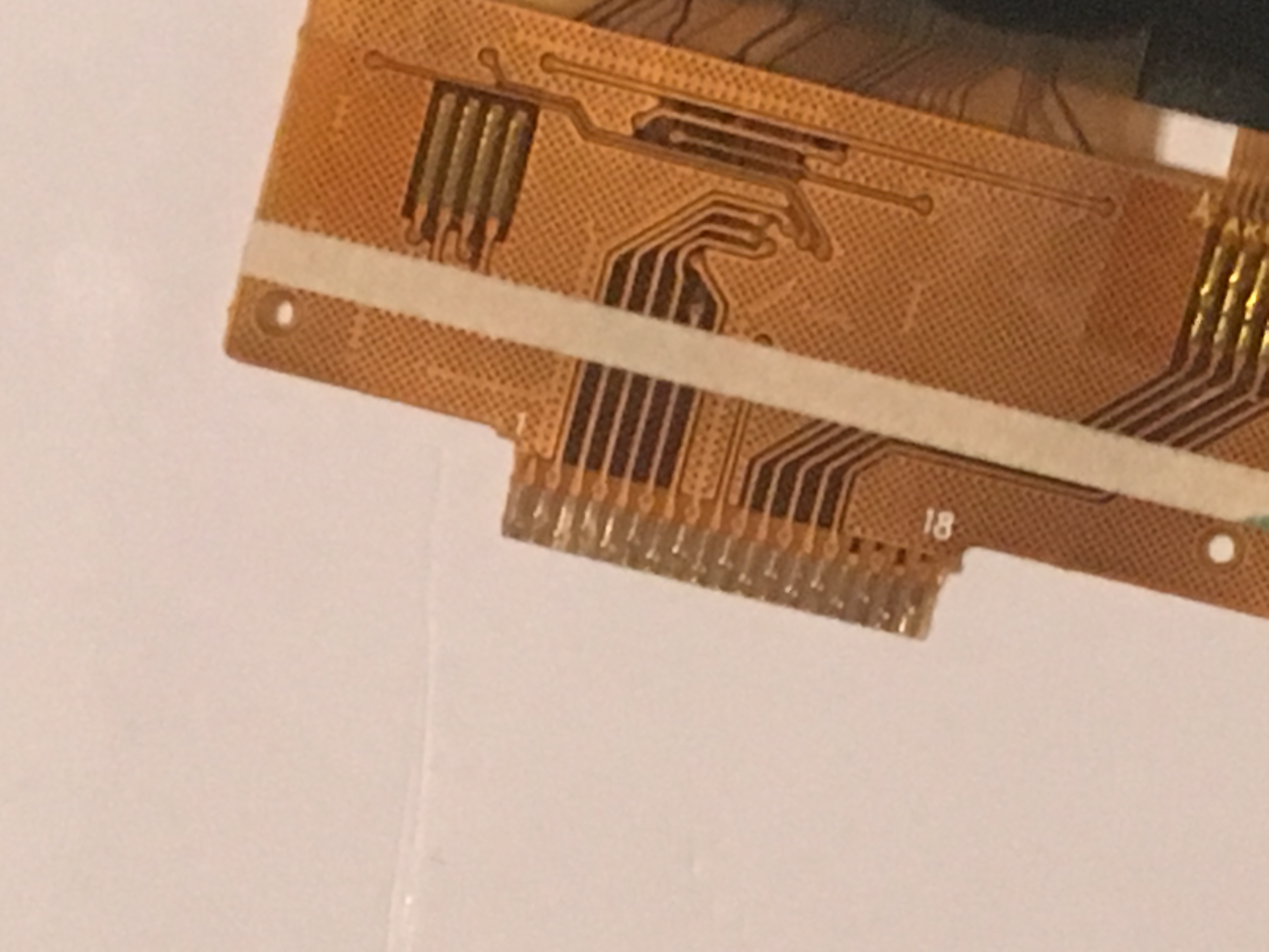

I noticed my display connector appears to be broken, and bent even. I have tried to trim my cable and went as far as 4 layers of masking tape on the ribbon and it will not lock into place, if I lay my finger behind the ribbon I can get the screen to light up but it just stays white. I have tested to see if it will boot with my HDMI port and it boots fine. I have rechecked my continuity and all is well with that. I have attached the best pictures I could take. The side that is bent will not lock into place with or without a cable and Is actually separated from the connector.
- IMG_4852.JPG (819.86 KiB) Viewed 8230 times
- IMG_4849.JPG (1.88 MiB) Viewed 8230 times

2 layers of tape is the max not 4 as I can see the connector lock mechanism bulging out of the socket and it's likely going to break. Where is it bent? The ribbon looks fine to me and as I mentioned in another thread the last 4 pins are not used at all so if those are bent or broken they don't matter so long as the others are fine.

Looks like I broke off the first pin on the ribbon :/ a piece of tape came off in the connector and when i stuck the ribbon in, it bent up and broke off inside... I've cleaned out the connector with some tweezers but now cant get a connection from the first pin inside the socket. How/when do you think I can I buy another screen? Thanks

Pin 1 is ground, you can try scraping the yellow area on the whole ribbon and solder a wire to the back of the pin or just send me a PM and we can arrange something.
