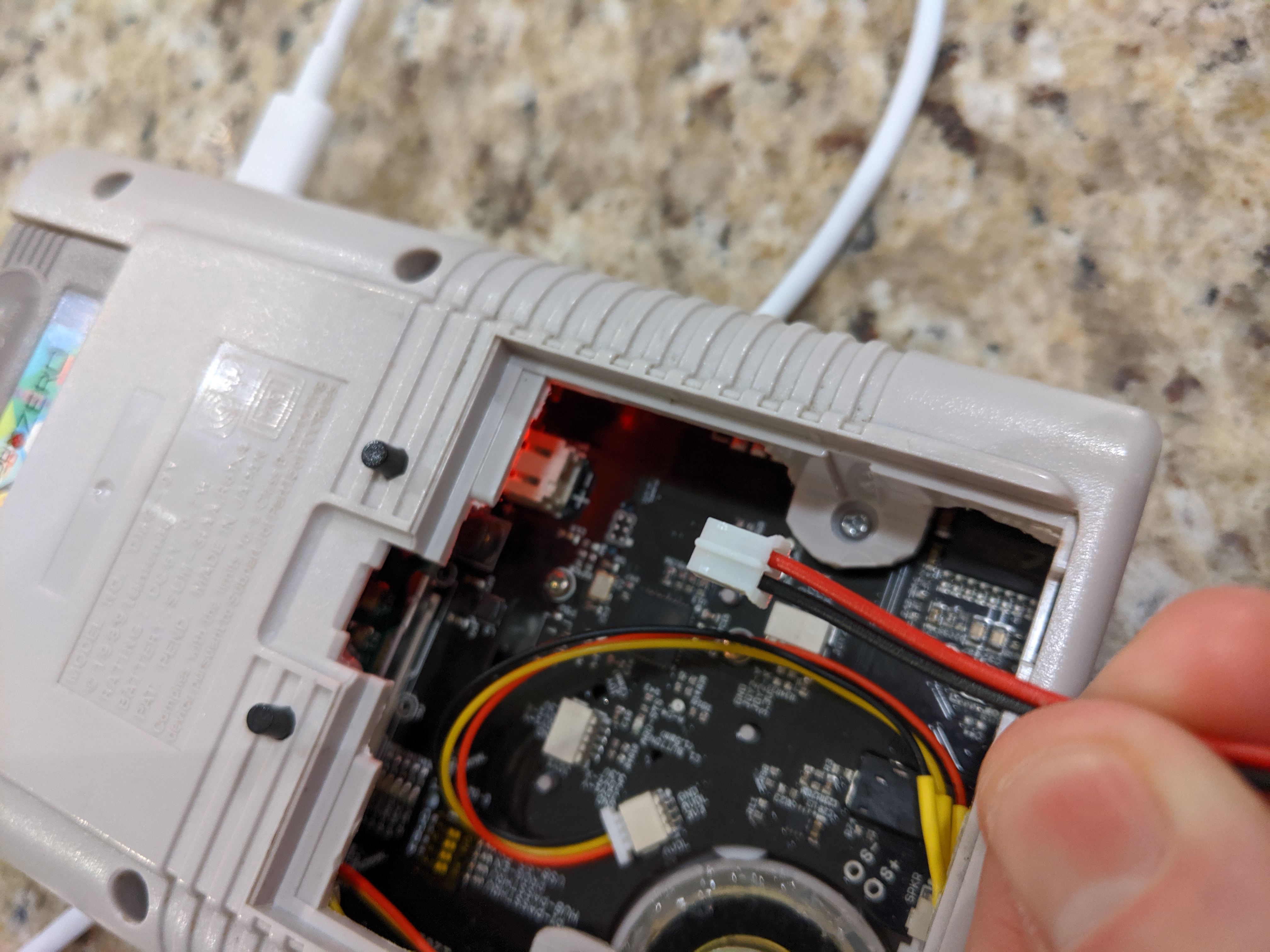

Just so for my own sanity. I still need to change the polarity of the wires before plugging into my Circuit Sword?
Curious why this isnt possible to be done when made? May I recommend including a little warning in the package in case people forget to or don't read

Re: [SALE] MegaBat 4.5 (a 4500-4700 mAh battery for the GBZ) USA Only!
tlxxxsracer wrote: ↑Thu Jul 25, 2019 1:30 pmCurious why this isnt possible to be done when made? May I recommend including a little warning in the package in case people forget to or don't read
there is a clear warning on the first page of this post....
(and a link to instructions to swap over the connectings to be used in products that DON'T follow the general standard)
and where your directed to purchase from Helder site....
there is another mention of this....
(even thou this one does make it a little confusing
if the purchaser forget this, then this is really on them (there have been clear mentions/warning for this).....
the polarities are in accordance with how most (about 90%, if not more) of the batteries come as.....
it is Adafruit that has this different on their Power Boost and also Kite on his Circuit Sword....
the MegBat 4.5 has been made/designed in accordance with how all other batteries (with connectors) are made
I bought it from the OP. I'm confused cause I did the wire swap but seems it was already swapped because after I swapped my wires they're opposite of what shows in the how to guide. See my image after I swapped the wiresVeteranGamer wrote: ↑Fri Jul 26, 2019 12:30 amtlxxxsracer wrote: ↑Thu Jul 25, 2019 1:30 pmCurious why this isnt possible to be done when made? May I recommend including a little warning in the package in case people forget to or don't read
I bought it from the link in the OP. I followed the directions but it seems the wire was already swapped, now I'm just confused.

Re: [SALE] MegaBat 4.5 (a 4500-4700 mAh battery for the GBZ) USA,Canada & Mexico Only!
Yes I forgot to remove the mention of the swap, all new batches have the wires the way adafruit and Kite's board have it setup. No more swapping it out and if in doubt use a multimeter, which anyone who does any of these builds should have.
RIP my Kite board. F
Edit: so it seems that it's not dead (somehow). I had the usb-c and battery plugged in when I turned it on. That might have saved me. I swapped the wires and still turns on and charges!
Update: Charging is no longer working. but will operate on battery.
