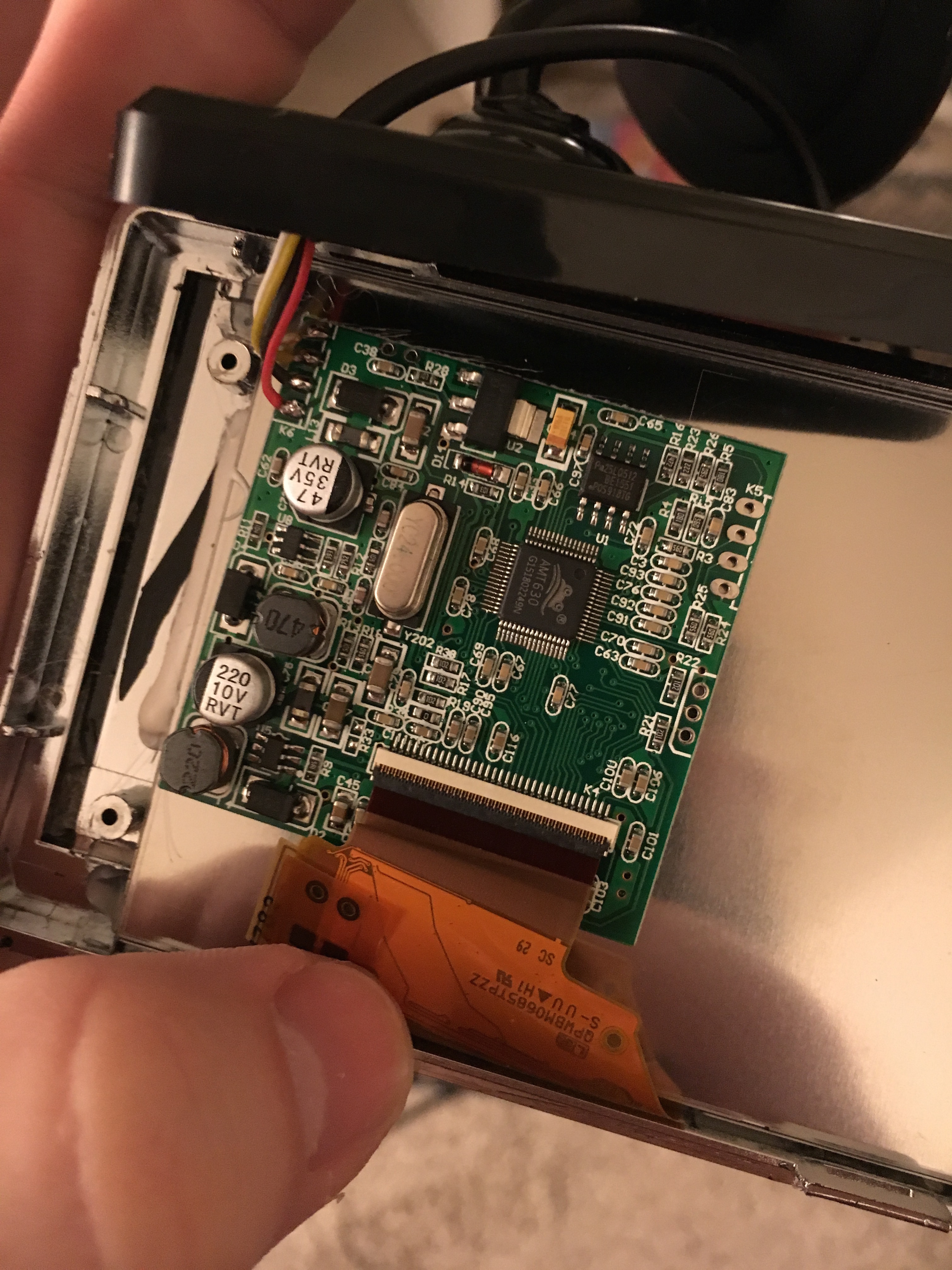

Post by mike_louisxvi » Mon Oct 31, 2016 5:13 pm
Hey everybody. I am new to this project, and pretty novice when it comes to much of this. I am trying to learn as I go along and use this project as a way to better understand wiring and electronic components. Please bear with me.
I ordered the screen from amazon from "ATian Direct" since it was on Prime and I saw that some of them were working out. I wound up with a case that doesn't have screw holes, but only a click-together back, and no contrast buttons. My board looks like this
After some searching, I found this topic: http://sudomod.com/forum/viewtopic.php?t=89&start=20 , in which someone else got the same board, but sadly removed the wrong IC pad and ruined the screen. Obviously I wont be removing the 8 pin pad, but does anyone have any advice on how to go about using this screen? Someone mentioned using a multimeter probe to check out the pads to see if anything was converting to 5v, but could someone explain more in depth what that means/how to do that? I was hoping I would either have to just solder on a jumper wire like the others, or take out an IC, or do both, which I can do, but I dont know exactly where to modify.

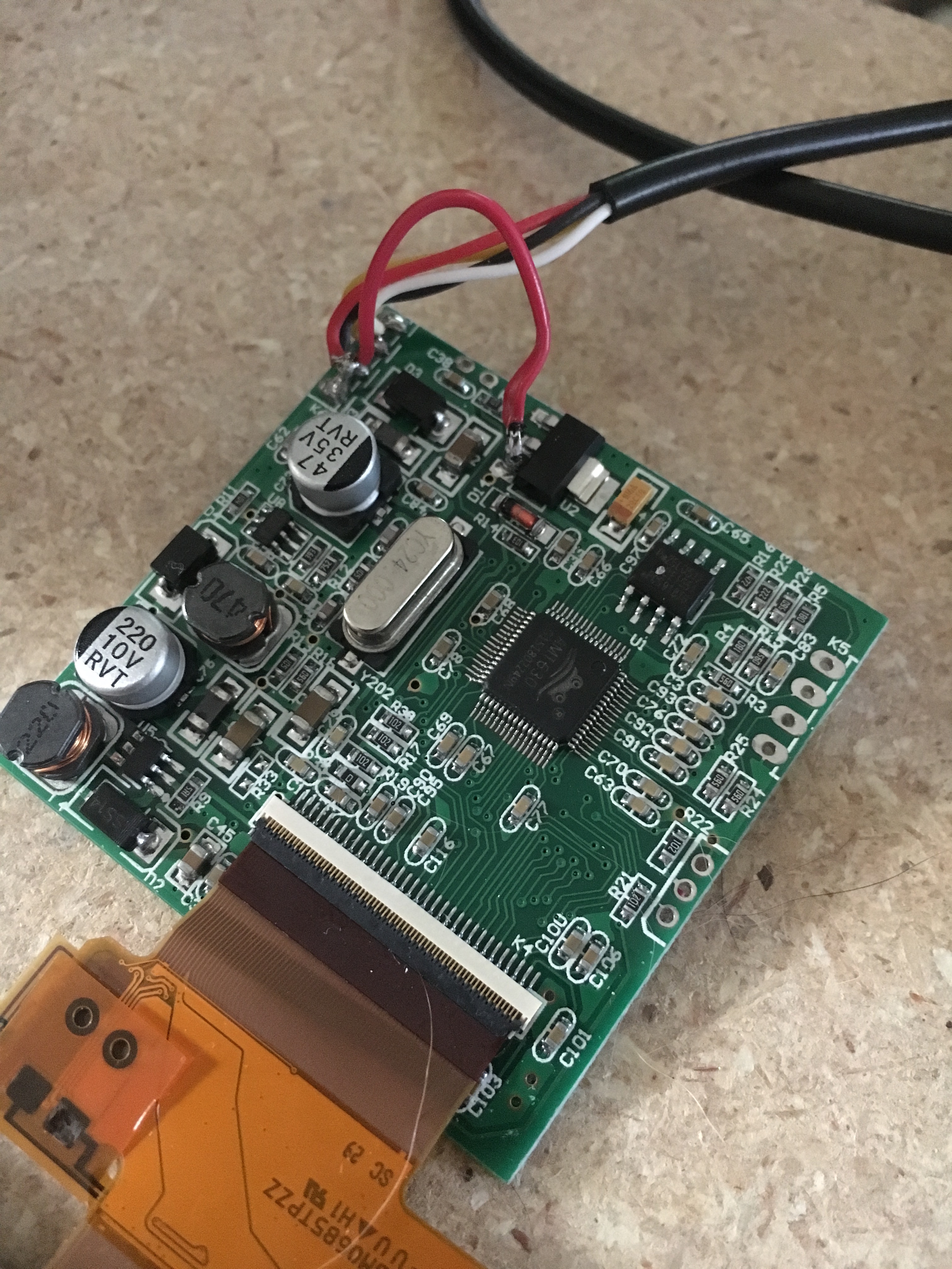

Post by mike_louisxvi » Wed Nov 02, 2016 3:07 pm
I am posting here and the other thread for visibility. Hopefully this contributes to the conversation and some people have an idea of how to go forward with this screen here.
Okay, I have an update on my screen.
I wound up wiring a 22 gauge red jumper wire like in the picture. I used a more rigid, bendy copper wire than the other wires I was using, so hopefully that was the right choice. My soldering isn't the best, and it kind of lifted the initial red wire out of the contact point, but the solder is holding both of them in place, just a little higher up off of the board.
Here is a photo of this:

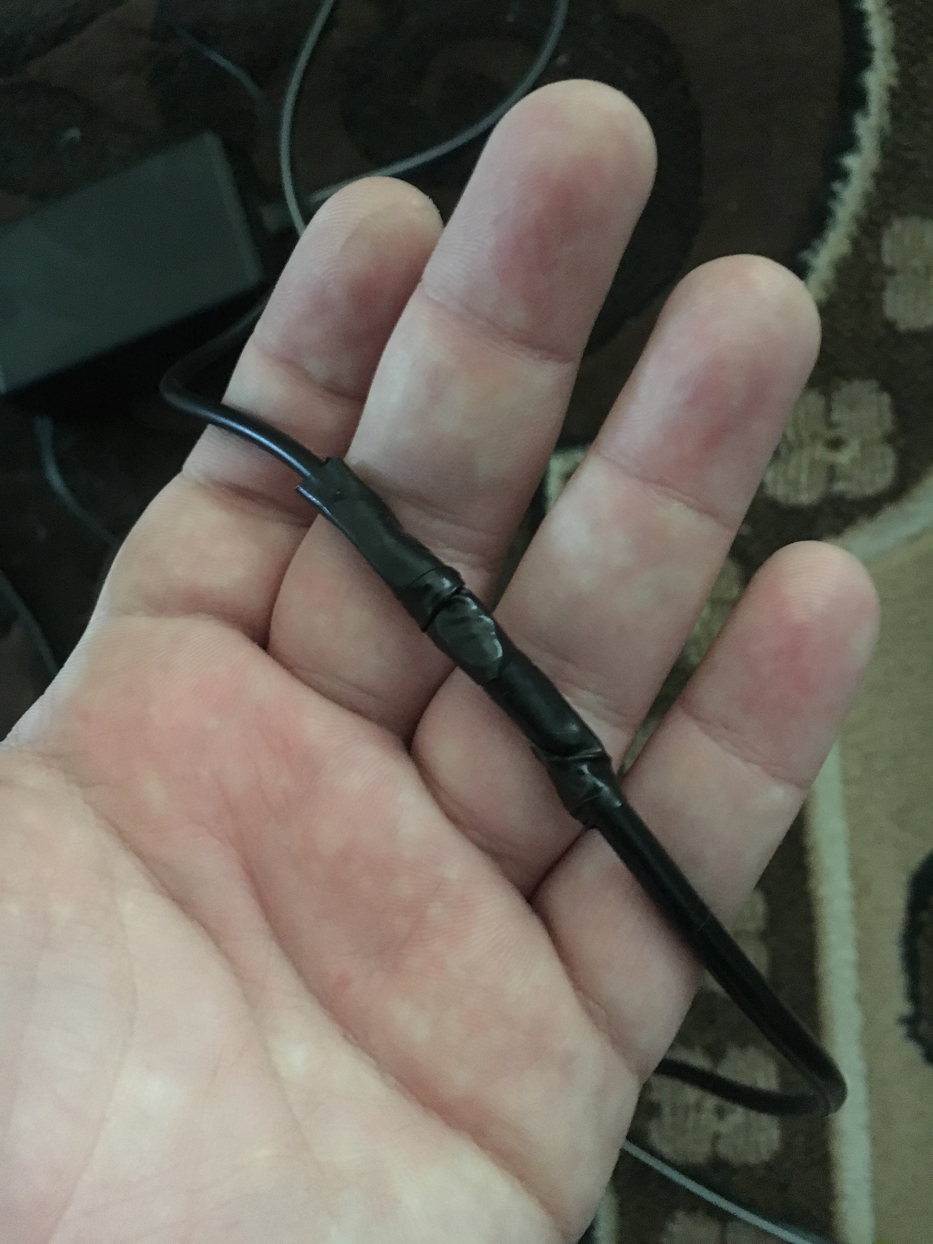

Like I mentioned before, I wired up the power cable that came with the camera to a 99cent store USB, disregarding the two data wires:

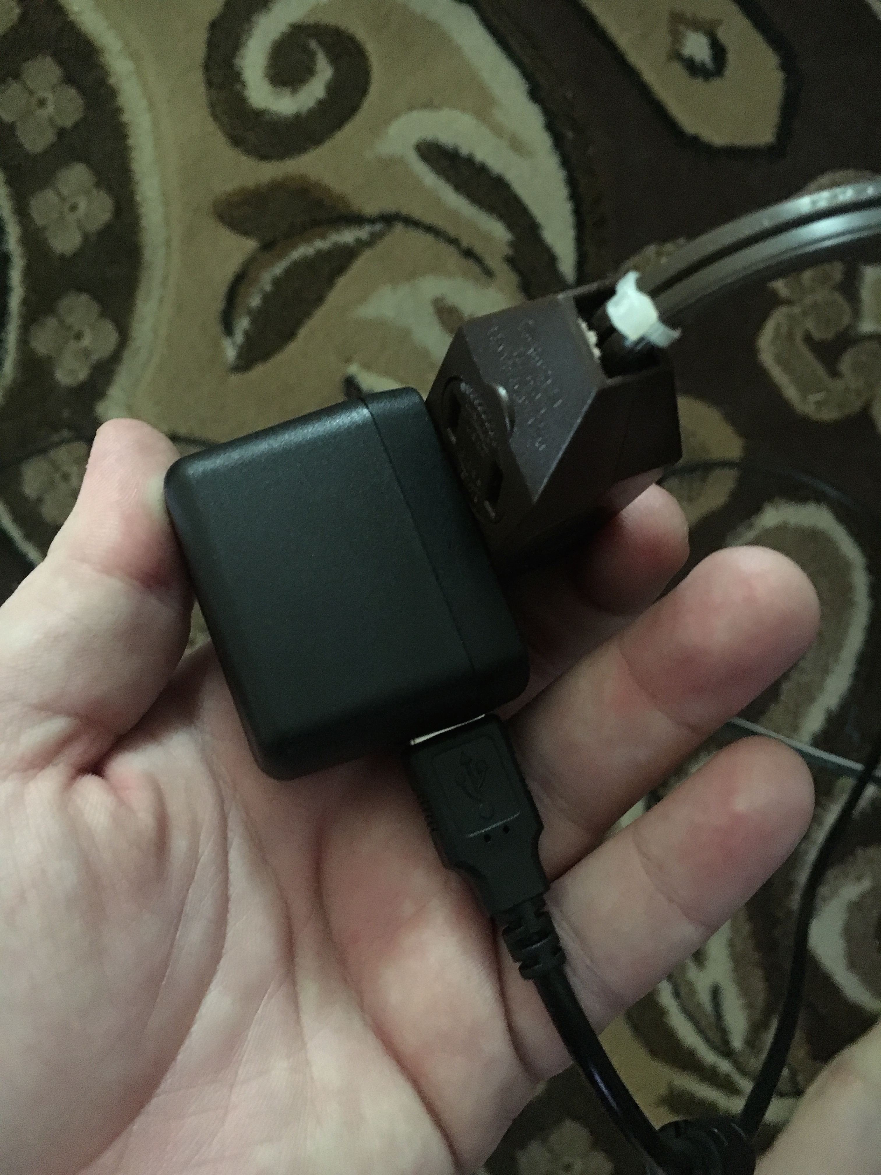

Which is plugged into a 5 volt (5.1 actually, i think) power block from a chomecast I had laying around.

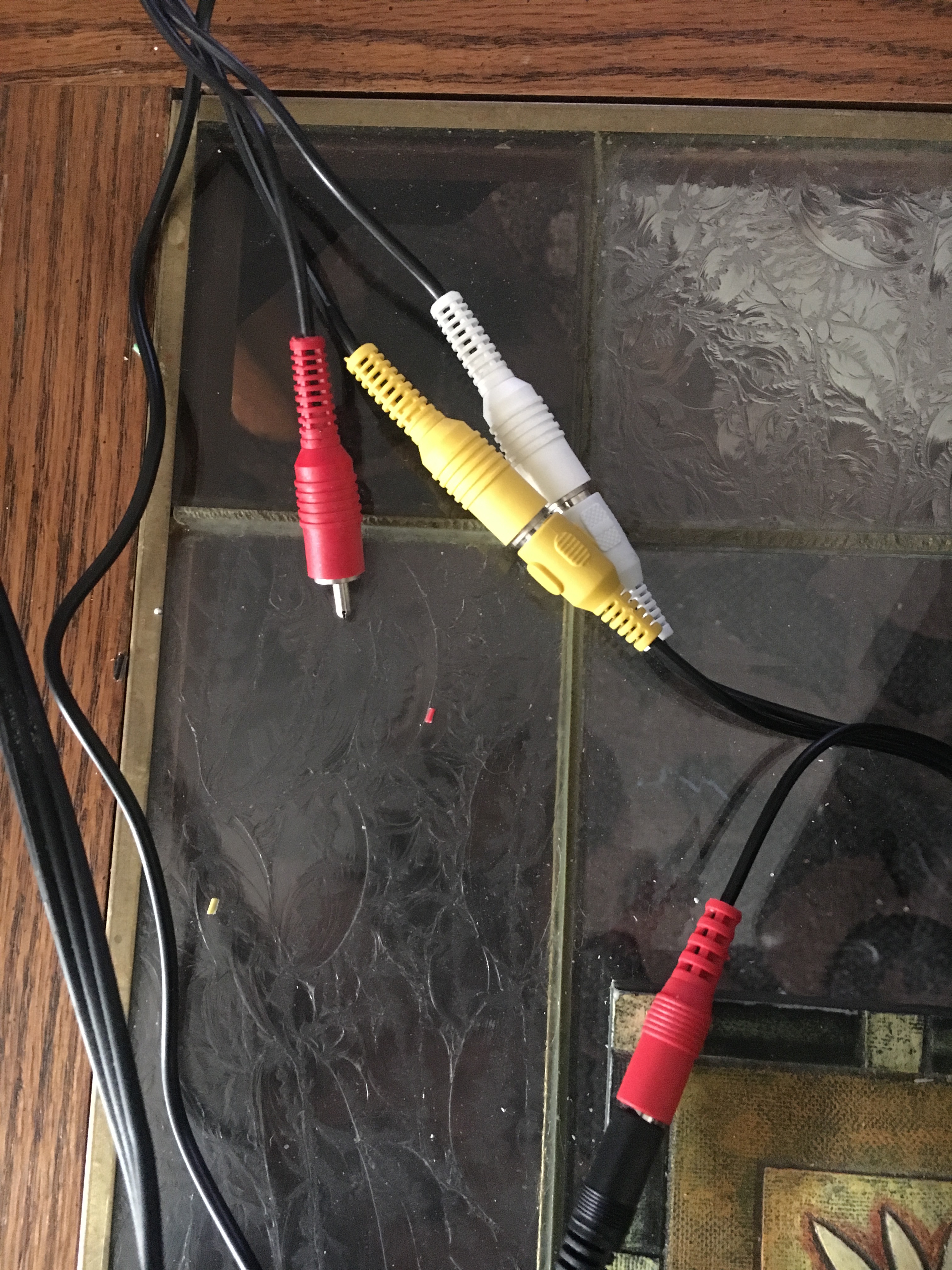

I then used a gamecube to plug the composites into the wires that were given with the screen, which is wired up to the board

@mike_louisxvi
I don't have your screen but most have 2 video channels and if you connect both at once it does what you've shown in your animated image, a conflicting signal. Try removing the white connector (so just power and yellow are connected). If no luck, plug the white back in and unplug the yellow connector (so only power and white are plugged in). Worth a try perhaps.

I found out from the other thread that I was in fact doing the wrong thing by plugging both of the cables in. I found that the yellow cable was the one that seemed to work, so I de-soldered the white one. Alas, the same problem occurs.
I soldered the yellow wire into where the white wire was just to see what would happen, and I noticed that "AUX 1" shows up on the top right, and it didn't before. I soldered the wire back to where it was before, and it went away. Then I bridged the connection between the two spots with solder (just the yellow wire touching), and I got the "AUX 1" back. It seemed to kind of brighter too. The AUX thing stays at the top and doesn't go away, which makes me think it is in fact switching between two channels...but I'm not sure how to get that to stop. There may be no solution..
The screen looks really bright and good, which leads me to believe that the power might be good. I figure if its too low voltage or something, that I would get more of a dimming flicker or somewhat stable but intermittent flicker. This looks very much like a channel changing over and over. It's very consistent. Hmmm..
