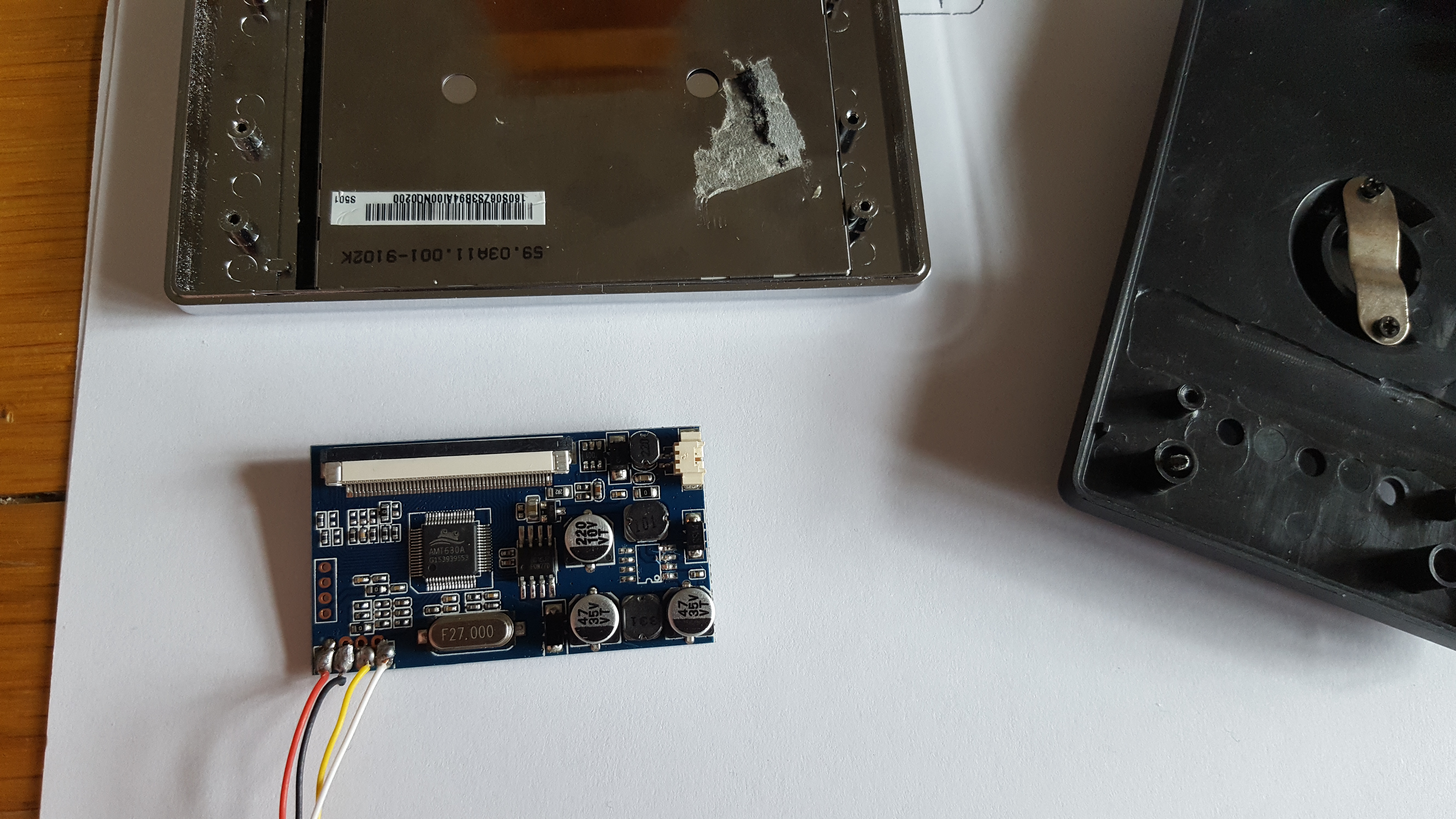

Hi,
I'm new to the electronics wiring and circuitry scene and this forum. So I'm not 100% sure this board even needs a 5v rewiring. If anyone could be of assistance I'd greatly appreciate it. Also if anyone has tips on removing the double sided tape that came in the back of the board.

We'll need a photo of your board.

Oh sorry, tried posting it through my phone the first time.
I uploaded them to Imgur instead. Here is the link. Thanks!
Main Board
http://imgur.com/llPIHNL
Taped side
http://imgur.com/qcI3vBB

Re: Modify screen board for 5v
Post by Armstrs » Sat Oct 08, 2016 1:09 pm
That appears to be what the forum is calling the v7 board. It looks like mine which I just tried last night. Totally worked unmodified, but there was some flickering. Not sure if this is what the jumper wire fixes. I have read people recommending modifying the v7 board but I have not seen an image of it with the jumper wire on here yet.
Post by Psy128 » Sat Oct 08, 2016 1:39 pm

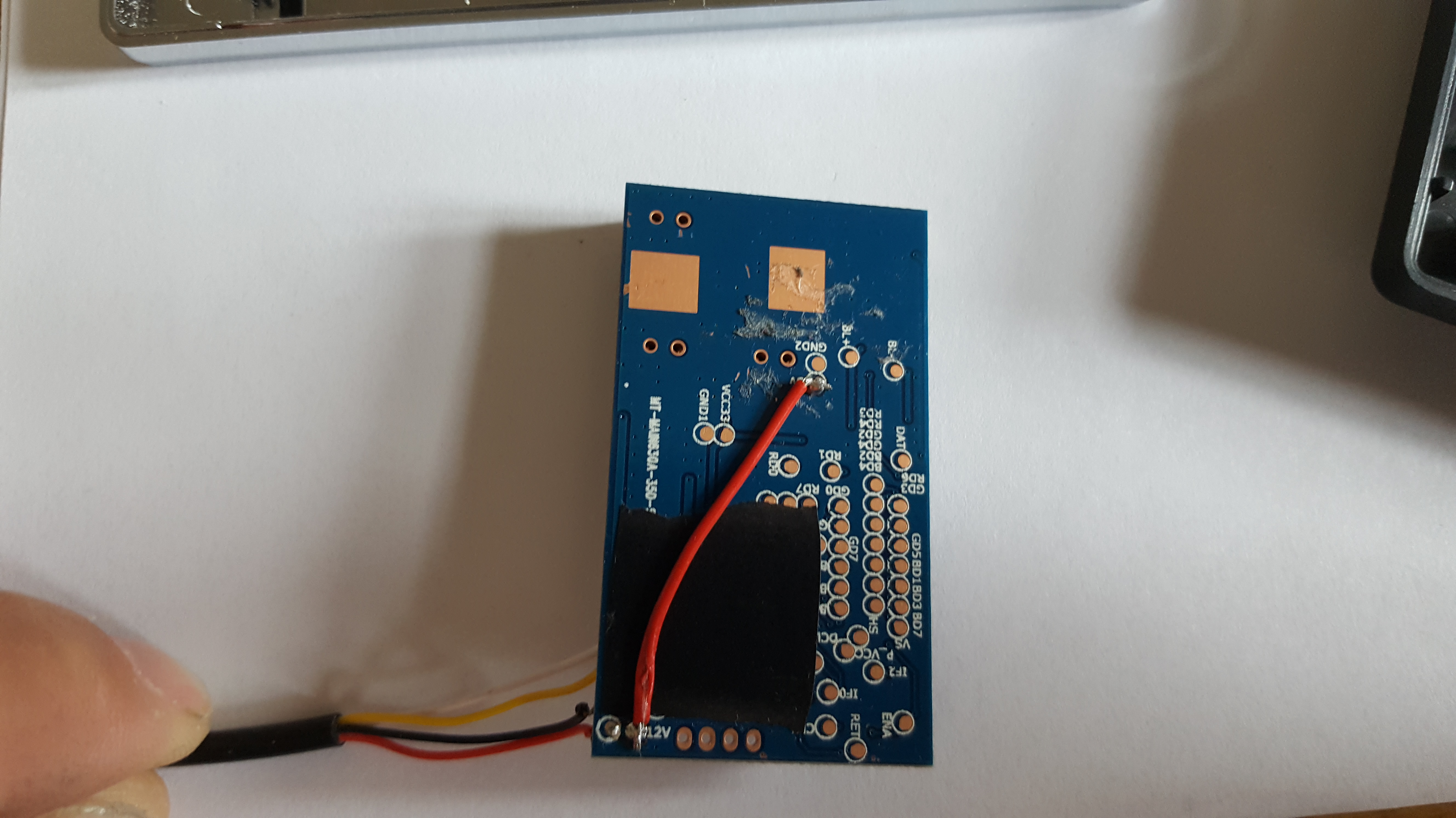

If this one the same I cut out the chip due to flicker then on the back is a 5v pads which I soldered a jumper wire on

Post by Psy128 » Sat Oct 08, 2016 1:48 pm
When I say chip i do mean the voltage regulator lol :mrgreen:

Post by Jpayne30 » Sat Oct 08, 2016 4:30 pm
Psy128 wrote:If this one the same I cut out the chip due to flicker then on the back is a 5v pads which I soldered a jumper wire on
Thanks I'll give this a whirl and see how it goes!

Post by derebbe » Sun Oct 09, 2016 10:13 am
I received a v7 board as well and did the mod mentioned above. I removed the voltage regulator and put this extra wire - I can't see any difference compared to without modding the voltage... :)
Post by Psy128 » Sun Oct 09, 2016 12:46 pm
Most people don't have a problem and works with no issues .I wanted my one to run off 5v when I got mine it worked but i had a flicker on the screen and i did what I did works fine with no flickering across the screen and its been in my gbz over a month. These boreds are always different some may look the same as well just depends on where you brought it. Some people solder straight on the leg on the voltage regulator you do what ever is easyist for your self .
