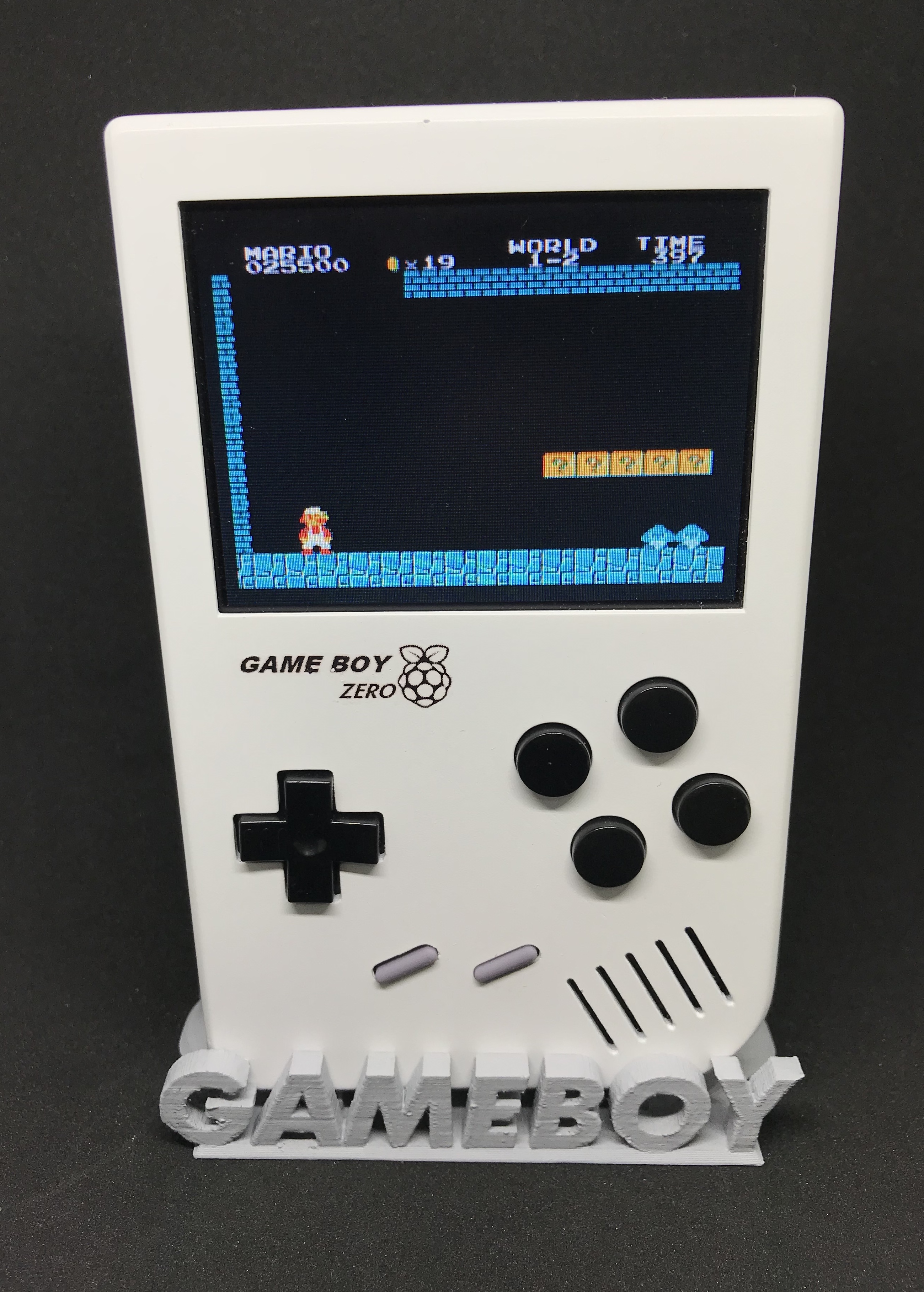

[WIP] CAD designed and 3D printed GB Zero case
neolith
Posts: 192
Has thanked: 101 times
Been thanked: 160 times
Re: [WIP] CAD designed and 3D printed GB Zero case
Post by neolith » Thu Nov 23, 2017 8:15 am
Wow, that's a good looking result. Impressive!
Post by MickeyMustang » Thu Nov 23, 2017 8:18 am
Hey moooarcuuuus, yes, this should be mentioned. Thank you for designing the holder. Love it ^^
Post by ThompsonTinkers » Thu Nov 23, 2017 1:36 pm
That's gorgeous!
I've been wavering back and forth between straight up 3d printing, or 3d printing with a laser cut faceplate. This is definitely inspiring me to keep it printed.
Post by moooarcuuuus » Fri Nov 24, 2017 12:02 am
Very smooth for a fdm print. Impressive.
Another way to smoothing is rough sanding and coating with epoxy.

Saw this on Retropie Handhelds, amazing results.

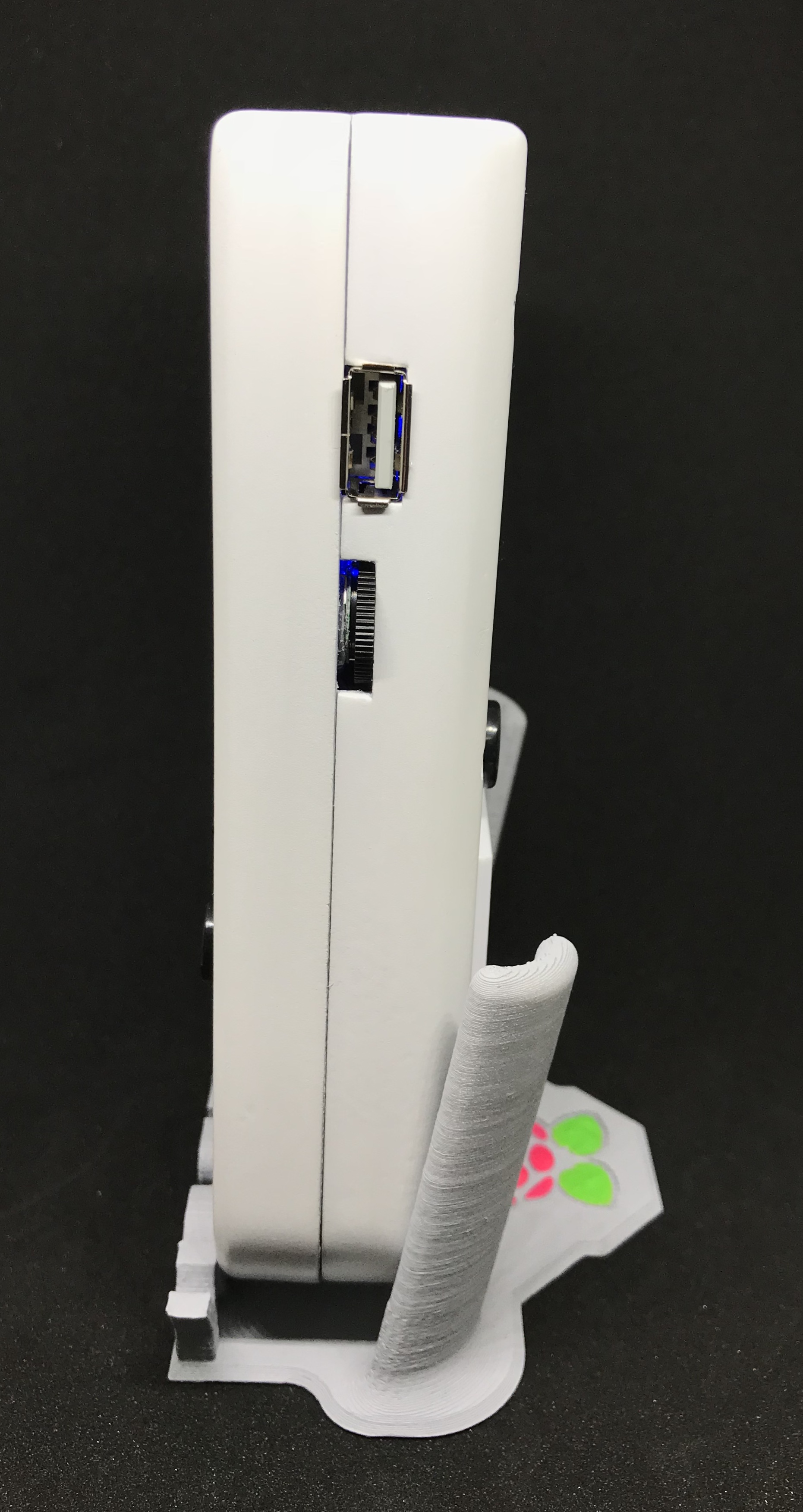

Post by MickeyMustang » Wed Nov 29, 2017 8:03 am
I managed to finish the GameBoy. Everything except the closing lid is done. I still have to design the lid, but I put the GB together already and it's working fine. The audio volume is too low to my tase. Mainly because I cannot adjust the system volume. It always stays at 0%, no matter what settings I change. I had it running before so I think I just have to tweak it software wise. If anyone has an idea how to fix this, please let me know.
The case itself fits together quite well. I would like to fit it even better, but for now I need a break from this project lol. I uploaded the files to thingieverse:
https://www.thingiverse.com/thing:2676949
I uploaded some more pictures of the assembled Game Boy.
I would be interested in seeing other people using or altering it, so please show me your results :)
