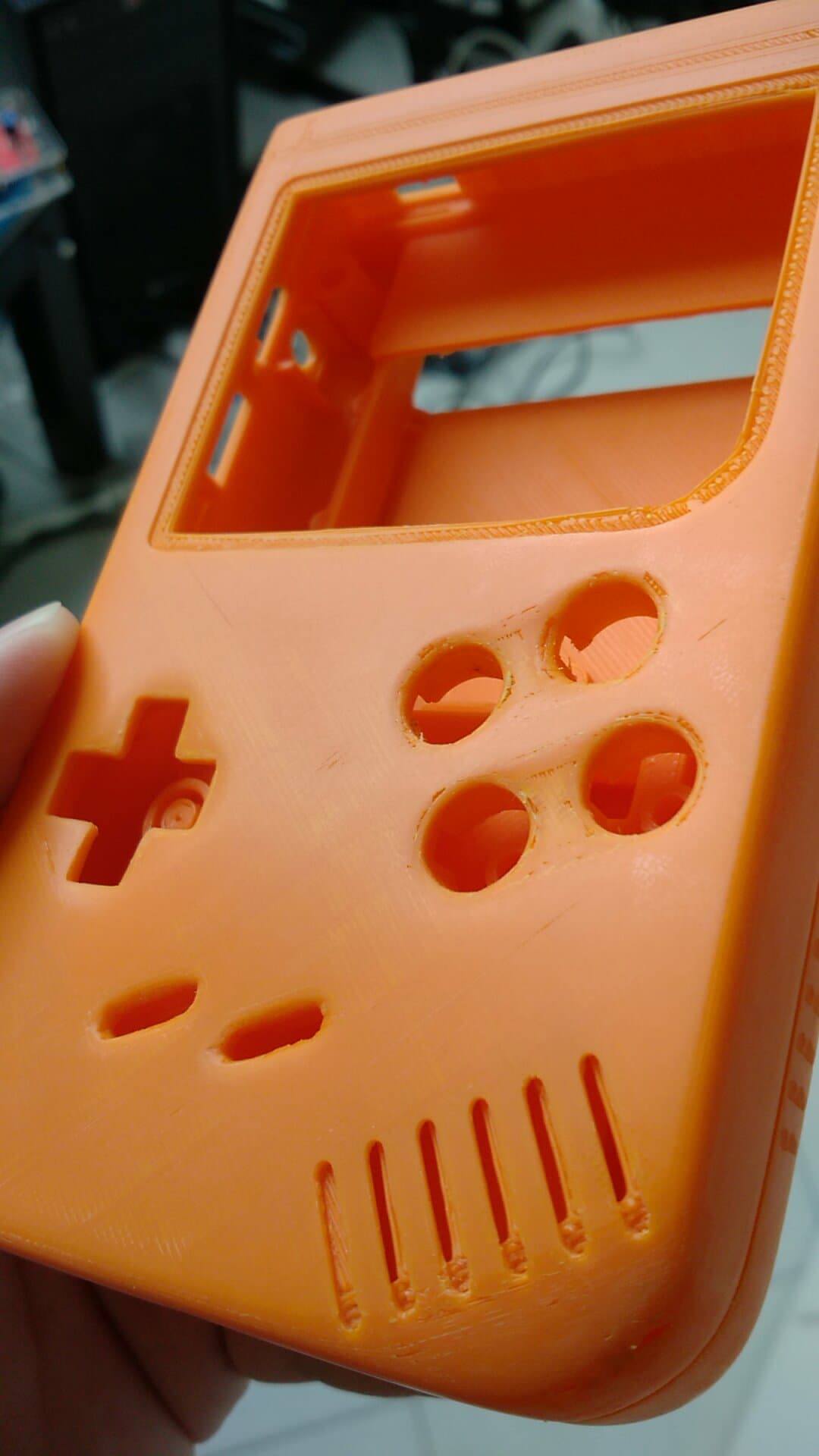

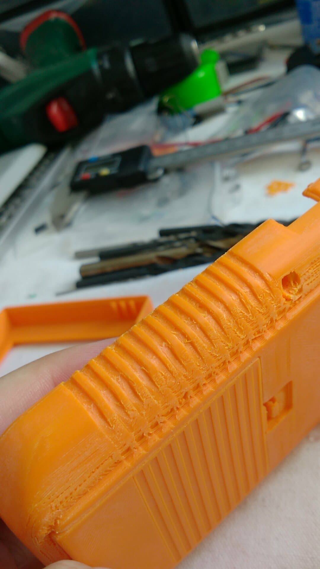

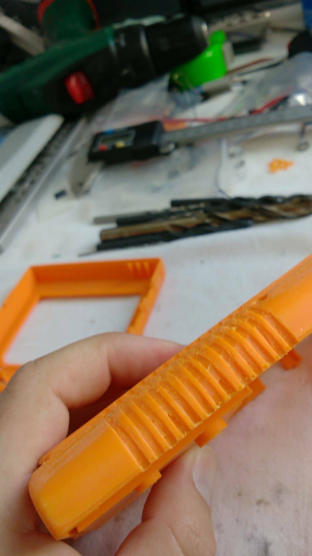

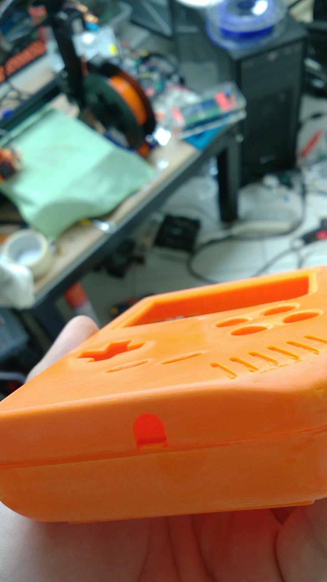

Hey ! I saw your print nice one too !
With some elbow grease and time, i started to sand the model in a way that you cant see the marks left by the "slising procces" (from CURA in exemple) . i used many sand paper size to achieve such "shiny" case :D 120 => 240 => 320 => 400 => 800 => 1500 => 3000 . I think using sand paper only, was a mistake : for the next case i printed yesterday, i'll use a proper grater because PLA from E-iCE is warming up very quickly even without applying so much force on the sandpaper .
i took me 5h to sand the whole case . but i added some more details using a metal grater . like on thoses pictures on the attachement .
i think the best way to process the "hollow" on the buttons ( i mean like on the real GB ) is to use sand paper and try to sand applying force . but this will be not really good :/

Really cool finish. You can try using water with the sanding paper to achieve a better result ! How do you think you are going to finish the small gaps on the outsides ?
Did you try some acetone vapor to give a glossy finish to the model ?

yeah i was really impressed on the print quality from a USD 280 3D Printer :) the bad quality on the rear, where all the filament is bad and misaligned , was because my glass was not secured correctly with painters tape ... i had a woobly glass and that was funny to watch for sure , but not funny at all after i discovered that eheh . so while printing i added some more tape to secure the whole thing
i think adding melted PLA from the nozzle on the top of the case will do th trick but it's pretty risky, also, i can fill with some paste ( i dont know the word in english ) you know this past that is used on the walls to fil gaps . then paint the case . but i never done this before . so it will be totally new experience for me .
i already heard about acetone vapor but never done it too . i think i have to test this on small parts first :)
for the side finish, i think using small grater will be ok but i think apply correction to the model to allow the edge to be more visible could be a solution to this . i think apply acetone with soft brush can be done this way too but never tested it before . Ad far as i know, pla is does not react as the ABS reacts. but to verify that , i have to test it before

acetone vapour only works on ABS. if you're using PLA then it doesn't work. The filler you'll want to look for is car body filler rather than wall filler. It sands smooth where wall filler tends to be grainy. In america there is a product called bondo that everyone uses. in UK there's P38 filler.
