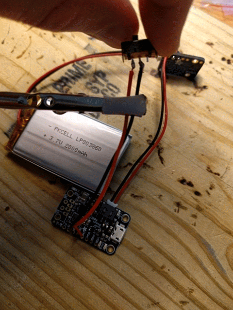

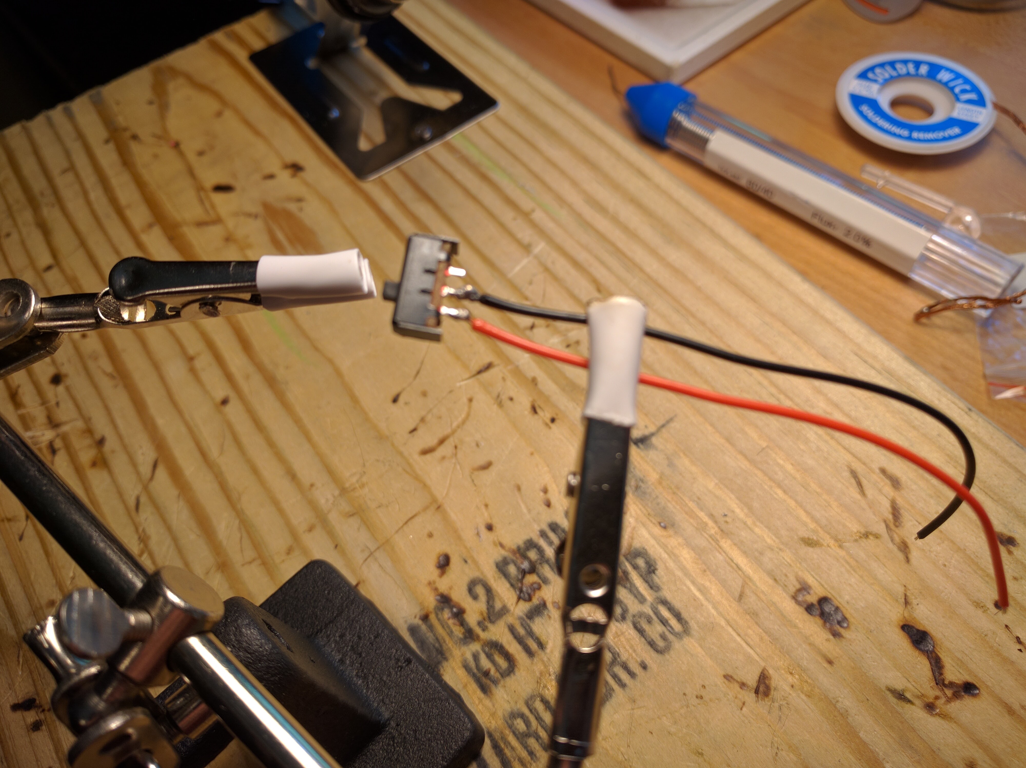

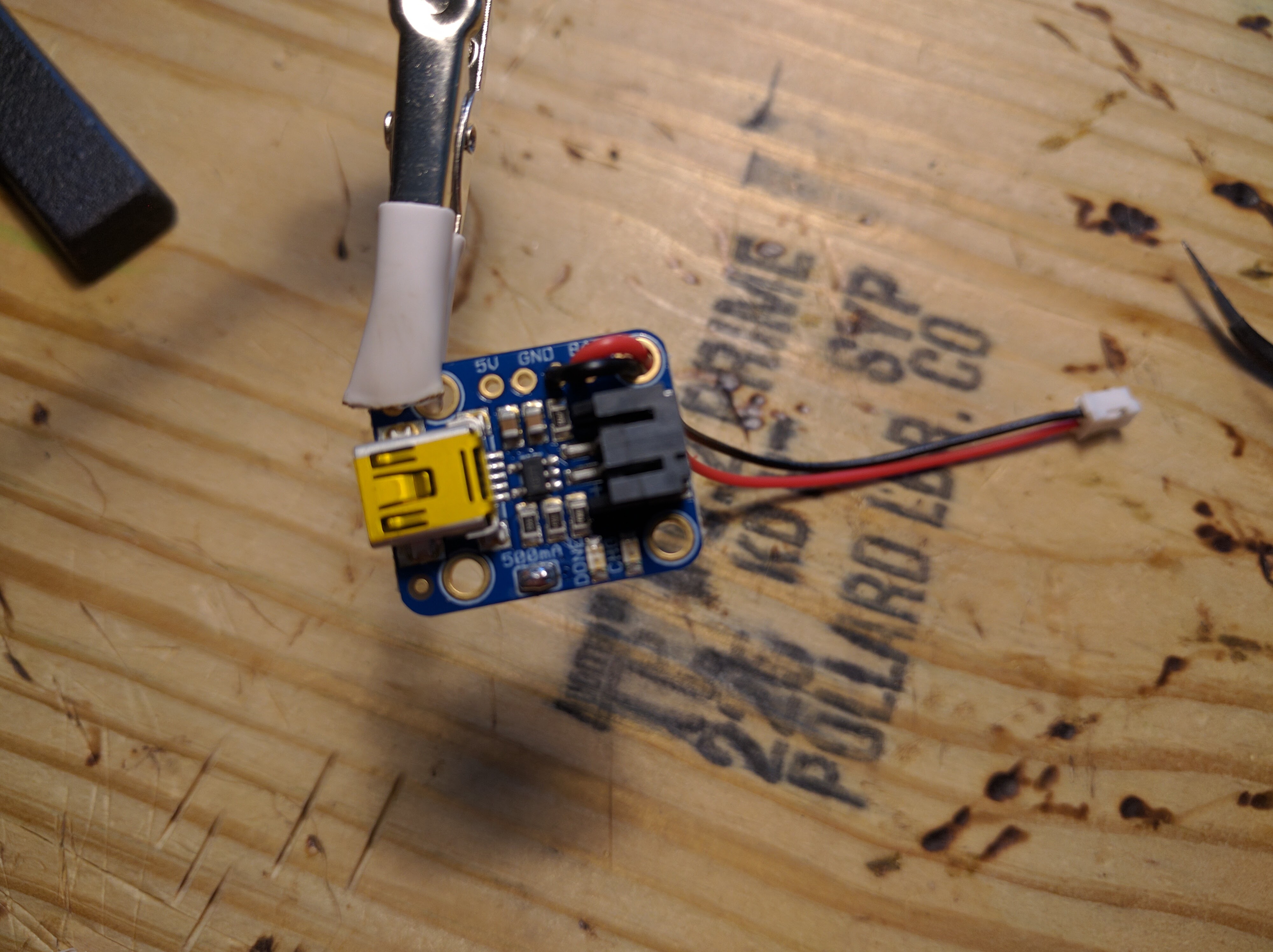

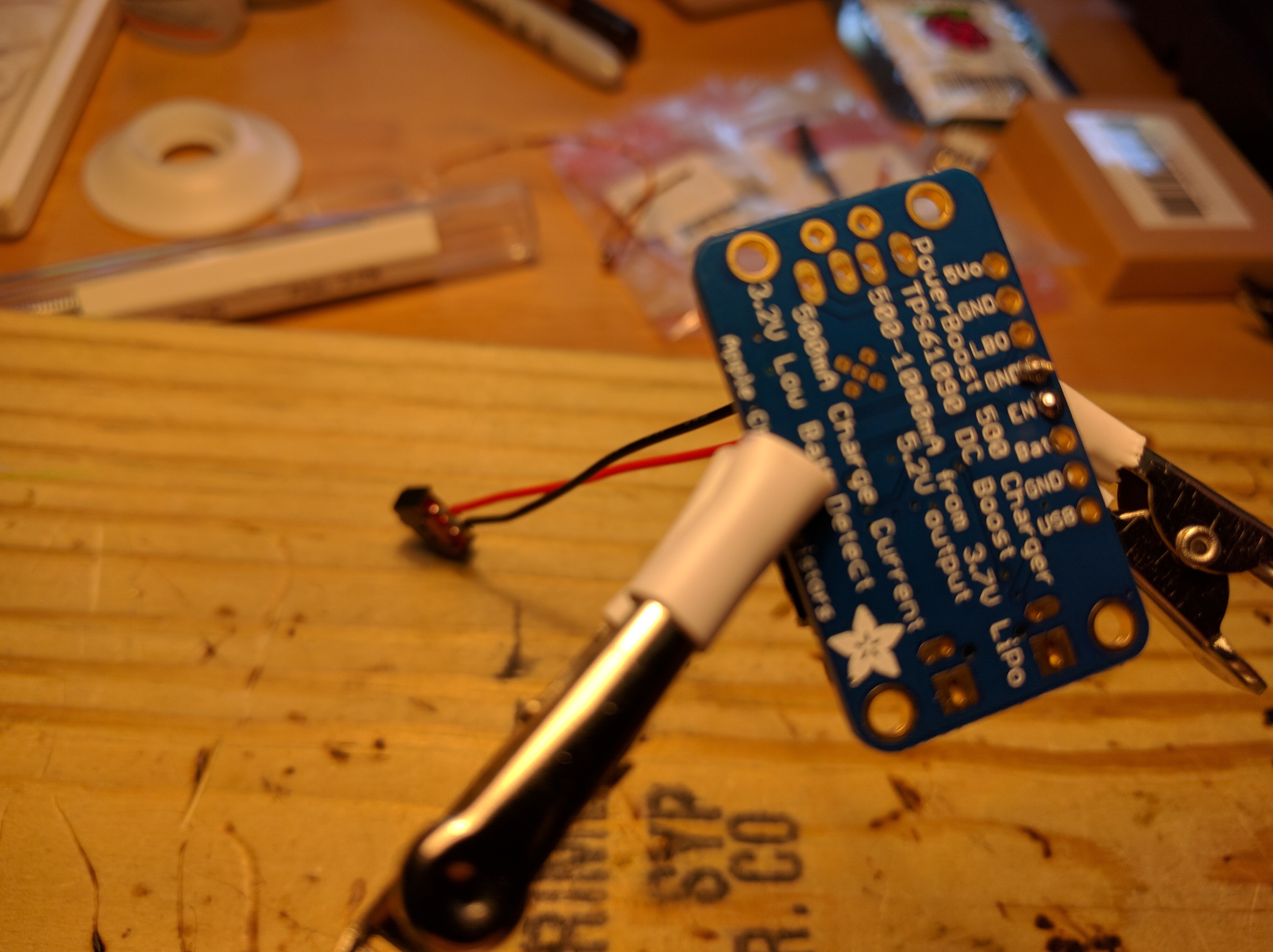

05-15-2016 Progress (Battery):
All the items for my connections came from adafruit.com
This is the guide I used: https://learn.adafruit.com/pigrrl-raspb ... er-circuit
I need to cut these down a little because it would not fit in the GBZ when I attach the legacy power switch later.
Here it is cut down a bit, I took off about 70%.
We have power!

Hi, can you explain why you use these components.
Why not just the PowerBoost 1000 Charger - Rechargeable 5V Lipo USB Boost, https://www.adafruit.com/products/2465 for example?
Why do you need the Adafruit Mini Lipo w/Mini-B USB Jack ?

davidn wrote:Hi, can you explain why you use these components.
No reason, I was just following the adafruit guide. Do you know of a reason why you need to use the 1000 one?
[mention]wermy[/mention] can I use a 500 powerboost instead of a 1000? the 1000 seems to be sold out. Any alternatives?

Popcorn wrote:Apparently the reason the 1000C was chosen over the 500C is because the draw of the RPI0 was about 500ma when powered on, which gave no headroom when in charging mode. So if you were to be running the PI and trying to charge it at the same time, the power to the batteries would be underpowered and could cause problems. So, it was advisable to stay in the safely rated solution of the 1000C. However, IF you never plan on playing while plugged in, and only charging when the unit is off, then the 500C should theoretically work. Let's just hope the battery doesn't blow up :P, or more realistically, die on you from being undercharged.
Hope that helps.

Thanks, I guess that is my mistake then on the 500 model. I will get one from ebay because they are sold out everywhere else it seems.

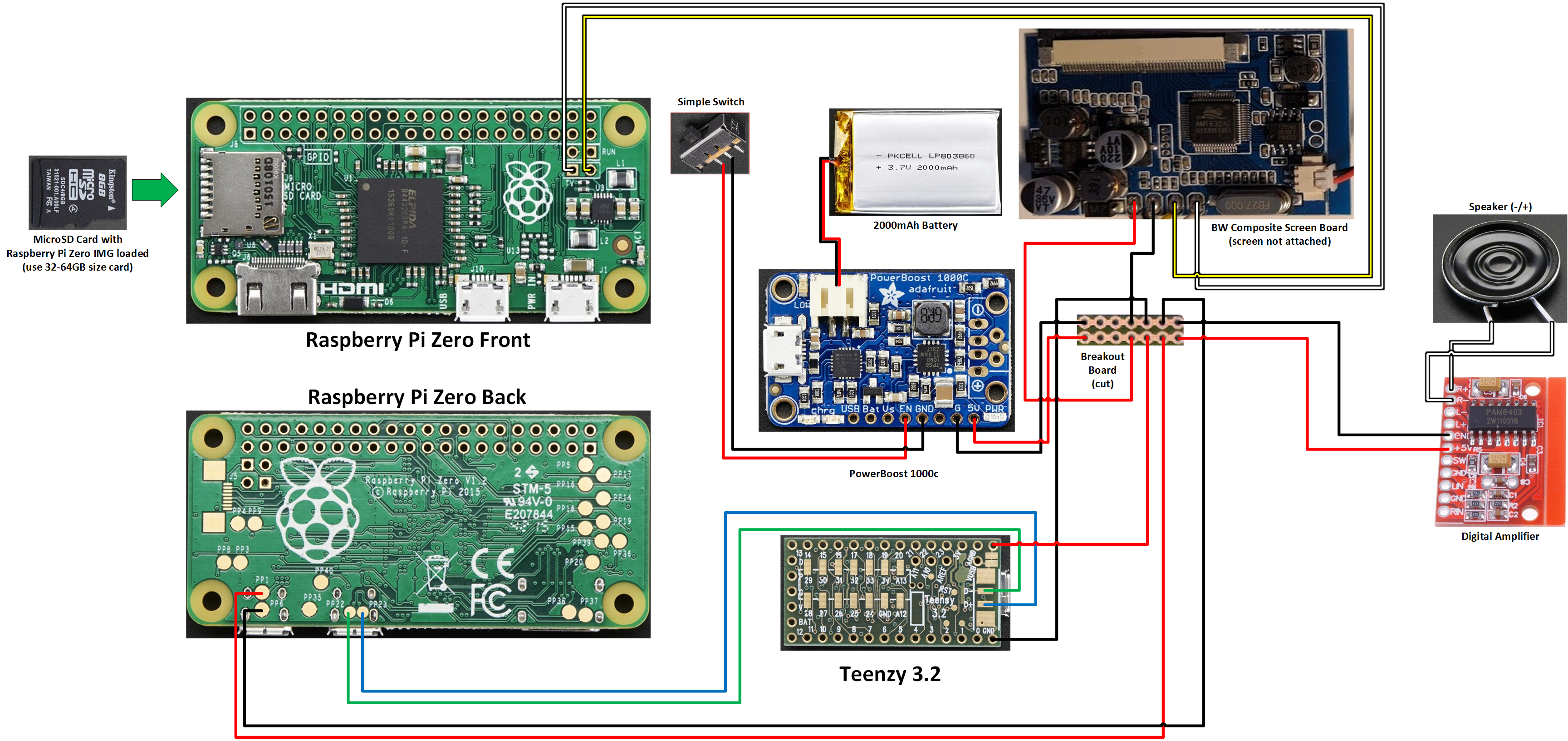

I took [mention]3y3c0ugh[/mention] drawing and added what I did to mine so far. I will add the rest of the components when I see the rest of wermy's videos.
+[mention]wermy[/mention]
I am not able to get the Teensy working or the speaker so do not use this diagram yet. I will update it when I figure out my problem.

dirtybeagles wrote:I took [mention]3y3c0ugh[/mention] drawing and added what I did to mine so far. I will add the rest of the components when I see the rest of wermy's videos.
Thx. Diagram really helpful.
