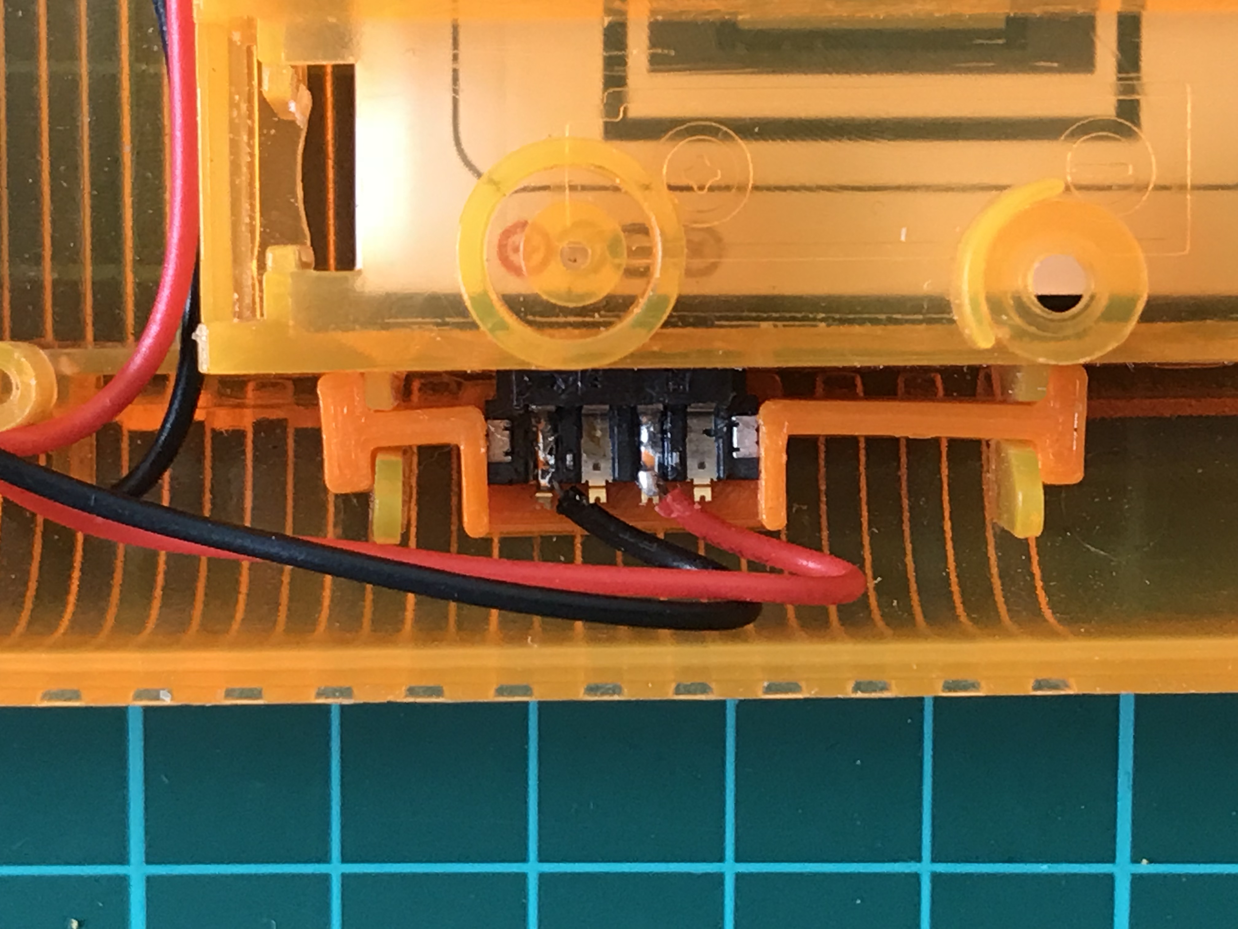

I had to dremel many part except the pogo pin holder. This one was perfect, the connector sat on it as if it was designed for him :lol: i had to force a bit and the pogo pins was able to stand alone on top of the support.
Here are some pictures
Now the support cannot twist anymoreShow

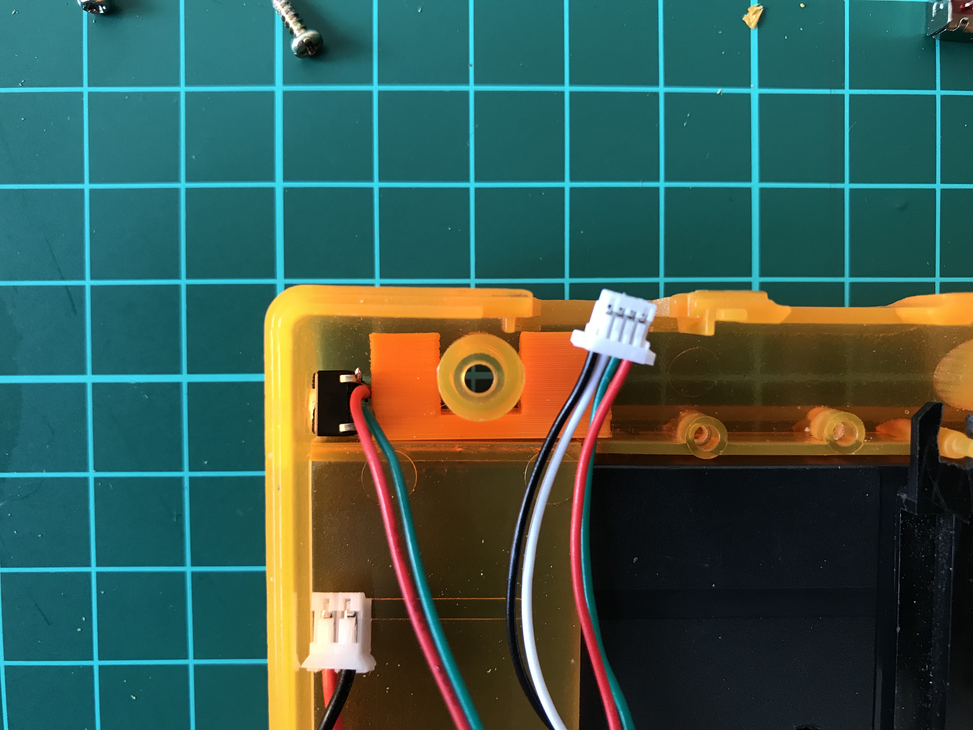

Plug’N’Play HahahaShow
Tight fitShow
You can see that the 3D printed part is sitting really tight in the cable management system. It’s bending a bit but this putted effort actually prevent it form moving and i don’t need glue to hold it :mrgreen: Even removing it was REALLY hard

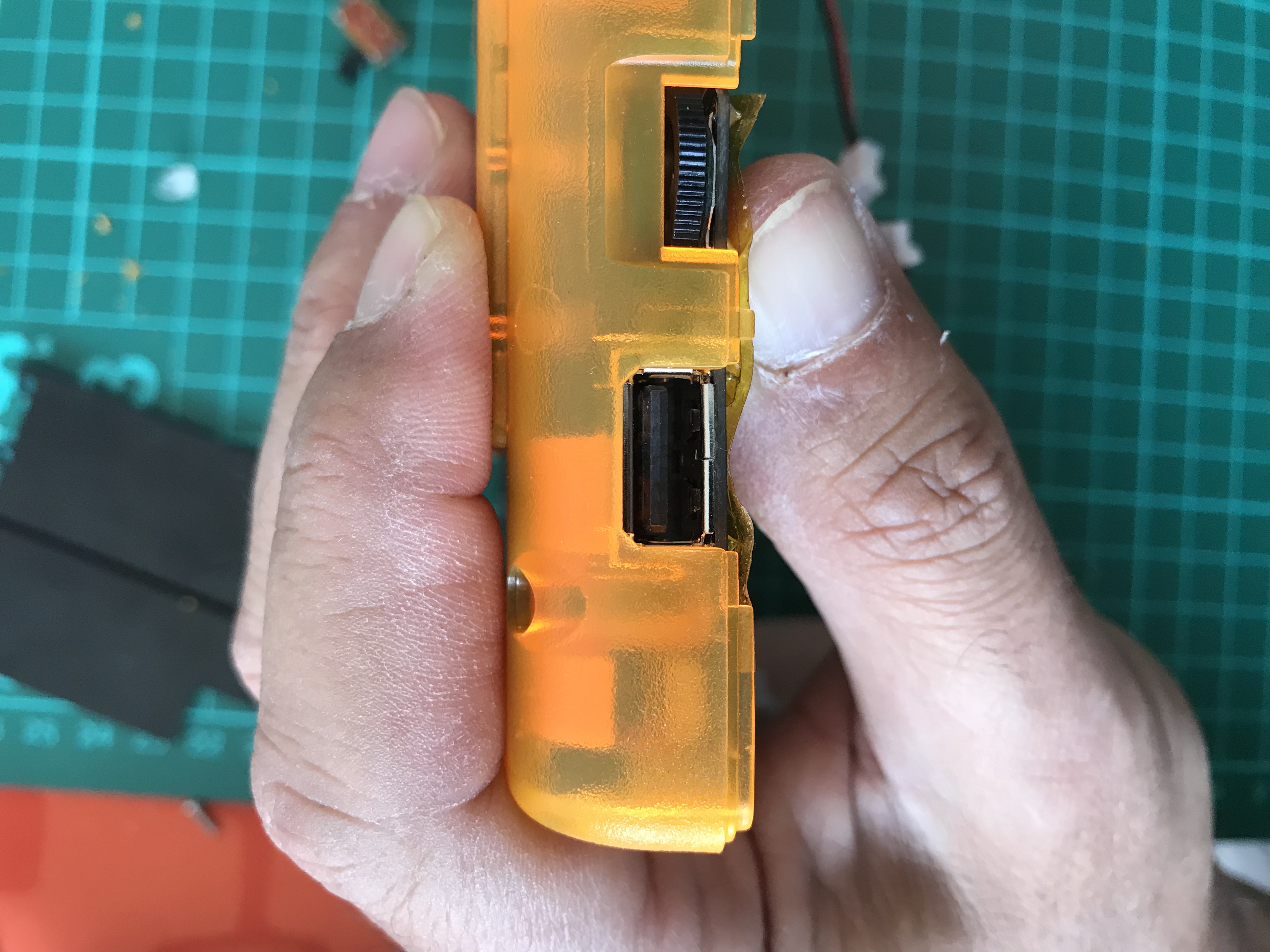

Support for the USB portShow
The mode button support have also the purpose to support the USB port. It’s really fitting like a glove

I’m having difficulties to make contact with the pogo pins. The problem is the tight grinding i’ve made to the battery tray. I cannot push down the battery to make contact with the pogo pins. The problem is that with my design, the pogo pins are staying up to the battery cover but this is the reverse bending way of the pins... i have destroyed 2 connectors by forcing the battery down. As the pins didn’t bent (because they bent pushed the other side) they got flattened :?
I have to flip the pogo pins upside down :( but the connector won’t sit anymore flush (flat plastic against flat plastic) so i may end using some sugru maybe to clay down the conector to the support. Really weird. Stupid me, i didn’t take this in consideration while designing the support. :roll:
