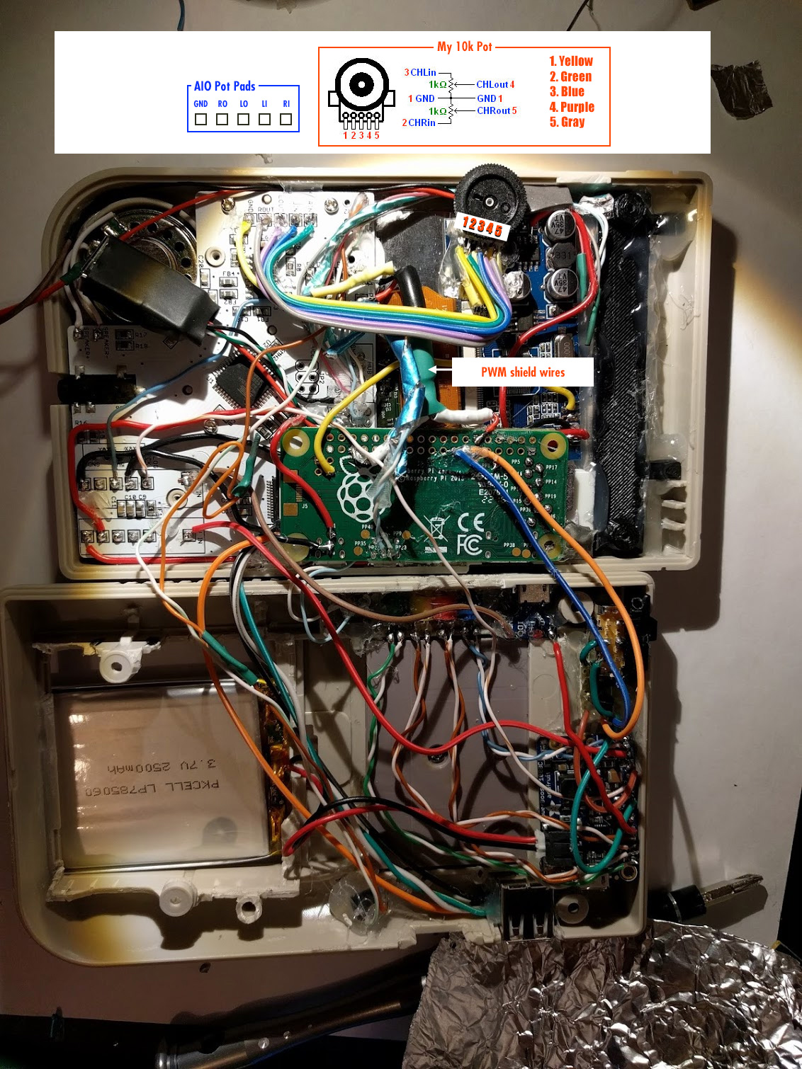

I hate to add to the "I have an Audio Issue" posts but I have two of them.
The best way to describe my first sound issue is like a dead air station on AM/FM radio or old school SDTV. The noise is a constant static on the headphone jack only and unaffected by the potentiometer wheel position. Again, this is not something that comes over the speaker. This sound does not go away when the Pi is powered down and only stops when the Powerboost is switched off. I swapped out the pot and wires to be sure and to rule those out. After replacing the Pot and wires, I noticed the Right Out and Left Out pads on the AIO made an audible "bad ground" sound over my headphones when probed. I've also replaced my PWM wires with thicker shielded wires. I've also don't see any shipping damage around the headphone jack solder points.
The second noise issue is a steady hum that changes frequency slightly when the Pi access LED blinks. It's not loud and no loud spikes in frequency. This can be heard on the speaker but you have to really hold the GBZ to your ear. Hard to say if it can be heard over headphones since there's already static present. I don't think this noise is exclusive to the AIO and I've heard it before on basically every Raspberry Pi I've used for PWM / Analog output. But with the AIO 2.2 boards, I know Helder added filtering so I'm not sure why I'd be hearing any bleed through data noise.
Yes, I have disable_audio_dither=1 in my config.txt:
max_usb_current=1
Here's my GBZ build:
I pointed out a few things in this picture to help be crystal clear about how I wired things. Please note that the wire running to and from the PWM shield did not change anything.
I also think it's important to mention that this isn't my first Pi project where I've heard noise via analog/PWM. I've built a "PiStation" with speakers, built in 5" HDMI screen, headphone jack, potentiometer (same one used here), 10,000 mAh batteries, and a Rasp Pi 3. That project also had noisy audio identical to my second audio issue here but it was solved by shielding the speaker wires and running a ground wire within the shielding, this did not work in this project however.
After searching for about a week on this forum and Google I'm coming here with my tail between my legs. Sorry for yet another Audio question.
Post by Helder » Mon Nov 21, 2016 1:51 pm
What are those read and black wires going off of the picture frame? I see them going under the Pot wheel. Sounds like you're picking up interference from either power or data and your pwm is shielded but the pot wheel connections aren't which carry the audio signal too so you might want to try moving anything power related away from the pot. There is filtering on the board but PWM audio is not that clean to begin with and interference could be from anywhere since you have alot of wires spread over the entire inside of the case.
doomydoomer
Posts: 24
Joined: Wed Sep 07, 2016 7:53 pm
Post by doomydoomer » Mon Nov 21, 2016 2:10 pm
Helder wrote:What are those read and black wires going off of the picture frame? I see them going under the Pot wheel. Sounds like you're picking up interference from either power or data and your pwm is shielded but the pot wheel connections aren't which carry the audio signal too so you might want to try moving anything power related away from the pot. There is filtering on the board but PWM audio is not that clean to begin with and interference could be from anywhere since you have alot of wires spread over the entire inside of the case.
The red and black wires are coming off the LCD tact switch JFT connector, which sits beneath the pot and runs down the inside left half of the case (right outer side when viewing the GBZ from the outside). My Pot wires were shielded before I rewired them and this static is only coming over the headphone jack so I don't see how it can be the pot/wires but I will shield them again. It also didn't seem to matter where I put any of these wires and I know things look like a mess at the moment but this is because I've pulled and rewired things to try and resolve this issue. It's one of those things I didn't immediately notice until I tried to use the headphone jack which was a few days after I was finished my build. One thing I forgot to mention when describing this headphone jack static is the volume level over the headphone jack is insanely loud and it goes from low to insanely loud with just a slight change in pot position. It's literally like 1 to 11 in one slight turn. What about the "bad ground" noise when probing the R out and L out pads, is that normal behavior? Thanks again for taking the time.
