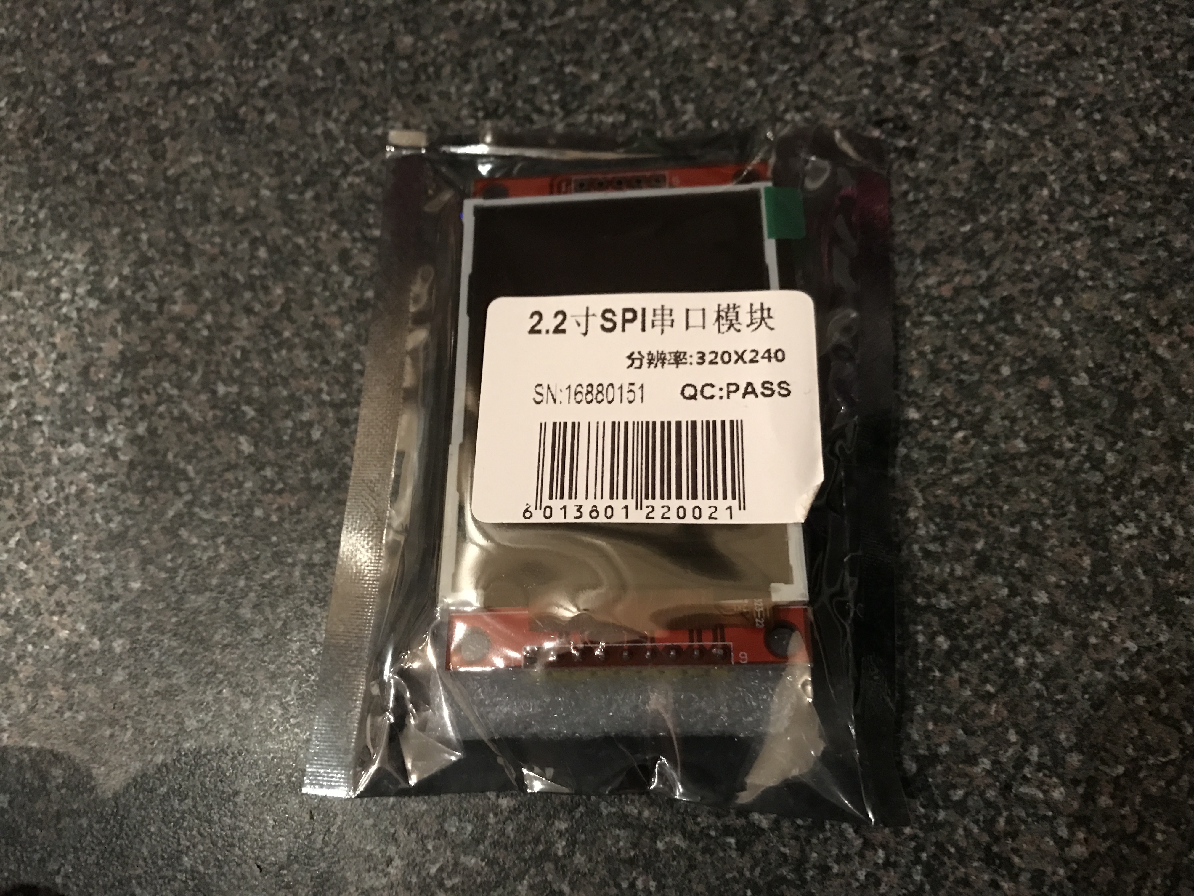

I bought this 6 months maybe more back when I first watched the GBzero video. Been sitting in an envelope, hasn't been opened.
Same one?
Also separately.... I found an ebay seller in HK
Same item?
https://www.ebay.co.uk/itm/262470089558
Same one?
Same item?

Yes that is the correct screen.
