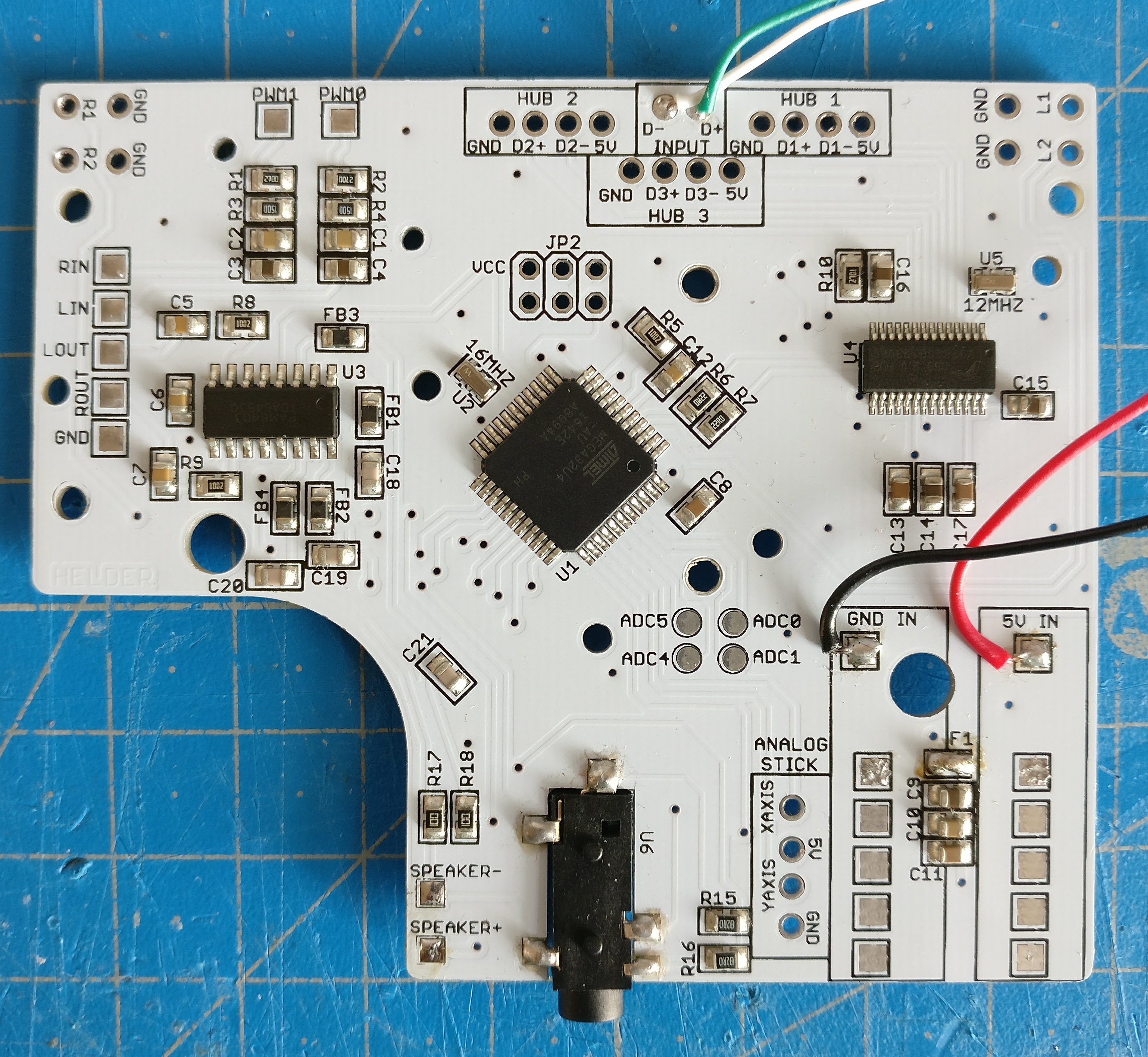

After bridging the fuse pads, the 5V and GND side do have a connection (checked with multimeter). I did not power the board because of this shortage.
Do you have any suggestions what components to check (and maybe remove) first? There must be at least one more blown part on the board that is causing this bypass.
Post by Helder » Tue May 30, 2017 4:01 am
Can you show me a picture of the fuse bridge and a picture of the board. There must be a short somewhere, could be a bad part or a solder splash when you wired things to the board.

Post by RobbsyB » Wed May 31, 2017 11:32 am
This is the board with fuse bridged (tested with multimeter):
Post by Helder » Wed May 31, 2017 12:54 pm
So if you check for continuity between the 5v In and GND In there's continuity?
