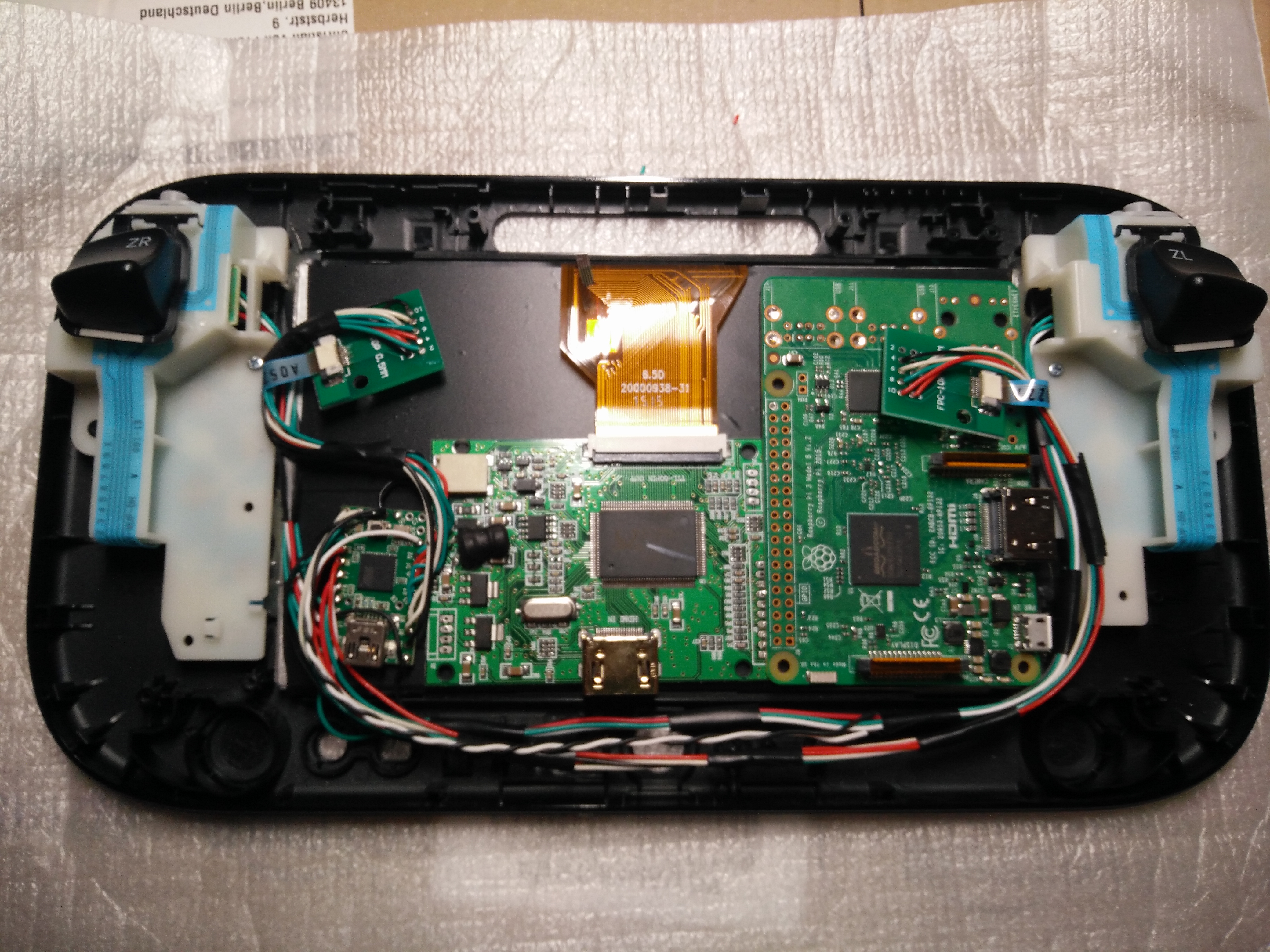

Did you de-solder that Pi3 yourself?
It looks very clean in that image, well-done mate.
cvp
Posts: 20
Joined: Wed Aug 31, 2016 12:11 pm
Post by cvp » Thu Jun 08, 2017 7:02 am

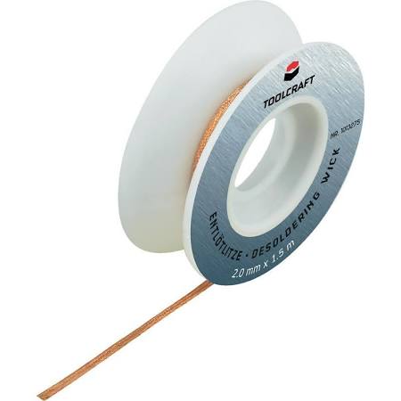

gilbertotron wrote:
Thu Jun 08, 2017 2:33 am
Yes, I did it myself. With the help of Desoldering Wick (In German we call "Entlötlitze"). Of course, you do not suck 100% everything up. But it has helped a lot. After that I cleaned it with isopropanol.
