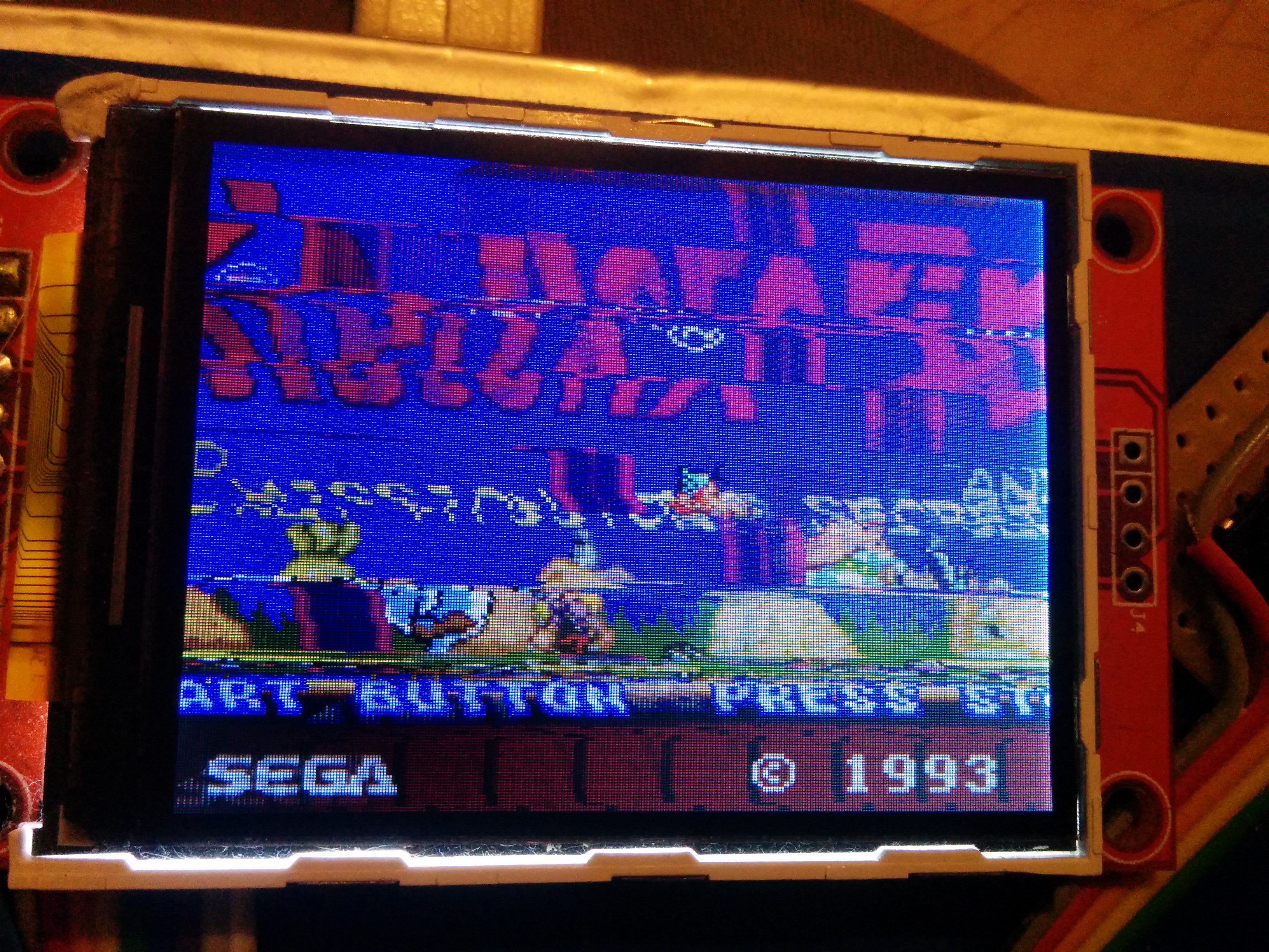

So I got the old test rig out to test the overclock impact on screen speed. Used the overclock settings I found here
https://github.com/RetroPie/RetroPie-Se ... erclocking
So we've up adding this to the config
arm_freq=1000
gpu_freq=500
core_freq=500
sdram_freq=500
sdram_schmoo=0x02000020
over_voltage=2
sdram_over_voltage=2
And things broke
Dropped the speed back down to 80000000 and the screen worked again, but the debug messages were flicking round 33fps still! 😞
It's weird though, even when it's too fast for the screen to cope, it still doesn't get over 33fps

Human eyes are working at 24FPS. Pal systems are using 25, NTSC is using 30FPS.
The original megadrive and snes were designed for those system. I’m not sure they were natively running more than 30...
So is it really an issue to have a flat 33 if it is stable and continuous ?

@veterangamer I was actually testing this on a 2.2 screen. I would assume they would all be the same, the only difference between the screens should just be the size of each pixel
@yaya my main drive to go faster was bragging rights, but also I thought if we could get the speed up, it might help reduce the tearing that you get on full screen changes. I agree that 30 plus is more than ample! 😀
Re: 3.2" SPI LCD (working and ready for a build)
Post by YaYa » Wed Oct 18, 2017 12:32 am
The tearing is more a synchronization issue than a FPS issue.
To avoid tearing, the output of the screen must be well synchronized to the buffer’s output...
In short, i think i would be better to force, lets say, display at 30fps flat rate and prevent bumping lower and prevent bumping higher.
